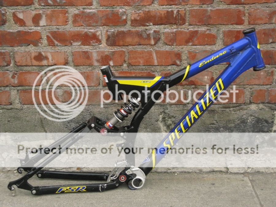

    1998 SPECIALIZED FSR LTD. FULL SUSPENSION MOUNTAIN BIKE FRAME - LARGE

    I was considering building this, but I have decided that the project would be beyond my scope. I figured I should share it with someone who might do something good.

    Would be a good place to start. Throw a Risse Racing complete rear triangle on there and go ride.

    I'd be happy to have it as it is a Large (and I unknowingly bought a Small), plus it's the MAX Backbone and I have the standard-issue frame. But, I figure it'd make more sense to buy a better/newer model bike than the one I have and just sell my old bike complete.
    Best of luck to whoever grabs it. It looks sweet to me.

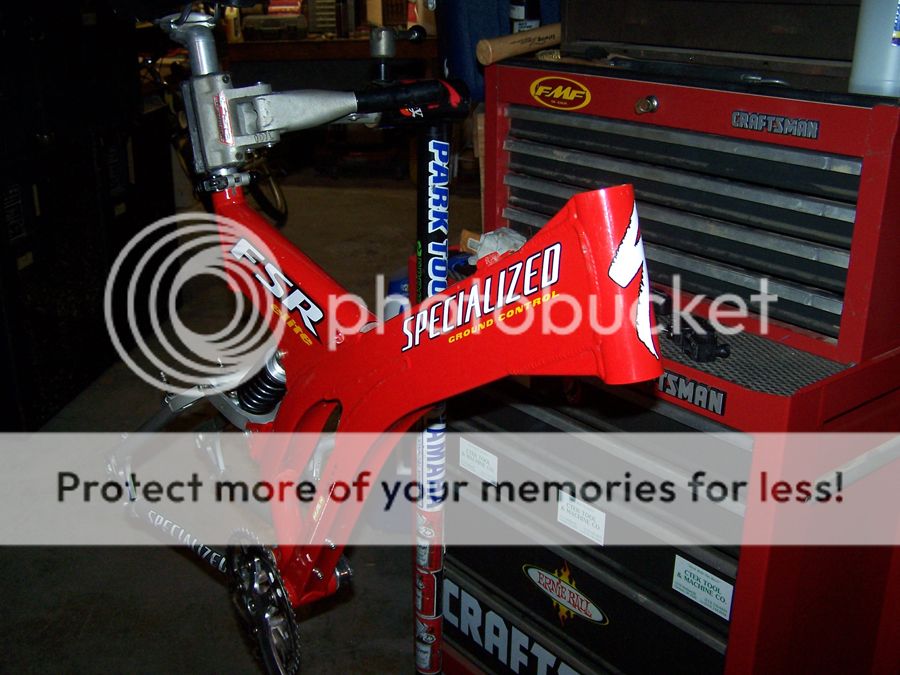

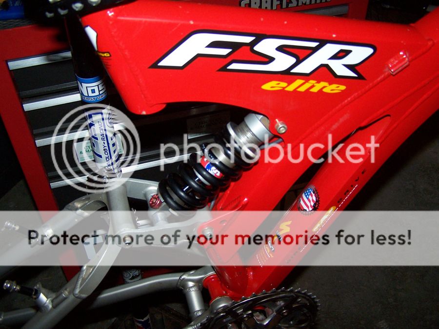

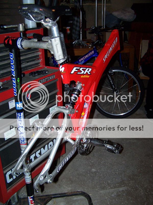

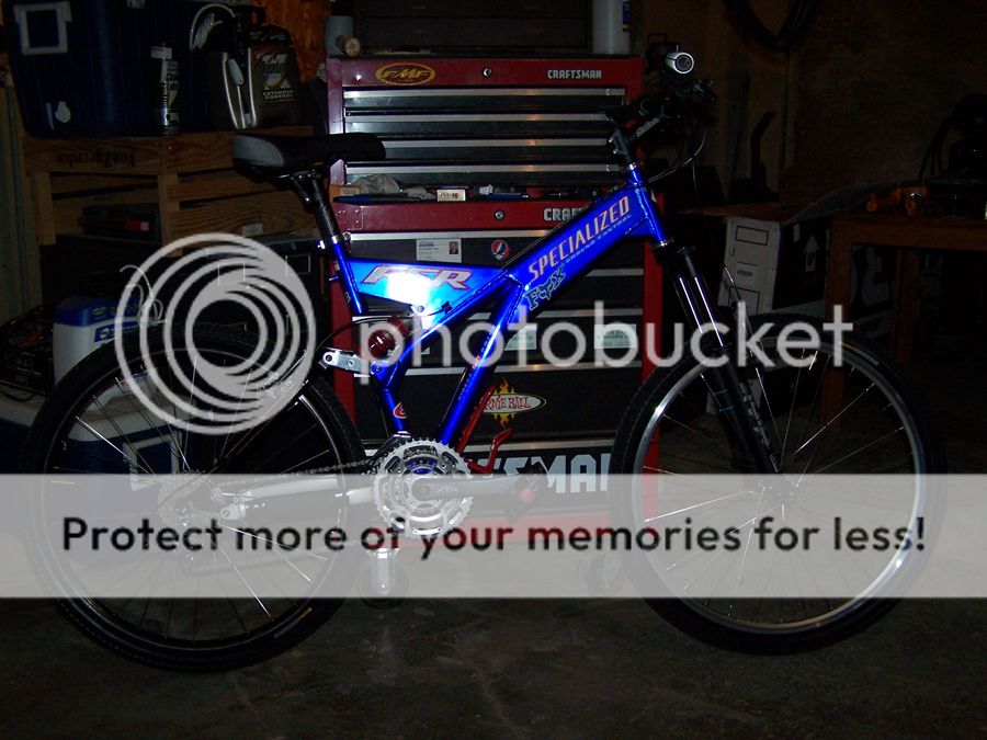

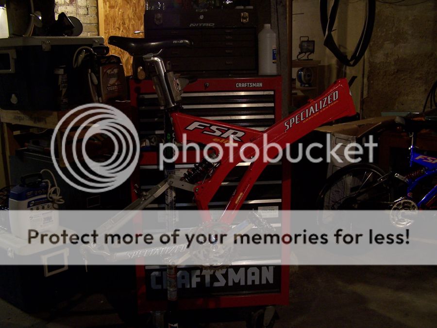

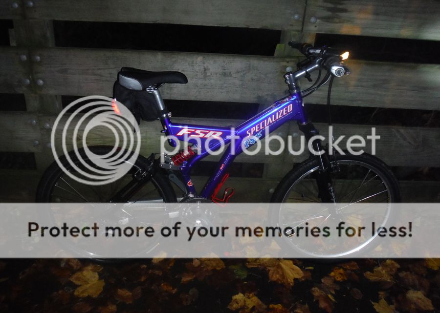

    I built these two bikes up last year and finally got around to posting. The green one is mostly stock with an old 20mm Marzocchi Z1, Avid BB7 brakes, Blackspire Chain Guide, XT front, XT Rapid Rise read and Truvativ Dual Ring Cranks. The red one has full Mountain Speed bearings and linkage, Avid Hydraulics, XT front, XT Rapid Rise rear, Saint Shifters, Blackspire Chain Guide, Raceface DH Cranks, Azonic Outlaws and a Marzocchi 66. The green bike is mostly ridded cross country by my brother and the red is used by me for downhill shuttle trips when I don't feel like I need my long travel Commencal Supreme.
    Specialized FSR MAX backbone-img00076-20111029-1222.jpgSpecialized FSR MAX backbone-img00077-20111029-1223.jpgSpecialized FSR MAX backbone-img00078-20111029-1223.jpgSpecialized FSR MAX backbone-img00079-20111029-1224.jpgSpecialized FSR MAX backbone-img00080-20111029-1225.jpgSpecialized FSR MAX backbone-img00081-20111029-1225.jpgSpecialized FSR MAX backbone-img00082-20111029-1226.jpgSpecialized FSR MAX backbone-img00083-20111029-1226.jpg

    Nice looking rigs there Z. Do you know how much travel you're getting on the Red rig?

    I get about 6 inches travel front and rear. The bike is pretty heavy, but a lot of that has to do with the 66 and Outlaw wheels.

    Same here, I'm running a Risse Racing rear triangle, shock, Hex link, seat stays, chain stays, a Fox Float 36 up front. I love the way this rig rides. I still get looks from folks riding new equipment, but the FSR keeps on ticking.
    What's the bottom bracket measure?

    Here's my 1998 FSR Ground Control I bought new in 98', (just like a few others on here I really wanted the
    FSR elite Max Backbone but I couldn't afford it at the time) and slowly upgraded to full XTR over the
    next 4-6 ? years. Just got her back out a few months ago after a long time of not riding. I threw some
    street tires on there and have been riding the bike paths around here to get back into the swing of riding.
    I picked up a bone stock 1998 FSR elite Max, size large (finally) a few weeks ago and stripped it down to the frame (the crank
    is also off there now) to build up over this winter. Excuse the messy garage.
    I also have a frame like this one (2001 FSR Enduro),
    I can't decide if I want to steal the seatstays off this for rear disc on the Max, or just use an XTR V brake on the rear of the Max.
    I plan to build this frame (enduro) up also with all the spare parts I have including a complete 1999 FSR Ground Control Sport.
    The build list for the Max Elite build so far:
    2001 FSR ENDURO seatstay and linkage (cartridge bearings), BETD main pivot (needle bearing)
    Shock- FOX Vanilla R 6.75" i2i x 1.75" stroke (900lb x 1.83" stroke spring)
    Fork- ROCKSHOX Sektor RL 150mm dual position coil(converted to 110-150mm U-Turn coil, extra firm spring)
    Front Mech- SHIMANO SLX M665 (2 x 9)
    Crankset- SHIMANO SLX 170mm 22-36t (mountain double)
    Cassette- SRAM 11-34t 9 speed
    Rear Mech- SRAM X.7 9 speed Medium Cage
    Shifters- SRAM X.0 9-Speed Twist Shifters
    Headset- CANE CREEK forty
    Handlebars- AZONIC Flow
    Stem- AZONIC PleasureDome
    Seatclamp- HOPE
    Seatpost- TITEC Scoper or RITCHEY Comp
    Wheelset- AZONIC Outlaw
    Bakes- AVID BB7 (180mm front, 160mm rear)
    I love these Ground Control and Max frames, and look forward to building it!
    Anyway, thanks for all the info in this thread, I will most likely be asking for more help as this build slowly progresses.

    Hi
    We are still rocking old-school Spec frames
    Here is mine:
    Zdjęcia - Pokazywarka.pl
    I built it albost 3 years but for now this bike is flying over! : )
    Setup:
    - fork Z1 FR SL `03
    - shock Cane Creek AD 10
    - brakes Formula The One
    - wheels Fulcrum Redmetal 5
    - Crank XT
    - etc. etc.
  57. #357
