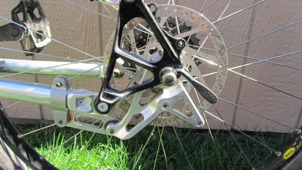

    I know it's not retro or classic but it is vintage for a Schwinn fully. Picked this up today along with a bunch of other bike parts and have left inquiries at other forums here but no luck so far, I'm impatient I know. Heres the deal, there is a bolt on brake adapter which moves the caliper to the bottom of the chainstay, probably for brake jack issues and is sealed bearing/CNC machined made to fit the stay perfectly with a couple of added parts to compensate for the added intrusion to the wheel bearing area but there is an original normal brake bolt on feature existing. Any info on this part? Also has EDCO rear hub and a HB....? front hub. Any ideas about the HB front? Rock Shox Psylo Race fork, M950 no logo crankset and Grimeca brake rotors. Another feature is the shifters, they have Shimano on them but like nothing I've ever seen. I'll add the pics of those if anyone wants to see them. I bought this to give to a friend after I build it but I really don't want to let it go if it's something special as I have many oldies/goodies that don't have the qualities this has. And NO, it's not for sale.

    judging by the picture, it appears that you don't even need the bolt on mount- the black piece appears to be factory and has disc tabs. Why not try it as intended and work from there?

    HB = Hayes Brakes, at least that's an acronym I see on the current crop of cheapo mechanicals, so it's a fair guess?

    You might have better luck searching for it as a 4 Banger, as implied on the carbon swing arm.
    The small brake linkage with the hole came off a Yeti DH8 / Schwinn Straight 8. The rest I don't know.

    If you google there is an old thread about the brake mount, apparently was used on team 4 bangers ~ 2000. Any clue why bike has a 4 banger rear end on a 2001 straight 6 front triangle?

    Because they tended to break. And, they were interchangable.

    Thanks all. Now we're getting some traction on this Frankenstein. Hayes sounds about right for the crude machining on the hub MendonCycleSmith. Seems the bike was put together with a bunch of parts that were laying around or by some team for a lower class rider who got the leftovers. Hard to see but the right dropout is unpainted so leads me to believe they broke often as muddybuddy states. In any event, the bike is solid without dents, dings or cracks so my friend wins. Not bad for a $50 almost complete bike that will be loved by the new owner. I'll post pics when complete....

    The black dropout is the late-spec magnesium one with IS mounts. Early ones are 22mm Hayes mount.
    Yep, 4 and 6 have interchangable rear ends.
    To restore the carbon you will have to gently sand it down with, say, 1200 grit and then use a UV resistant lacquer. Be very careful if you are removing the bearings as the swingarm needs supporting whilst doing this or you could damage the swingarm.

    Oh yeah, the dropouts don't tend to break it was the welds/pinch bolt swingarm clamps that used to break on the early versions.
    IIRC that is an Brake Therapy aftermarket floating brake kit and very nice too! It helps prevent brake jack at the rear which isn't actually as bad as some make out.
    The Straight-8 / Yeti Lawwills had a similar setup.
    BTW the 4-banger is the closest to Mert's original design as it can get (Mert's own words!) with the others being bas*ardised versions imposed by Schwinn/Yeti..........not that I'd call the Yeti versions anything but beautiful!
