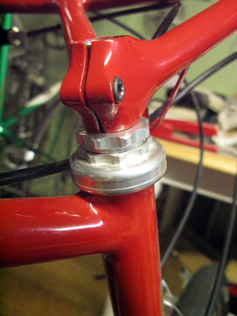

    Ritchey bull moose bar stem clamp issue
    Gentle Riders of the Ritchey persuasion, I have questions.
    About the bull moose bars and attachment to the fork stem. On my 81 Ritchey, the bull moose bars and stem were one. It was tightened the same way as other quill-type stems. On the 84 SC, it is a clamp that is part of the bar and tightened with a rather small hex-headed bolt.
    Photos of the 84 bar-stem clamp:
    I got dumped, most unceremoniously, while mashing up a hill and the bars simply slipped around. I have 3 broken ribs and an AC-shoulder separation from that moment. Moreover, Id made a point to tighten that bolt before the ride, as Id been eyeing it as a potential problem point.
    Ill also point out that a proper adjustment of the headset requires you to remove the bars. The specialized wrenches for this headset cannot get past the broad base of the bars. I find that annoying, as well.
    How long did Ritchey build the bull moose bars like this? As noted, it wasnt this way on my 81, but I dont have personal experience with too many other specimens. My only other Ritchey is an 80 road bike.
    Is there a trick to getting this tight enough to not slip? Seems a weak design for an off-road bike, no? Does one sand the stem to a rough state (and risk it being permanent)?
    The bike, btw, emerged from the crash with nary a mark. I think I instinctively held it aloft while I slide in the gravel.

    Let me be the 1st to offer my quill bullmoose as a trade....
    Sorry about the injury, sanding sounds like a good idea...

    Not trying to talk you out of the sweet deal I just offered you, but standard wrenches fit that headset as well...

    Quote Originally Posted by LeicaLad View Post
    Hi 0wen-
    I don't have answers to your questions but wish you a speedy recovery. Crashing due to vintage bike failure weighs more and more heavily on my mind as time goes by...
    -Brian

    Mostly I worry about crashing due to vintage rider failure.
    This came as a complete surprise!
    But it is the design question that keeps nagging at me. This approach cannot have lasted long. . . did it?
    The bars that clamped onto the brazed-in "nub" (like you have) came on the early bikes ('81 and earlier) and on some of the higher-end bikes through 1983. It's a slightly lighter set-up since there is no quill.
    I've not had any issues with my bars slipping after tightening the bolt to a "reasonable" tightness (same force that I'd apply to any standard bolt on a stem). You may want to check to see if the threads are stripped not allowing you to tighten the bolt. Or perhaps the brazed-in nub is damaged or slightly under-sized.
    I don't do crazy rides on the old bikes, but I've ridden them off-road and raced them a couple of times at Keyesville with no issue.
    That headset design is newer than the bike, so blame the wrenches not fitting on Shimano not on Ritchey. Also as Z-Man said, standard 1-inch wrenches work just fine.

    I thought my '81 was different, but among my very few photos of it I can see that it was similar. I never had a problem. This occurred waaaay too easily, so something is clearly amiss.
    I also fear discovering it an unobtanium thread and head size. The seat post bolt on my '80 road Ritchey is also totally unobtanium. I treat it very, very, very carefully. I was unsuspecting on this one -- or insufficiently suspecting, to be more precise.
    Oh, and I was actually on pavement when this occurred. Even less reason for it to have turned loose, not to mention a harder surface to be slammed onto.
    I am one sore dude, and very annoyed.
    Ah, well. Battle scars.
