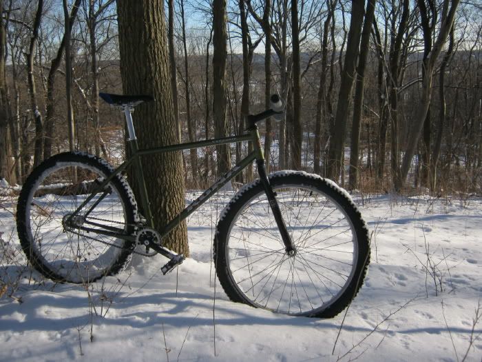

    Did some work on the bike this weekend
    FSA low rise bar with 90mm stem. These items are about 12 years newer than the bike but think they look good with the black wheels and seatpost.
    Old Bomber Z1's. I striped their paint a while ago with the intention of polishing them but never got round to it. I guess now I have a reason to get it done. The 100mm travel does lift the front a bit but I run around 30mm sag so think its okay. May look at dropping them to around 80mm when i next open them up. I dont think it will be too hard.
    I had planned to remove the brake booster but couldn't get the brakes to stop squealing without it.
    A little trick I read about somewhere on the internet for fitting V brakes to old Kona's. Rotate the cable guide 90 degrees and replace the bolt with a old derailleur barrel adjuster.
    XTR M900 Rear Derailleur. Still good after all these years. I threw in a little bling aswell.
    XT Front Derailleur. The rust cleaned off nicely:
    Bontrager front wheel with Radially laced spokes:
    Bontrager rear wheel:
    And here are some pictures of the Kona in its natural habitat. What a bike!!! I absolutely loved riding it!!!

    Dec 2010
    41
    Okay so I have ridden this bike quite a bit now and absolutely love it. I have made a few component upgrades that some purists wont like as the parts are not period correct but this is how I like it.
    Here we see the Kona in its natural habitat:
    Fork upgraded to a 2008 RS Reba with 85mm travel and custom gold decals. Thinking of moving changing this back to 100mm and using a 70mm stem:
    Aerozine BB:
    2008 LX Crankset:
    A Bit of bling in the cockpit area:
    Overall view of bike:
