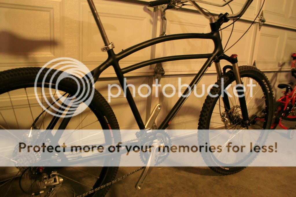

    How far can you take a pre-war frame?
    Lets find out. I have been practicing brazing so this should be fun.
    Here are my plans:
    1. Sandblast off all that rust.
    2. drop some hot brass in around the joints to smooth them out.
    3. Flatten and trim the drop stand tab, drill and tap a derailler hanger.
    4. Cold set the rear to 135mm spacing, re-align the dropouts.
    5. Braze on cable guides/stops for brakes and deraillers.
    6. Braze on a disk brake adaptor on the rear.
    7. Ream and face the headtube.
    8. Powder coat.

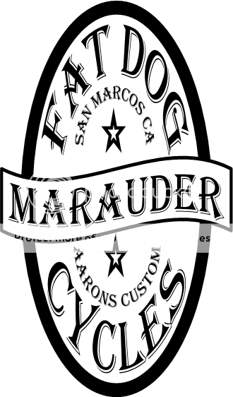

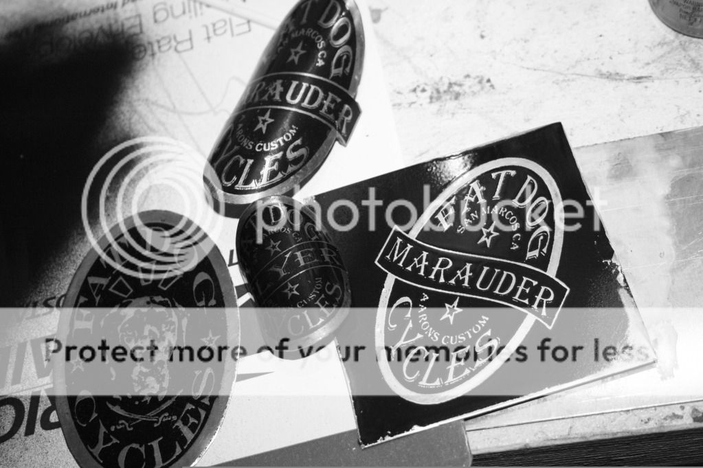

    9. Custom Brass headtube badge.

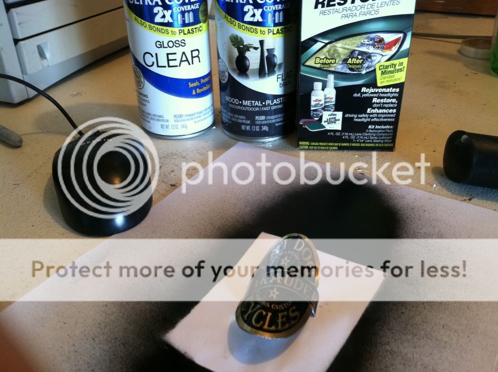

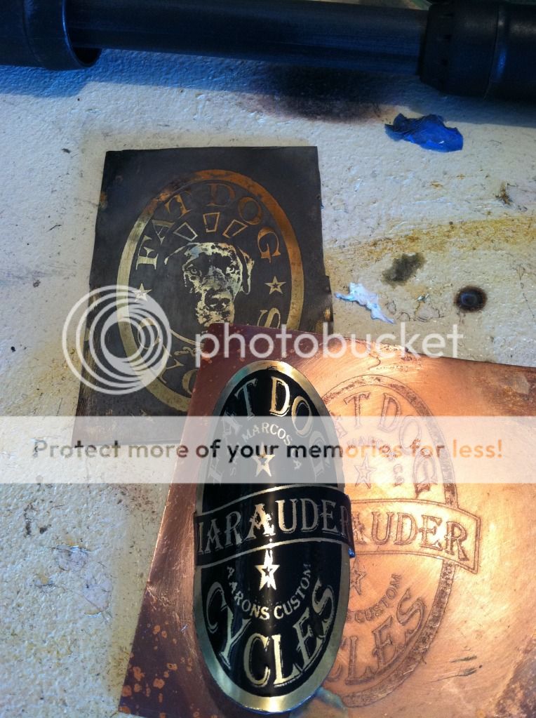

    ong
    Btw, a few years back I did a pretty cute head tube badge for the girlfriend's resto-modern Ron Kitching: http://www.flickr.com/photos/hollumn...7607886141419/
    This was just done in mild steel, with 56% silver, then primed and painted.

    sandmangts
    Originally Posted by ong View Post
    Btw, a few years back I did a pretty cute head tube badge for the girlfriend's resto-modern Ron Kitching: Jeff Makes Ron a Headtube Badge - a set on Flickr

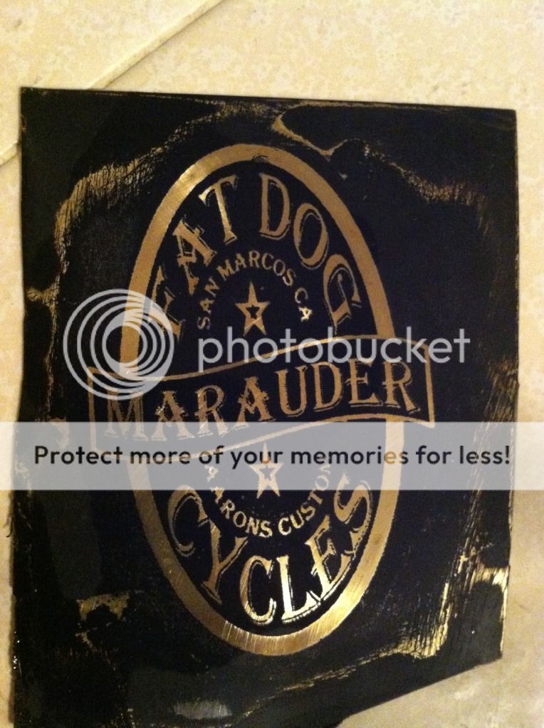

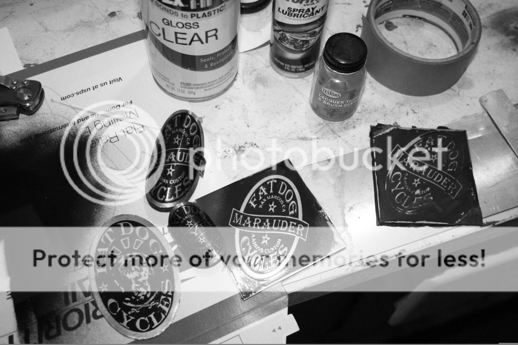

    That came out nice. I like the 3d look. I did copper on my last one but this time I want to do one in brass.

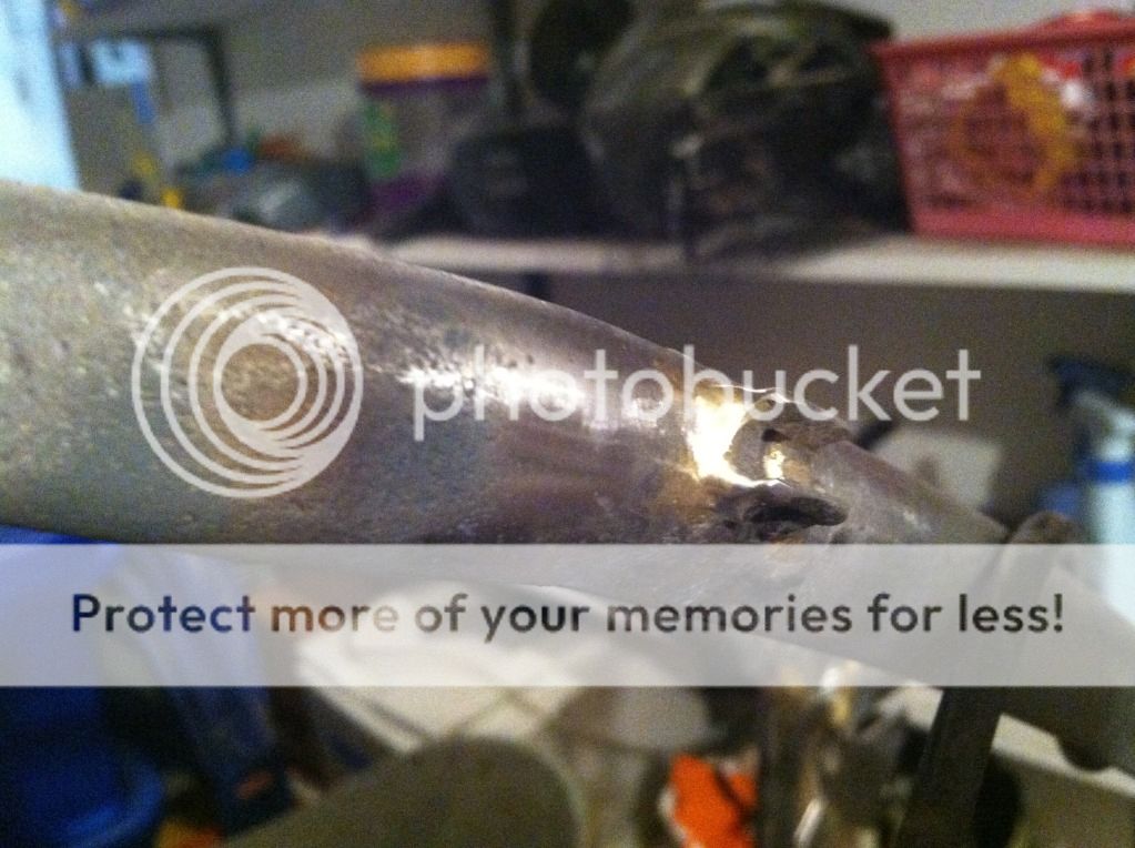

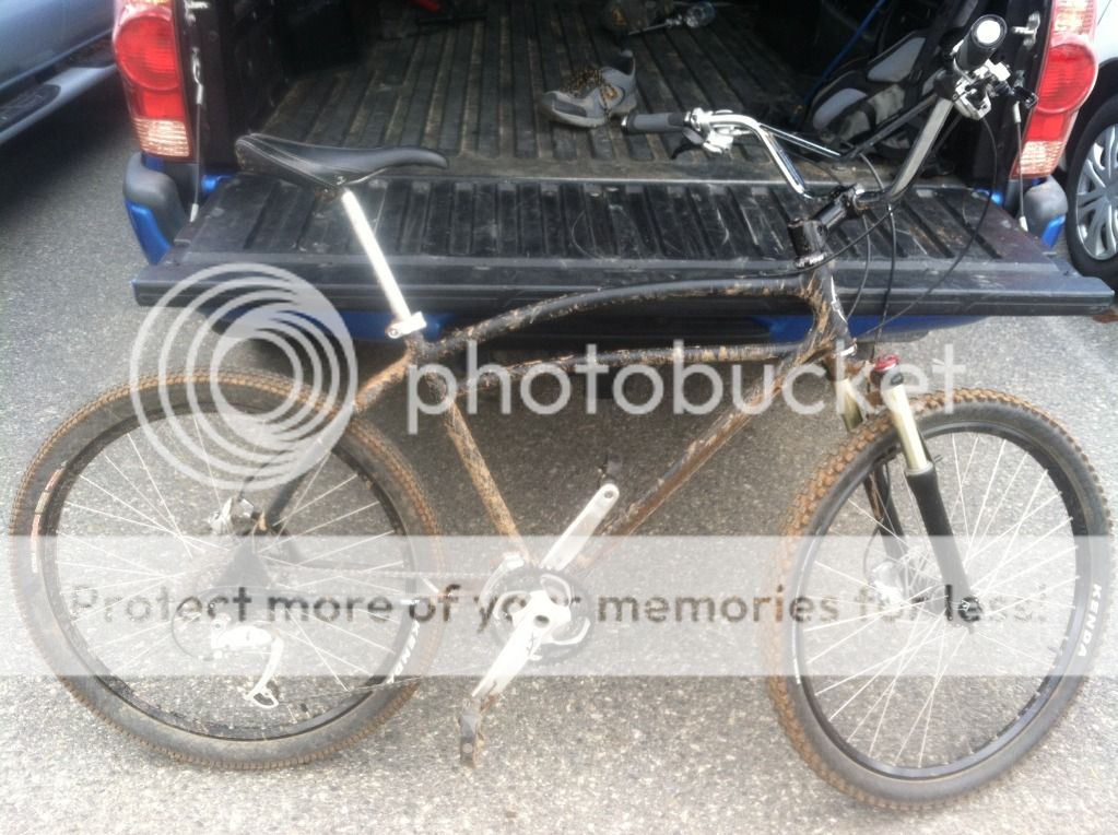

    I got it back from the sandblast. It lost about 120 grams of rust but I suspect most of that was muck built up in the BB shell. It has some pitting that I have filled in with hot brass. I cut out the old fender mount/brace between the chainstays and cold set the frame which was much easier without the brace. I re-aligned the dropouts and then cut a piece of steel tube to fashion a new brace. I am going to use the same steel tube to fashion braces for the dropouts to stiffen up the rear for disk brakes.
    This is my first time brazing. I did some practice runs on some steel scrap. I brazed 2 pieces together and it seems the key to a good weld is getting the metal hot enough to keep the molten brass flowing. Otherwise you end up with globs and a weak bond. It is also key to prep the surface by roughing it up so the brass can flow in and bond. I brazed the 2 pieces together and after cooling I put it in a vise and beat the sh!t out of it with a hammer to see how strong it was. To my suprise it was very strong and took alot of pounding to break so i am confident the disk brake mount will hold up assuming I can get it mounted properly.

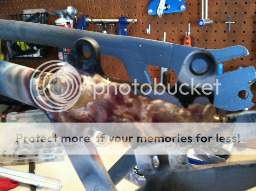

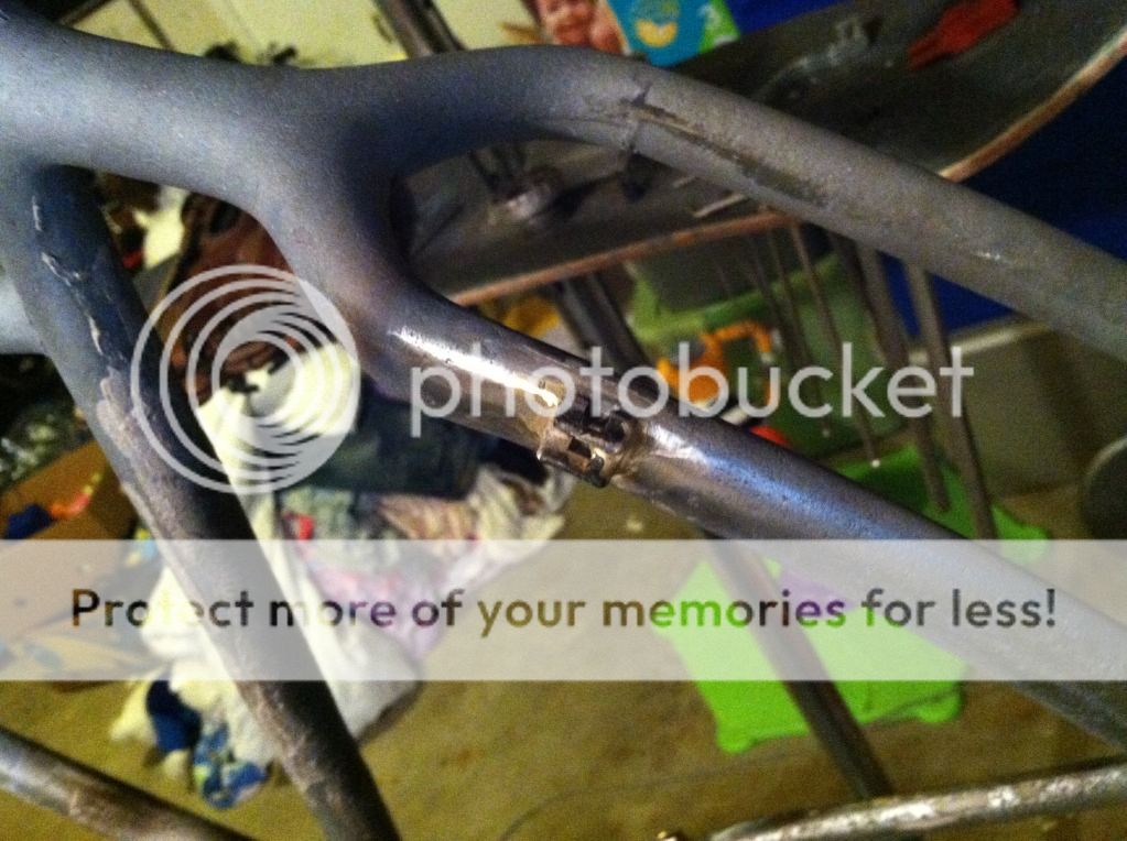

  • 10-26-2012
    sandmangts
    My first time brazing. Still alot of file work left but I managed to do it without overheating and warping the frame. Its not pretty but I think it will smooth out ok. Once it is powder coated or painted it should look fine.
  • 10-26-2012
    sansarret
    The paint actually usually highlights the dips and uneven spots (especially undercuts), so try to get it as good as you can before you paint it. I filed some joints before which I tought were perfect, but they didn't look so perfect after the paint. Looks great for your first time brazing, Cheers.

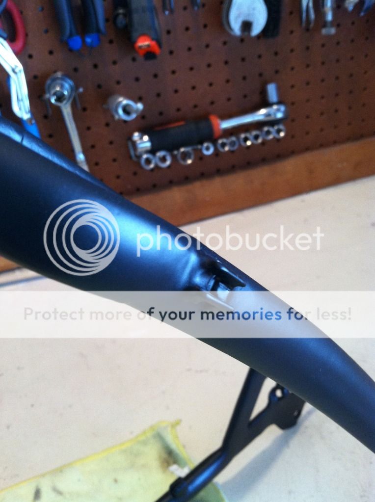

    I got the derailler hanger tapped and I have fashioned some gussets to reinforce the rear end. After I get the disk tab mitered I will see if everything will fit and if so I will start brazing.
  • 11-11-2012
    sandmangts
    I brazed in some braces for the rear end. I used the same tube that I used for the chainstay brace, heated it, hammered it flat and mitered it to fit the shape of the rear triangle by hand. Lots of file work. I brazed it in and then hit it with the angle grinder to get it shaped right. I had to coat it with primer because my garage is so damp that everything flash rusts practically overnight. Next step is the disk brake mount. Not bad for a guy that learned to weld watching YouTube. I also tapped and shaped the drop stand tabs into a derailler hanger and trimmed the non drive side dropout.

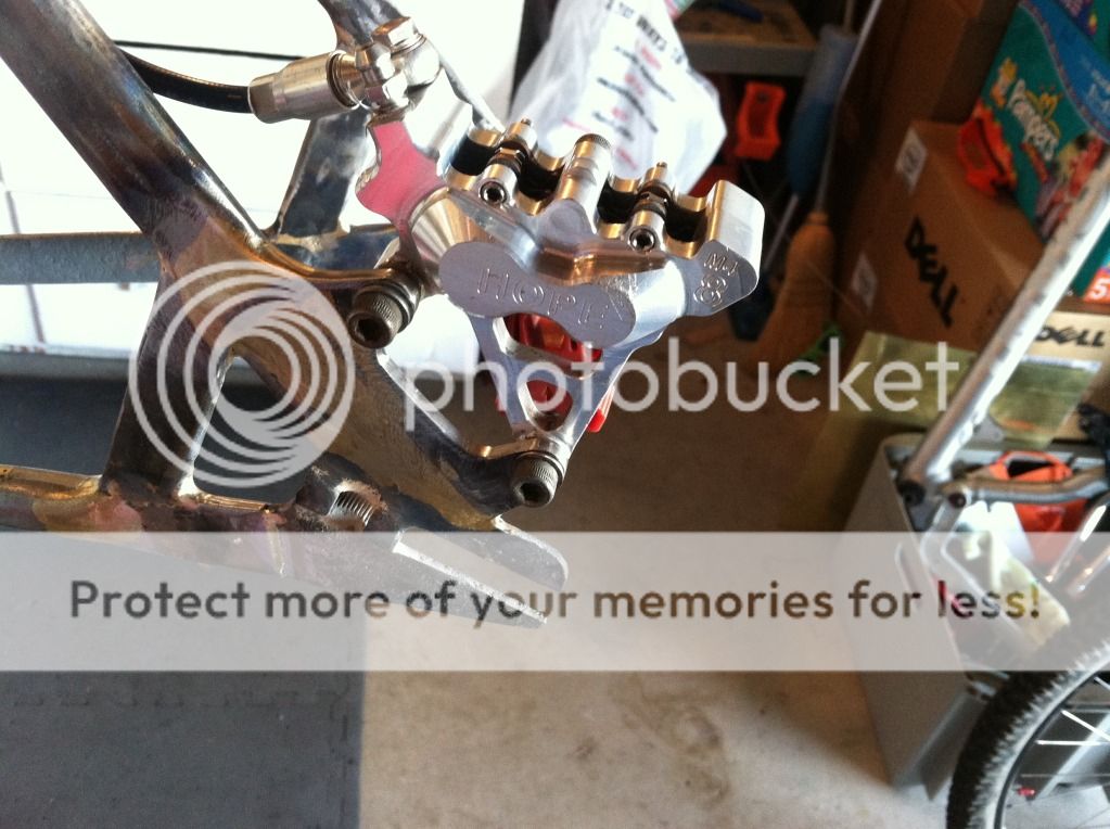

    I ordered a steel disk brake mount from Pacenti. It is made from 1/4 inch mild steel and I plan to use a 160mm disk wheel and an avid bb7 as a jig to get the alignment right. If I can't get disk brakes to work I will just braze on some canti mounts but I have seen other pre-war frames with disks so I am determined to make it work. It is probably a really stupid idea and completely impractical but it will be so awesome if I can pull it off. I may even do the paint myself.

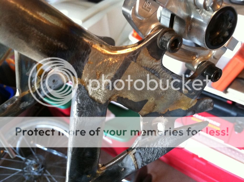

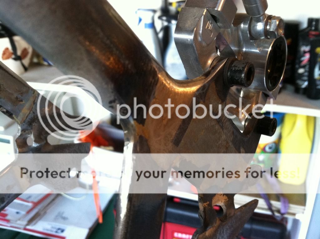

    I got the disk tab in today and tried it on for size. Untrimmed like this was a no-go. I would never be able to get the wheel on an off without messing with the brake.
    So I trimmed it a bit, still rough but after some grinding and filing it should fit flush to the top of the seat stay. Then I will strip that primer back off, sand it with 80 grit so the brass can get a grip and then I will lay a fat bead in there. This way I can take the wheel off without any fuss.

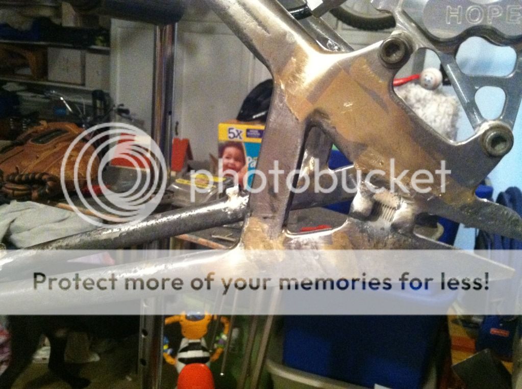

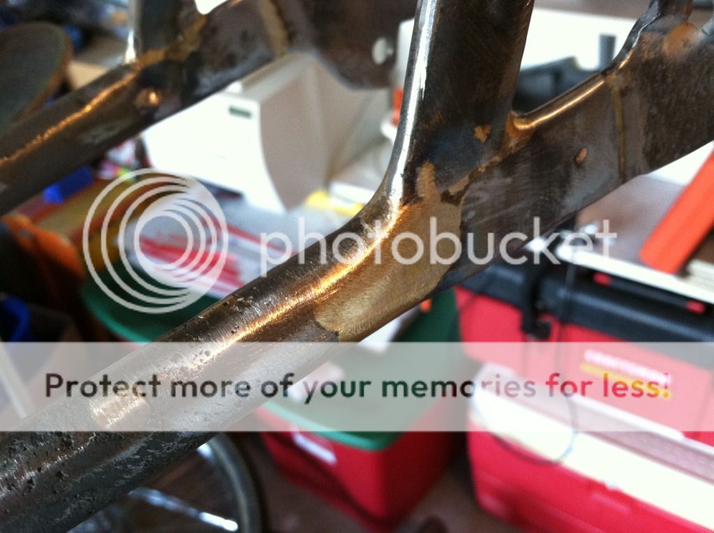

    I was brazing like crazy today. Clearly I still have alot to learn but i managed to get a nice heavy strong braze. The key is keeping the surrounding metal red hot so the brass flows. Getting the mount tacked into position was a *****. I used my disk wheel and clamped the brake in place on the rotor to serve as a jig. It worked and I got lucky. The brake lines up just fine. Still lots of file work and sanding to do but it feels super solid.
  • 11-21-2012
    Boy named SSue
    Looks really cool. I'm always excited to see updates to this thread.
    I would have been tempted to smooth all of the junctions between the dropouts and stays.
  • 11-21-2012
    sandmangts
    I actually did that on the other side but I ran out of oxygen. I still need to braze a bit more on the back side of the disk mount because I have some pits from running out of oxygen.

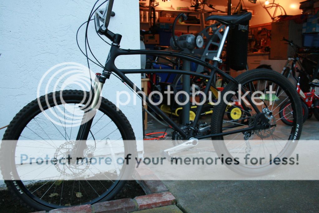

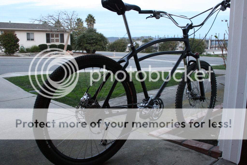

    This week I scored a Giant AC1 with a cracked frame super cheap. Along with some newer XT bits, Race Face cranks and a Manitou Sherman fork it had these lovely Hope M4's. Overkill? Yes. But they sure are pretty.
  • 12-02-2012
    Bikemaya
    Not overkill AT ALL. This project deserves all the bling more than any of those fancy shmancy frames :D
    You, sir, are doing this frame a great justice.
    :thumbsup:

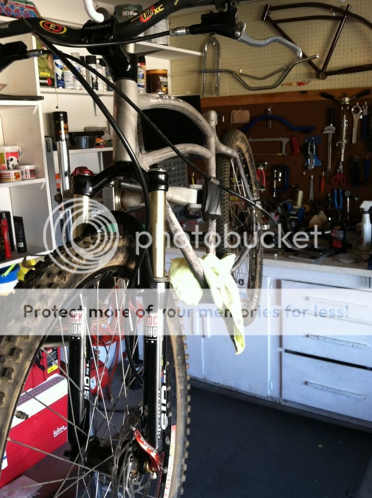

    Yeah his setup kinda gave me the idea. Notice how many washers and spacers he had to use for a 160mm disk though. He should try a 140 and pull those spacers out to stiffen it up. His setup must be a pain to align properly but it sure looks smooth.
  • 12-09-2012
    sandmangts
    I got it mocked up today so I could work out the cable routing. Only then did I realize the brakes were set up as lefty rear and righty front. Needless to say this won't work for me so I will be swapping the levers and re-bleeding which kinda sucks because I have to by a bleed kit. I have a lovely Sid fork provided by ccmcdoc via our trade thread and I couldn't be happier. It works flawlessly and looks almost new. Since the fork is black I am thinking of going with a matte black finish which will go with the hubs, fork and parts and it should give the bike a road warrior kind of look. I have some custom decals and a headbadge in mind as well. A cross country fork with downhill brakes on an antique frame. I think we have truly entered the land of ridiculousness.

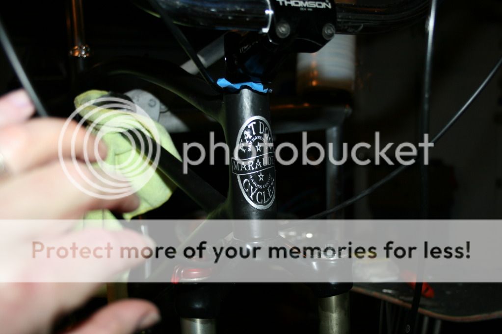

    Here is the answer to the headset question.
  • 12-14-2012

    Just one more cable stop left to braze and we are done with the hot stuff. Next step will be to remove the old seat post collar so I can use an alloy one instead. I also poured in some more brass around the dropouts to smooth them out. Cable routing on the downtube seemed the best option because it is the only straight bar on the bike. Using the top tube for the brake line was the only option for the rear brake. I had to mount it on the sid a bit to keep the cable from rubbing the head tube too much. I am going over the top of the bb shell for the rear derailler and maybe the front too.

    You might want to consider adding some material to your dropstand/dropout area so that if you snag the derailleur it won't rip the threads out. Build looks good.
  • 12-28-2012
    sandmangts
    Seatpost clamp removed, last cable stop brazed on. I filed and sanded for hours. The frame had some heavy pitting but I think after I get the primer sanded it will look ok.

    Man, Nice job. I like you added braze ons

    Always excited to see the updates. All the brazing looks really smooth under the paint. Awesome.

    I got the headbadge done today. I used a sheet of brass plated steel from an old door kickplate. The acid etch took off the brass around the resist and left just the steel showing. I then used spray paint and I wet sanded it with a Turtle wax headlight lens restoration kit. It took the paint off the raised areas and left the brass showing.

    Made a little more progress. I decided to use the Hope Mini brakes instead of the M4's. I got the rear brake mounted up and it is good to go without having to use shims or spacers. I used a Truvativ bottom bracket adaptor. I am waiting for my modified King headset and a new XT crank to arrive and then it is building time. All the hard stuff is over. The bottom bracket is just a tad higher than my DX which is good. The headtube angle is not as slack as I expected so steering should be pretty snappy.

    Are you going to keep the frame that matte black? The rock shox stuff kinda clashes with its flashy bright logos and shiny finish.
    IMHO, name brand means squat on this build. Paint the fork the same matte black! Stealthy coolness :D

    Frame too small?:confused:
    That's one heck of a seatpost. Hope that thing is solid.:D
    All kidding aside, looking good, but I agree on the stealth look. Make the fork match the frame.

    sandmangts
    Yeah, I was using that long rod to make seatposts for all my old pre-war bikes. I used it to hold the frame for painting and now it is a little stuck. I will need to put it in a vice to get it back out. I was debating taking the logos off the fork. I think I will and I may remove the labels from the wheels as well.

    Great project! I think you'll find that fork will set the bike back too much (too slack). Might be worth getting an older 2.5" travel SID (or any other short fork) vs the 3" one you have just to drop it a little more.
    I agree with the others, fork needs to be decal free and flat black would be even cooler.

    sandmangts
    Still waiting on the headset so I experimented with the headbadge a bit. I used the toner transfer method to make one out of aluminum. It was much easier than brass or copper. With brass and copper you have to use ferric chloride which is just horrible stuff. With aluminum you just use Lye (Sodium Hydroxide) and water, same stuff I used to strip ano off of old rims. I spend 2 dollars on some surplus aluminum and it worked great. Got a nice deep clean etch in about 45 minutes. I think if I had a better laser printer I could get a more detailed image but this one looks ok.
  • 01-30-2013
    CS2
    Very, very nice work.

    Finally got the headset turned down to fit and installed. After that everything else just fell into place. I took it for the first ride around the neighborhood and I am absolutely thrilled with the way it rides. It shifts flawlessly and stops on a dime. The steering is not lazy feeling at all. This is the first time I pulled a bike off the stand and rode it without having to adjust the shifting or brakes in some way. Just a little tweak to the bars and saddle and I was dialed in. I absolutely love it. I will get some dirt on it this weekend and see how it holds up. And I will try to get some better photos.
  • 02-02-2013
    sandmangts
    Took it out for a few miles of dirt today. Front derailler needed some tweaking to get it to drop to the small ring but other than that everything is solid. The 2.35 tire in the rear is cutting in pretty close but it sure takes the edge off the small bumps. 34.6 pounds as it sits.
  • 02-02-2013
    WarBoom
    Beautiful bike! Only 34lbs that's lighter than I expected, I applaud you sir it turned out very nice

    sandmangts
    It is still in one piece. I commute on it 12 miles daily and I get a few miles of dirt on the way home. I have ridden a bike everyday since January 1st this year as a part of my weight loss/get in shape for Keyesville program. Although I ended up not going to keyesville I stuck with the plan which included eliminating beer. So far I am down 17 pounds. So yes this bike has taken a good pounding. My biggest concern was whether or not the rear wheel would move in the dropout. After several drops and small jumps and some off camber impacts it has not budged.
    My biggest mistake was using grey primer, I could have used black and all the chips in the paint I am getting would not be so obvious. I will probably strip it and get it powder coated in the future if it holds up. I just didn't want to spend the money only to have to repair it.
  • 03-27-2013

    Just a FYI if anyone wants to make a head tube badge but you can use a laser cutter to do this work also. Most laser cutters don't have the power to cut aluminum (and if they do, turn the power down) but you can etch the anodization and leave a nice Al finish underneath.
    The laser cutter also allows extremely fine details and basically, if you can see it on a computer screen, the laser cutter will etch it for you.
