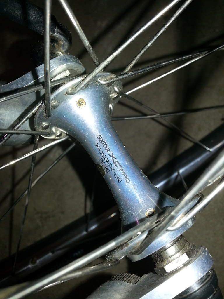

    FWIW, the front wheel and hub are original. The rear is a VooDoo rim with LX hub.

    I did some more cleaning and wrenching on it. The saddle will be changing as well. I need a cassette as well. What came on these?

    Front wheel and hub.
