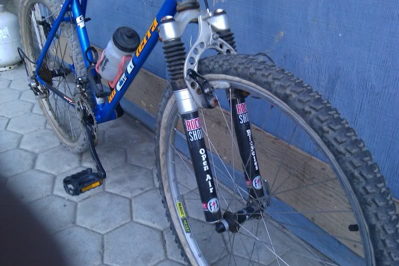

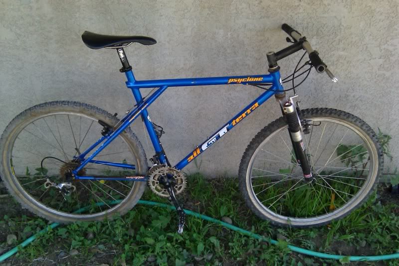

Its finally here and mine, paid 450.00 and she is a bit rough. Long story short I bought it from LBS shop owner, who bought it new, later grampa'd the bike out as seen in the pics and gave it to his dad, who recently died, who left it laying outside for an undetermined amount of time. The seatpost is completly frozen, I'm having a LBS framebuilder tourch the frame to get it out, then repaint. There appear to be no serial numbers, can someone tell me if this is common on Psyclones, and can you tell me what year it is, my guess 94/95?

It's a 94. I have one identical to it in a 16". Did you check under the BB cable guide and closely along the right edge of the BB shell for the serial number? It may be filled with paint you may need to tip it up get good light on it to see it. Should be P940XX.

No, no serial, unless its completely coverd under the paint, not even a hint of numbers or letters, subsequently when I purchased the bike the LBS mentioned when writting out my reciept there were no serial on this one as of its a custom, what is custom I didnt ask, nor does it really matter to me.
