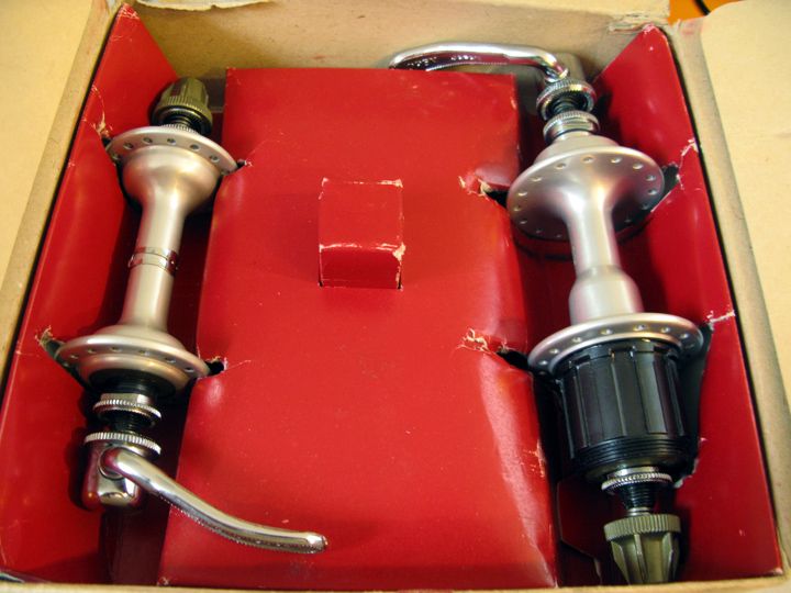

    With a mind to build a period correct set of wheels, I got my hands on a NOS set of Dura Ace EX hubs.

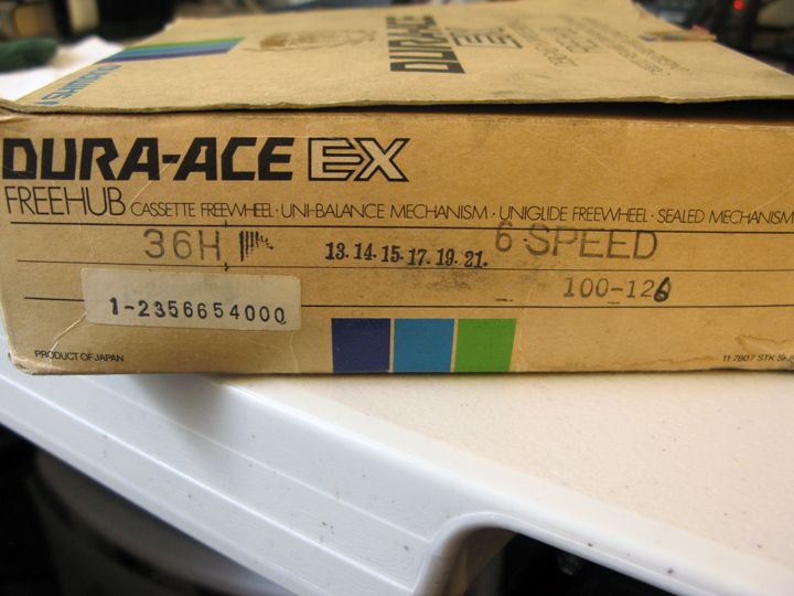

    I do not know which model, as neither the hubs nor the box identify them. The box says 36h, and they are 32h, so this may not even be the original box for these hubs.
    They came w/o the cassette, of course.
    I know I must use the Dura Ace EX (only) cassettes. BUT, am I restricted to the exact Dura Ace EX 6-speed cassette? Can a 7-speed cassette be used (as either a 6 or 7 speed cluster)? Or any other arrangement?

    I think they are Dura Ace EX 7200. Made until 1984.

    A couple of things to point out here:
    1) Dura Ace EX hubs require a Dura Ace threaded smallest cog (the outer one that holds the cassette on), as they have smaller diameter threads than non-DA Uniglide hubs. This was so you could use an 11t small cog on DA, while 12t is the smallest that will fit on 600EX hubs.
    2) The splines on Uniglide freehub bodies are all the same width, while on Hyperglide hubs (which use a lockring rather than a threaded cog) there is one narrow spline. This means that Hyperglide and Uniglide cassettes are not interchangeable, you can only use a Uniglide cassette with an EX hub.
    3) If you want to save the hassle of finding Uniglide cassettes you can change the Uniglide freehub body to a Hyperglide freehub body, which you'll only have to find once and will allow the use of more readily available Hyperglide cassettes. The hard part is finding the splined tool that's needed to remove a pre-'97 DA freehub body, but a shop with a good service department should be able to handle the job.

    I just looked more closely at the photo of the hubs in the box and noticed that they have a satin finish. Is "Dura Ace" imprinted on the hub shell anywhere? If not, those may be 600EX, which would make your life easier should you decide to replace the freehub body (600EX are easier to find). As far as I can remember, the DA EX hubs had a polished finish and "Dura Ace" was stamped on the shells.

    To answer the question about finish, they do have a satin-like finish, but they are also very definitely Dura Ace. Not only stamped on the body, but also the little end-cap seals. These are exactly like the hubs on the '84 Ritchey wheelset I have - same satin-like finish and all. 126mm and 6-speed.

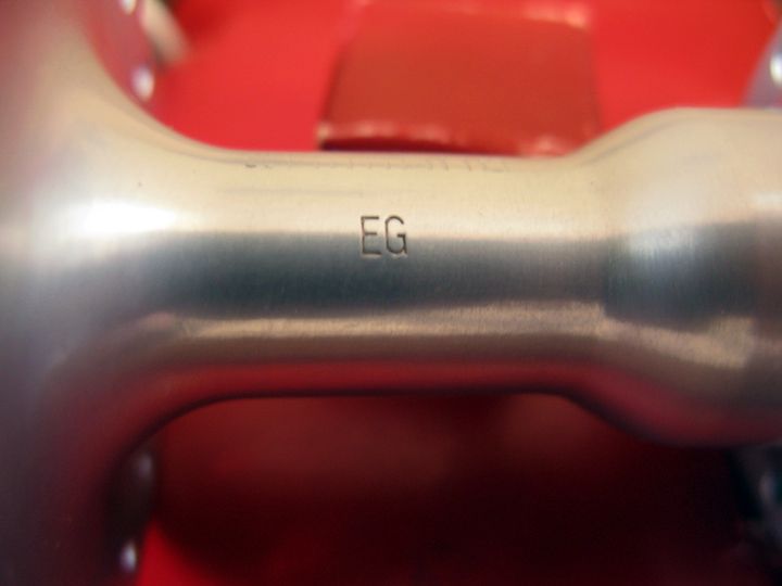

    Yes, a lovely satin finish. Both hubs have Shimano stamped on the shell. The front has a tiny capital "E 1" hidden under the oil cover clip.
    BUT all 4 seals look like this:
    The seller said these are model 7200, just as Rocco suggested.
    Again, these additional photos are strictly for the entertainment value.
    And I really appreciate the tips on swapping the freehub body. Now. To find one.
