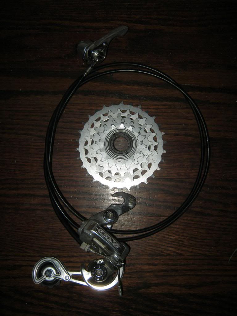

    So I've had this one home for less than a day, and already have plans for changing it up a bit...
    I got these with the deal:
    and like the idea of making it a 5-speed.
    Rear spacing is 120 so the easiest path would be to just replace the freewheel with the cluster, but I'm leaning towards swapping the wheelset to an older Bullseye set that is spaced 135.
    Is there an easy (ie. cheap) way to change the spacing of my Bullseye rear to 120?
    Also plan on swapping bar/stem combo to something more MTB...would like a set of nice cruiser bars and a Mongoose or Cooks or Redline stem if money wasn't an object...we'll see what pops up.
    What would you guys/girl do?
    Steve
    1,072
    Bullseye hub would be very simple to narrow, you might just need or remove the axle spacer washers (if present) and/or squarly cut/shorten the axle spacer sleeves to get the over locknut width measurment to 120mm, then cut off any extra axel that is protruding from theoutside of the frame dropouts.
    If you are keeping the frame at 120mm, I think I would instead build up an old sturmy-archer 3-speed IGH for gears rather than adding derailleurs. 120mm SA IGH can be found used very cheap.
    SA hub would be an interesting build, and I have a nice old one from a 1950's Triumph...hmmmmmm.
    Picked this up on the cheaps today...like Mendon's thread, "sometimes things just work out"...pick up couldn't have been timed better:
    Gold Ukais are spaced 120, so it's a slam dunk, and bars will be perfect once I clean them up.
    Looking forward to my next day off to do some tinkering.
    Steve
