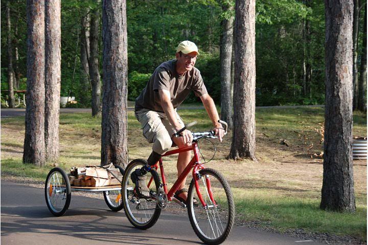

    Went camping with the fam up in Copper Harbor, MI a couple weeks ago.
    I ignorantly didn't realize there were awesome trails within riding distance of the camp ground!
    www.copperharbortrails.org
    Unfortunately, the only picture I have is firewood duty at the campground.
    I was getting kinda nervous riding on the old skinwalls I threw on before we left, but they held up fine on rocks, roots, and 1/2 mile long board walks. The Beast's 13" bb came in handy

    Quote Originally Posted by J_Westy View Post
    Awsome Jeff. Aways loved the Beast...good to see it rocking the Pep
    All this talk about high bb's has got me hot to finally build up the Nevil.
    Steve
    gobsmacked Moderator
    8,746
    Great photo, Westy! I love utility bikes! Looks like a cool trailer.
    I do too actually. Probably my second favorite after vintage, but even cooler if it's a vintage utility bike.
    Cool pic.

    Jan 2009
    884
    Quote Originally Posted by girlonbike View Post
    Thanks. The trailer is the kid's old trailer (cheapo Motobecane) that I stripped of it's upper frame and fabric and made a 1/4" plywood deck varnished in Sikens.
    We camp in our Eurovan so a utility bike is key because you can't just hop in the car for an errand.
