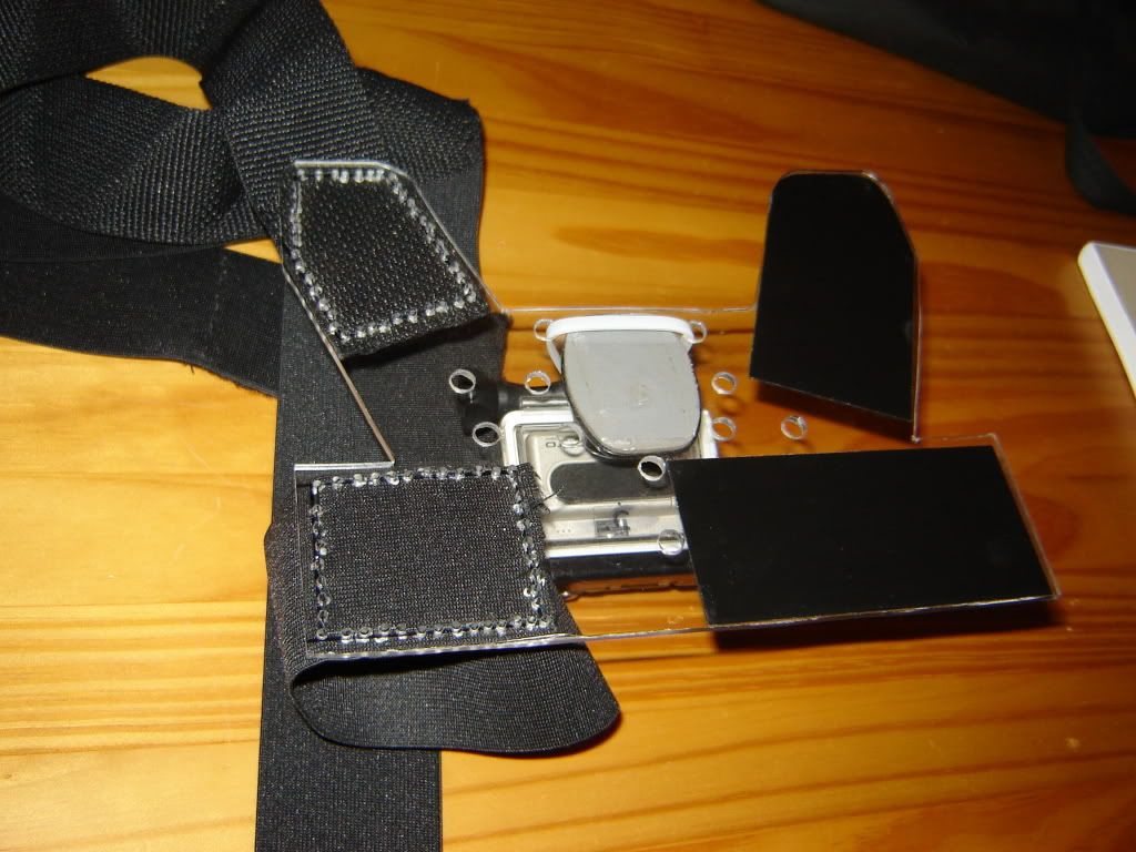

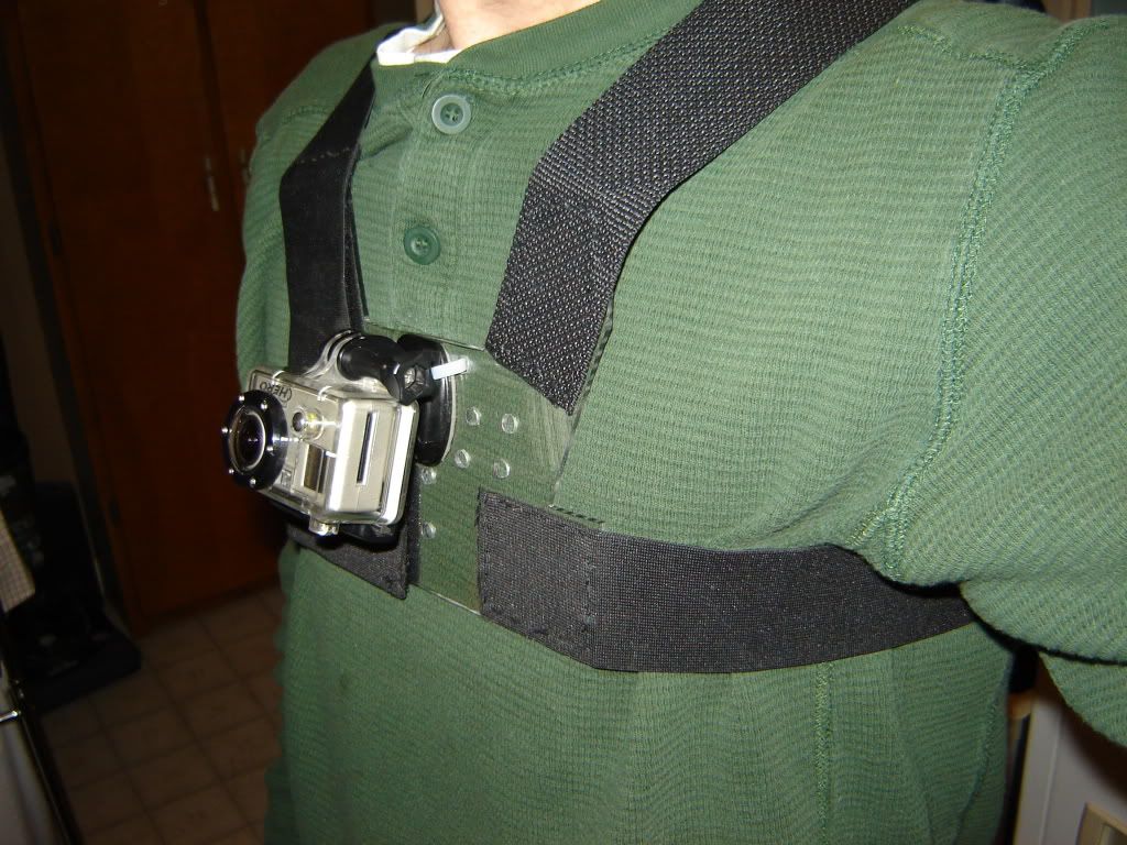

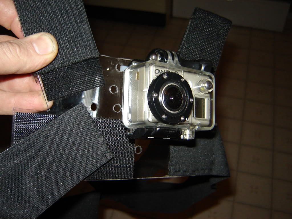

    Here is my contribution. I made this chest mount with some clear polycarbonate that I found somewhere in Home Depot, some elastic strapping from a craft store and some industrial velcro. I made a cardboard template first so that it would fit my chest and then hand sewed the straps on one side and at the attachment in the back. The thing that makes this better than the stock Go Pro chesty is that it is braced taller to stop vertical shaking. I also made it to fit me perfectly and sit very high, just out of reach of my chin. I drilled holes for ventilation and plan to attach some ribbing to elevate it from my chest for just a little more air flow. I also mount my camera up side down and attempt to always aim it so that the handlebars fill just the bottom 1/4 of the screen.
    The fall shots (with bright yellow leaves) were shot using this mount.

    Quote Originally Posted by Fullsailbiker
    http://www.youtube.com/watch?v=iSIuwl1WXpw
    I really like that....can you provide some more shots of it so I can see how you got it all together?

    Quote Originally Posted by mudpuppy
    Sure. My sewing is not exactly artful but it gets the job done. The zip tie is there because I broke the tabs off of my "J-hook" quick release. I never take it off to put it on my handlebar mount so it doesn't make much difference to me and it never rattles or shakes where it mounts to the quick release. Presently scheming a way to get a Go Pro HD, I think this mount will work well for the added heft over that of the SD model.
