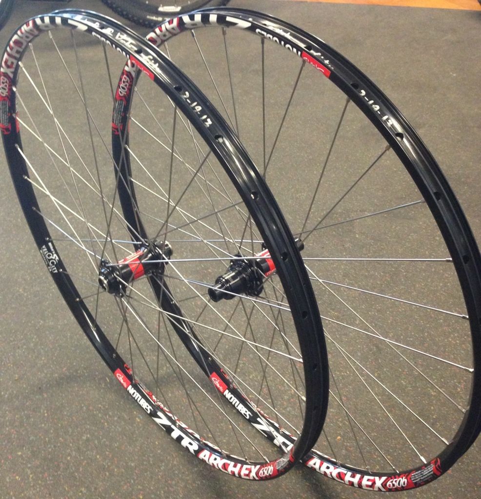

    Wheels are ready for tires now.
    Time for lunch. Wheels done. The rest of the build will commence in a short time.
    880 grams rear 142mm x 12mm
    770 grams front. 15mm
    And now with rotors and diamonds, I mean, XX1 cassette. Costs as much as a small handful of diamonds!

    Is the wheel weight before Stan's tape and valve? What spokes, and brass or aluminum nipples?
    Proud lame eBiker
    Reputation: Internal14's Avatar
    2,662
    Quote Originally Posted by fuenstock View Post
    Before tape or valve.
    DT Comp. spokes. (16)275, (32)276, and (16)278mm lengths.
    3x
    Brass nipples.
    Going for longevity over saving 50grams.

    Thanks, Thats pretty much exactly how I would build myself a 650b wheelset except I need to use 6 bolt 240's hubs instead of center locks.
    You know the center lock DT hubs come with some pretty nifty adaptors. Very slick. That's what is being used here. Almost went ICE rotors though.....had to leave room for an 'upgrade' later ya know. No fun shooting the moon al the way sometimes.
