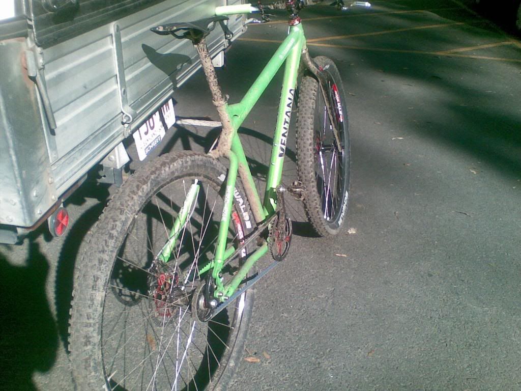

    I was so impressed with this bike after a couple of hours of single track, I bought one for myself as an early Christmas present.
    Apart from the exessively noisy hope rear hub, it was whisper quiet and super smooth.

    OK fellow belt drive Ventana riders, here is a bit of info that I can share that might be useful.
    I run a 39-22 which has worked faultlessly for over 3000k so far, once I had got the tension correct. ( it has to be tighter than is recommended if you intend to ride hard)
    With the same 113t belt I can run a 39-24, with a Maxxis 2.1 detonator. A baggier tire (Racing Ralph 2.4) will not fit. If you want to run 39-24 with big tyres you have to get the next belt size up.
    If any of you are thinking of running an Alfine geared hub, dont bother as the chainline is impossible to align due to the positioning of the cog on the hub. If gates made the Alfine specific cog with the drive flange on one side it might be just possible to align, but unfortunately for me, the drive flange has been machined in the centre of the cog.
    Hope that his info helps
