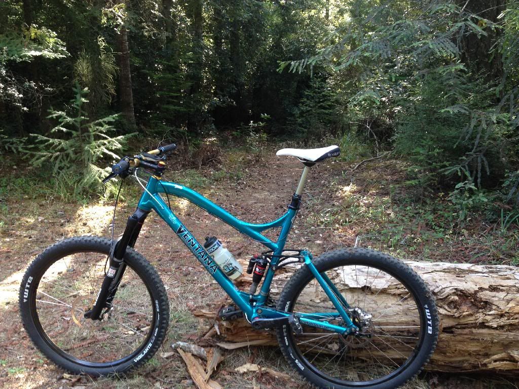

    Ok, after railing version 1.0 Chucho and the version 2.0 for years, I got myself a RM Altitude dual 27.5 150mm bike this past May. Been pretty happy with that bike. Carbon frt end, alloy rear.
    My one niggling issue with that bike is its front end vagueness. I think it's more from low top tube, and carbon.
    So, decided to bite the bullet and get myself a Zeus frame. Used my parts from the last Chucho, except new fork and rebuilt the wheels. I had sd a couple Pikes recently and they are just soooo smooth straight out of the box. So grabbed up one of them in solo air 160mm travel for my build. Built the new wheels with a new rim from WTB the i25. DT Dbl. Btd spokes and some gold alloy nipples. Shod them with WTB Vigilantes which is what I've been running on the Altitude and really like them.
    Part of this 'experiment' was to stay as similar in build so I can focus on the frames.
    Looking forward to crashing and thrashing both bikes in the next coming months.
    Here's a few photos.
    Oh, Vigilante 27.5x2.35....shock bottomed out...in 160mm travel mode ...45psi...and no tire rub.
    Close, but just not touching.

    I don't plan on riding it without air in the can so no worries there. Nor will I run 45 psi...amazing how much a tire stretches from 30 to 45psi!
    I think the Teal is the classiest of all their colors.
