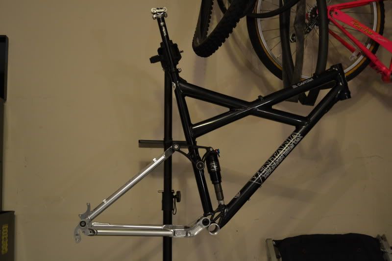

    Oh wow , I found a picture of my old 06 El Capitan w 4 " rockers and 100 mm Reba up front !
    If I still had it , I'd loose the gold components except for the hope brakes ( caps ) and replace with black stuff ! Also, no more 9 mm quick release junk for me...just 15 or 20 mm TA front and a Hadley thru bolt rear and most likely wheels built with 36 spokes and strong rims ! Probably even a 120 mm travel fork in front or Talas ! The frame is plenty stiff for us bigger riders and deserves components to match ! It was a fun bike and I miss it........couldn't resist posting it up ! TIG.

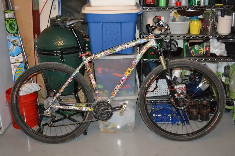

    Here is my current ride:
    My final build will be:
    manitou tower pro
    stans 36h on hope 2 hubs
    truvativ stylo 1.1 ss cranks
    pg 990 cassette
    pg 991 chain
    king headset
    x.0 trigger shifter
    x.0 rear derailuer
    thomson seatpost
    thomson stem
    monkeylite xc handlebar
    avid elixir cr 185mm
    I can't wait to take it out for the first ride!

    Quote Originally Posted by PLAID813
    Oh wow....how about a close up of this frame ! TIG.
    Jun 2010
    22
    Here is some quick cell phone pics
    Cars Hurt.
    224
    In the last photo it looks like parts of your left fork leg are invisible.

    It arrived last night. Compared to the Stumpy this just looks solid. My fork ended up being 1/2" short so I can't build it up till Monday when my fork arrives.
    The only thing that confuses me is the rear pivot. It looks like the bolts only use half the threads in the chainstay. Is this on purpose? Also the water bottle mounts are on the bottom of the downtube even though there is plenty of room inside the triangle. I normally run a camelbak anyway but its annoying if you do want to just run a bottle getting dirt all over it. Also its harder to grab a bottle from there while riding. But for $750 I can't complain.
    Attached Thumbnails Attached Thumbnails El Capitan is making me recondering my plans.-dsc_0089_01.jpg
    Cars Hurt.
    224
    I weighted the 23" frame I got and it came in at 3590g with seatpost clamp. I was hoping for ~3,400 but oah well its a solid trailbike. If I ever plan on racing I'll get a tallboy or a hardtail. Honestly for +95% of riders I think they would be happier if they ignored weight and went with a good ride.
