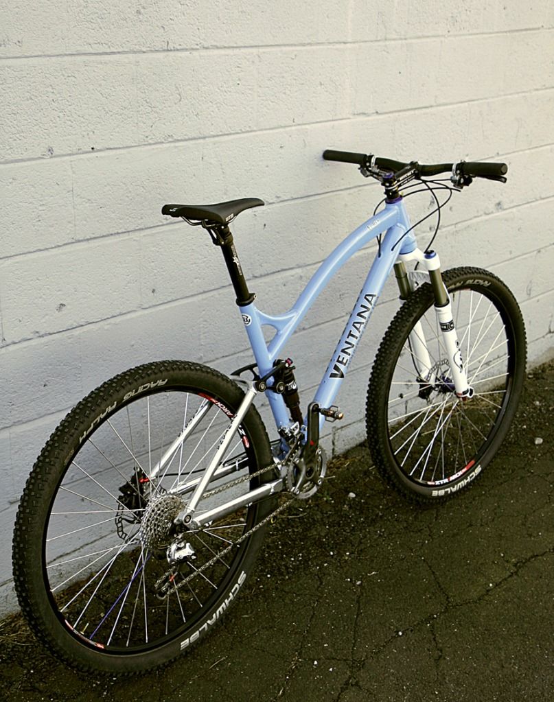

    So I have found out for myself. A 25 lb El Rey is possible. Well, a 25lb-ish anyway.
    El Rey (19 inch)
    Fox Fork
    XX Cranks BB30 Press Fit
    XX Shifters
    XX Cass
    XX Derailleurs
    Ritchey Stem
    King Headset
    Truvativ World Cup bars
    Easton Carbon Post EA90
    WTB Silverado seat
    Avid Elixer CR Brakes
    ECI Racer grips
    Eggbeater Pedals SL
    I9/Arch wheels
    As it sits the bike weighs 26 lbs 7 ounces. I have a EA90 seatpost, ti bolt kits, Ti spindle and Rocket Ron tires en route. This will be a savings of about 10 oz. Putting me around 25 lb. 13 oz. If I step up and get the Enve wheels I have been eying, but don't have the stones to get, I would drop another 290g. Putting the El Rey at 25 lbs-3 OZ.
    Here is almost the finished product. Waiting on the parts listed and a rear brake cable. The one I had wasn't long enough to fish through the frame.
    Sorry for the crappy pic. High quality photos to come...
    I have not had a chance to test it out yet. Well, I rode it around the block. Not much of a test.

    Its hard to find any good pics of the new bikes. Here you go!

    Wow, that's beautiful. Even with the bendy top tube. Love the color.

    This pic captures the true color of the bike. I had some White Balance issues on the last group and didn't do that good a job fixing it.

    I'm officially giving up the game at 25 pounds and 11 ounces. That is what the El Rey stands at today after mounting my new Nancy Carbon Rim/Industry Nine wheelset. That weight is ready to ride. No silly weight weenie shortcuts in the interest of making a certain number. I am completely stoked by my bike. I'd take more pics but it is dark and we got dumped on last night with over a foot of snow.
    Build Spec:
    2012 19" El Rey with 142x12 rear
    2013 Fox F29 CTD 100mm 15mm thru fork
    Chris King Inset Headset and Bottom Bracket
    Industry Nine XC/Light Bicycle wide 29er carbon rims/Bontrager rim strips
    Schwalbe Rocket Ron 2.25 Pacestar EVO front/Racing Ralph 2.25 Pacestar EVO rear
    XTR M985 2x10 40/28 cranks
    XTR M980 triggers
    XTR M980 Front mech
    XTR M98x Shadow+ Rear mech
    XTR M980 chain
    XTR M980 11-36 cassette
    Hope Tech X2 Special Edition brakes w/braided lines w/matchmakers/Hope floating rotors 183/160mm
    ENVE 100mm stem
    ENVE flat handlebar
    EDGE 30.9 setback seatpost
    Terry FLX carbon rail seat
    ESI Chunky grips
    XTR M980 pedals
    K-Edge Garmin mount
    Jagwire silver braided housing
    All that adds up to 25 pounds and 11 ounces.
