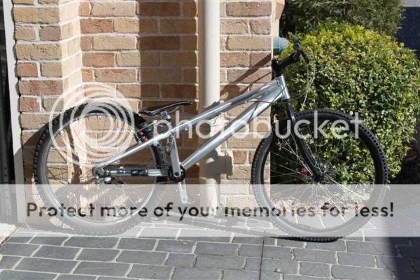

    as I said before an inspired bike is the way to go if you can afford one that is, perfect for trials/urban riding & can easily be ridden anywhere.
    I have an older Echo Pure street trials bike with 18/15 gearing & I can easily ride it all day & on quite long rides & I'm not very fit, I also have arthritis in both my knees, both hands & my lower back.
    my bike:
