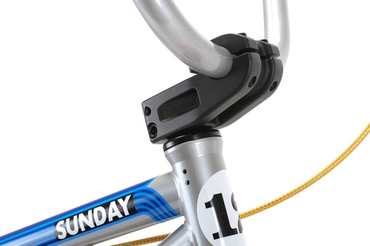

    If you're going to run 22.2 chromoly bars, you could run a BMX stem that has some rise, like the Sunday Freeze stem, or the Fit Hi Top stem.
