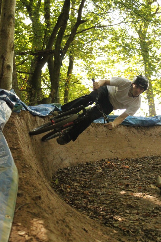

    When you blend rollers into the entrance and exit of a berm, one effect is that the rider enters 'high' over the roller then takes a low line around the berm, then exits high again. The high-low-high body motion is similar to the other pumping on the track.
    If you put more space between the entry/exit rollers and the berm, the person will be more likely to be UP over the roller, then low, then UP again higher around the berm, then low on exiting the berm. You really can do it either way. But with the second version, you would need a taller berm.
    Here's a classic low-high-low clamshell style berm:
    Whereas something like this is clearly going to send the rider low around the berm.
    This looks like it may be a ribbon style berm, where the face twists and the apex is super steep, forcing the rider to drop-shoulder....
    Another ribbon style:
    Here, the roller is set back a little from the berm. The riding line appears to be around the center of the berm (not carving up or down)....

    maybe you could build that berm out of wood. it'll help it stay more vertical--you'll need to get sideways to pin a tight 180 berm.
    this pic isn't really the dimensions we're talking about, but at least it shows a short/steep-faced wood berm....
    if you're a good carpenter, build a bowl corner style transitioned face berm like this and you will be flying....

    i think the videos kinda show that the track is rideable but not necessarily roasting-fun.... it's possible that with tweaks (like super steep-faced transitioned berms and mellowing out some roller heights, you could increase the speed. (and maybe they already did. that pic i posted above might be from the same spot.
    zack dank had some great pics posted of a backyard setup:
    Bike check/Farm check/mini mulch check/Backyard Track check
    Note the tallness/transition/steepness on the berm behind this guy:
