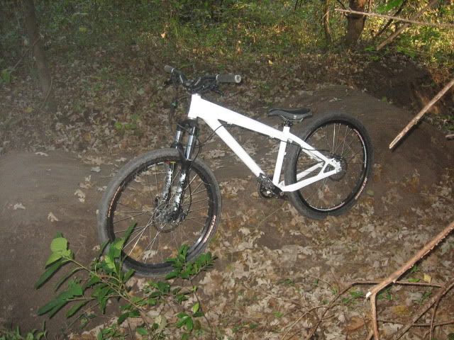

    Can we get a scale pic? Is that bathroom scale or a bike scale?
    All my parts are lighter (and some XC) and I'm only hitting 24.
    Addict frame - 5 pounds
    Elixir R Brakes with 160/140 aluminum lever bolts, no cps stack.
    Reba dual air fork no star nut or top cap
    MTX rear and Alex Supra BH front rims
    XT m770 crank m970 bottom bracket no tube spacer aluminum chainring bolts
    Odyssey PC pedals
    28/13 gearing
    Syntace Superforce stem w/ Ti bolts
    trimed Deity bar
    drilled and cut Thomson post
    Selle San Marco saddle
    Crossmark tires
    Lunarlite tubes
    OP, cool project. Not sure on the cranks though.
