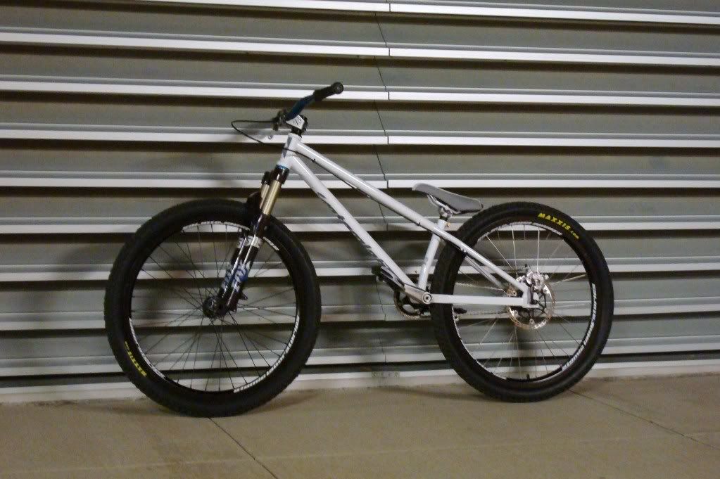

    Dec 2005
    1,425
    i just measured my 2010 TrailKing at 22.7in top tube (center to center) and 10.5in seat tube (center to top). compared to the picture above, my frame does not have the gusset from the top tube to the seat tube. with a 110mm fork and 2.4fr / 2.2rr Maxxis Holy Rollers, my BB is at a stratospheric 14.25in. i'm not sure exactly when they changed the geometry. i do remember hearing about the early TrailKings (07) to have random geometries as AtomLab tried to dial it in.
    http://i665.photobucket.com/albums/v...g/DSC09259.jpg

    ya, that's what i figure. i wouldn't be surprised if they're measuring with their AtomLab GI/Pimp 60 fork, which is obviously much much shorter than my 110 Fox. idk. i'm happy with my bike setup and how it rides.

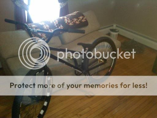

    Reputation: gbosbiker's Avatar
    720
    Quote Originally Posted by cmc4130
    pic ?!
    crappy quality, but you get the idea

    Reputation: cmc4130's Avatar
    1,300
    Quote Originally Posted by gbosbiker
    that looks rad. i run bmx cruiser bars on my Mob as well. they are 4" rise Immortis bars with custom 4 degrees upsweep. not the lightest (compared to an aluminum mtb bar), but i love em. http://immortisbmx.bigcartel.com/
