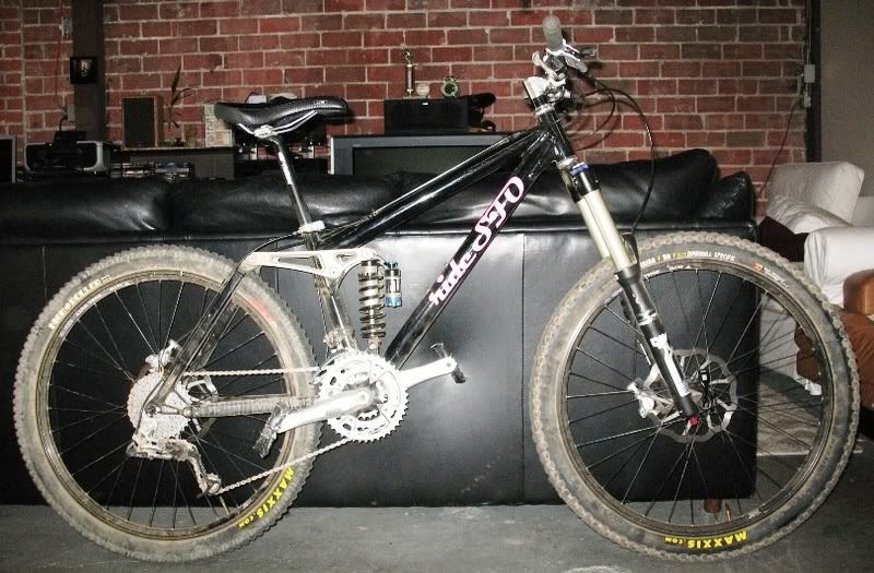

    28
    That is a sweet rig. I have ordered the rockers and the lyric's and I have maybe gone OTT but rather that getting a second bike I ordered a Cane Creek Double Barrel as well - once i fit the new kit i will post how it rides
