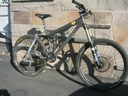

    We here at Go-Ride bought up a RF6 (6 pack) demo bike too.
    it's a medium with aDHX Coil and a Van 36.
    First off this is just a pre-test since the bike is new and we've only ridden it over the weekend,and i will update soon.It came with a 600 lb spring (way too stiff) and we did not check it till we were up in the mountains-doh! We were too busy fixing the other damaged parts from the dirt demo thrashing.
    OK back to the test.We climbed up 7 miles of middle-to- granny dirt road to acess a wickedly rough boulder strewn DH run.We also had a HL 6 pack with us.This bike is a small with a 400 lb spring so testing was difficult to compare.I did notice that the TNT bike seemed to mush less than the HL bike did while climbing up the road.This was especially noticeable in the granny,where the TNT bike has a little bit of chain torque to cancell out the oscellation of your body bouncing slightly as you pedal.The road got really rough and rocky.The TNT bike was active and conformed to the rock and climed over the terrain without losing momentum.So did the HL bike.Really they felt so similar it is hard to feel the difference.Natrually the spring rate and size come into play too much to be sure,but i think you'd have to own a HL bike and switch to a NTN bike to really know.They are that close.
    Descending,the 600 lb spring kept the rear end up too high in the travel to feel much braking influence.It did feel great over small and big hits and g outs.
    I don't want to get into the details of the ride till we get more time on it,and get it dialed in more.
    I have a close friend who had a medium 6 pack and we are going to do more back to back testing with him this weekend.
    Really i just wanted to let you all know that the real answers are in the works!! So far all looks good in Turner land.

    So you're testing a small pack with a 400# spring and HL vs a medium FB with a 600# spring..... and possible a different fork? Nothing personal here, but I would consider a test like that worthless. Don't bother. Save yourself the trouble.
    The setups are so vastly different that it makes comparisons almost silly. One bike will either be way oversprung or the other will be way undersprung. They may be using different forks......and one frame will not fit correctly if the other fits fine. Forget about HL vs FB.
    The method that Crash mentioned would be very fair. Swap rears. It would keep everything EXACTLY the same, including tires which also make a big difference. It would allow the bike to be correctly sprung.
    Changing the rears should only take a few minutes. I can do it quickly. You are a bike shop....... sheesh. Pulling the cranks is quick. You wouldn't have to change cables since the shifters and brakes would remain the same. It would just cost you a few tie-wraps and would give you a real basis for comparison.
    Heck ..... If someone wants to lend me a TNT rear for my spot, I'll test them. We have a bunch of Spot riders in the area. Many of us ride together frequently. We could have a test day or 2 and get some real input. I wonder if DT would be willing to lend me a TNT rear for a week or 2. I'd do it in a heartbeat. We have medium and large spots here, so with 2 TNT rears, we could use 2 sizes of bike for different sized riders. It may even be possible to do a double blind test, but that may be tough.

    wow-i thought i was pretty explicit in saying that this was a first ride pre test and more would follow.
    True this test (so far)is wothless- i just was getting started.I just wanted to let the people here know that someone was truing to sort this out,not expecting people to say that this test was bunk and Konas are just as good.I have only been posting on the MFG boards lately since the DH board is so pathetic.Let's let this thread be fresh and not re hashed crap from the last 3 weeks.
    Why dont YOU go and buy a new rear end and tell me how it works.
    Anyway,back to positive thinking,We WILL be testing th bike with the right spring,testing it back to back with HL and most likely test this bike with the HL swingarm.
    More to come as soon as i get the bike back from a team rider who is out riding it right now.

    3 of us riding,a 140 lb rider on my left ridin a HL bike with a 400 lb spring.
    A 180 lb ride on my right on a TNT bike with a 600 lb spring,50 lbs too form,but within reason.Both bikes with 3 clicks Propedal on DHX coil shocks.Both with 6" forks providing similar geo.
    I ride between the 2 and watch their bikes climb over rocks and compare.
    In the middle ring the HL bike is moving a couple mm's at the shock with each pedal stroke. The ride can't feel it and doesn't know it is moving and says he can't feel it.The TNT bike is moving a little less but nearly the same. With a couple clicks more Propedal the bobbing stops.The riders notice it's a little easier climbing now.
    in the granny grear the HL bike keeps working the same way.
    The TNT bike in the granny in not really bobbing much,even with less PP.It does still move over rocks.
    So far this is the only real testing that is worthwhile.
    I'm sorry that i even mentioned anything else.

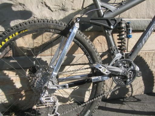

    Briefly, I wanted to comment and agree with you that the new rearward axle path is a plus.
    The thing that puzzles me most is that the brake caliper angle wrt to the ground changes as the suspension cycles. I'm curious to hear what subjective effect this has in your testing, under maximum braking conditions.
    My guess, not having ridden a TNT frame, is that the difference in feel will be negligible - that the rest of the system will just equilibrate slightly differently.
    Tommy
    it should not change.. this pic might clear yr mind..

    I agree with your photo, the suspension will not freeze up, as you say.
    However, when the caliper changes angle with respect to the wheel, both in reference to the wheel's point of contact with the ground, something happens.
