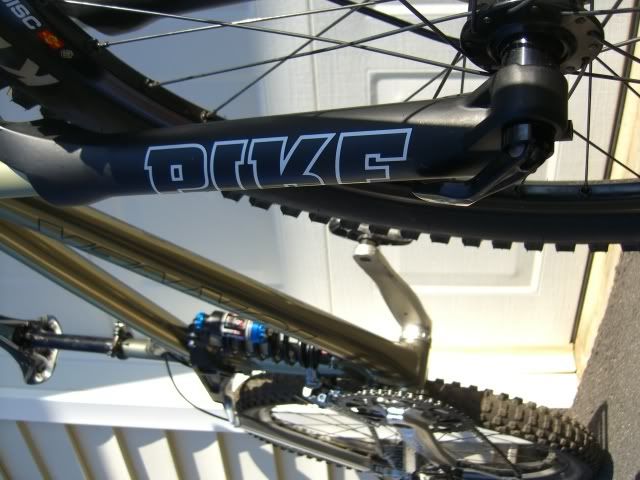

    I am running a Pike with the Ventana 4mm spacer on my 06 RFX. For trail/AM riding (some jumps, 3-4 foot drops on trail, and some stunts) it's fine. If you're planning on going bigger....might want to bump up the front fork. I'm in the process of making mine a 5-pack with 5-spot rockers right now to make the rear less pedal influenced for trail riding.
