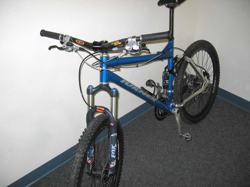

    tried to get it around 27lbs but it came out a bit portly at 29...
    Oh well.
    Oh yah. I know the cable routing is ugly, Imma gonna fix it.

    Must be the waterbottle cage...
    Funny though - where are you hiding the weight, brakes and wheels? My XL spot is 29 even with coil fork (vanilla) and coil shock (ccdb).

    Yeah, I have no friggin idea...XTR rollin' on Mavic 819's are apparently not that light.

    It's the seat, the rims, the bottle cage, and I wonder what hubs you're using?

    Hmm..Well, the hubs are XTR, The seat has Ti rails, the post is a MASTERPIECE and the tires are supposedly XC... 2.1 in the front and a 2.0 in the back.
    X9 shifting, CNT bars, I dunno what else...and the water bottle cage is not the problem.
    I weighed it on the Shipping scale at work...It's usually accurate.
    My best guess is that the frame is a little heavy and the wheels and tires weigh more than I thought they would.

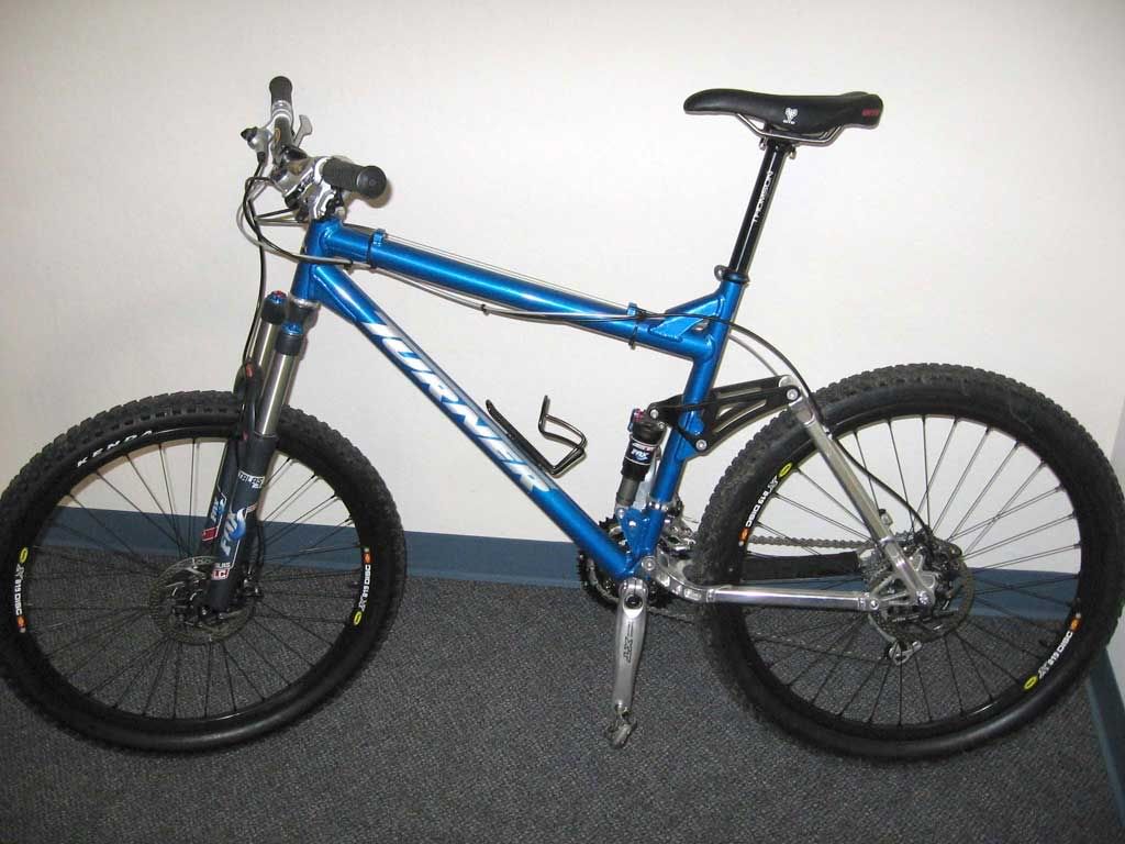

    Lookin at it, your rims are going to be a bit on the piggy side, but they're pretty stout. All in all your wheels probably aren't the lightest but you've got good quality parts and I don't think I'd mess with em to much if your happy with em.
    You could try a lighter set of pedals, but if you like what you got, why? And your seat looks a little bulky but if it's comfortable why change it? I guess what I'm trying to say, is if you like what ya got use it!! Just take a big poop before ya ride and you'll never notice the difference
    It is odd that your coming in so heavy. My build looks a bit like this XL Burner Frame w/ Fox Vanilla RC and X rockers (my float is on it's way to dtrek), Fox TALAS RLC fork, king/dt wheel set, Maxxis Minion DHf 2.35" w/ Stan's, Juicy 7's w/ 6" rotors, Thomson Stem, Race Face Next Bar, Race Face Turbine cranks and XS BB, X.0 rear, and Xgen front (no issues thanks much) SRAM chain, and XT cassette, X.9 shifters, Shadow V seat and Thomson post, oh yeah and Shimano 540 pedals. Grand total for weight is right around 30 lbs and some change, about a pound less with the Float RL on the back w/ the XR rockers.
    But if you really want to lose some weight, look at a lighter wheel set, and I can't tell what your using for tires, cept that they are Kendas, look at a lighter set of tires maybe. Pedals will save you a good chunk of change, and maybe a seat but that's one of those parts you really don't want to sacrifice, if your seat sucks the whole ride sucks!!
    Just my .02.
    By the way what do you have goin on with that rear deraileur housing??

    The seat is apparently WTB Rocket V, which comes in 250g max, those hoops are around 510grams so if you want something lighter (for XC use) get DT 4.1d. Speaking of DT you could get nice wheels with DT240s hubs + DT Supercomp spokes and those 4.1d hoops + you coud add DT/Eclipse Tubeless kit if you want to run tubeless.
    I think that the weight lies in the wheels and brakes, don't know about WW bike being equiped w/ XT brakes, XTR hubs and those Kendas.
    Get Martas w/ 7 and 6 rotors and some nice Hutchinson Spider Airlight tires and you'll drop more than pound.

    I haven't rode on a rim that weighs less than 650grams for like, 4 years, so I thought these were light. I think I put the double butted (revolution?) spokes on these wheels...Cassette is XT. I bought the XT (saint) brakes for 150$ brand new for the pair...I didn't care how much they weighed when I found out how much they were gonna cost me. I could have bought an I-beam saddle and post, yeah that would save like 1/4 pound or more...I guess I just don't know how to be a weight weenie. I was sitting here trying to come up with a response to this and all I could come up with was "Well I like this part cause they don't break and I like that part cause they don't break"
    interesting thing you say about the front and rear rim...I guess for me I always want the front tire to have a bigger contact patch than the rear, so having a smaller front rim just is thinking too far outside the box for me. I weigh 185 (sometimes 195) and I'm 5'11". The BMI says I'm overweight but that thing never counts muscle.
    I hate egg beaters...I can never clip back into them in a hurry. I tried a pair of the DH ones and used them until the pedal came off the spindle 5 months later. I like these new Shimanos so much better.

    El C, I'm running Velocity VXC rims, and would wholeheartedly recommend 'em. For a lightweight rim (410g!), they're insanely sturdy, given the pummelling they take on a regular basis due to my ineptitude and complete lack of skill. Give Mike Garcia at Odds and Endos a call!

    So neither is UST? The 2.0 Nevegal isn't very light (relative to the 2.0 Blue Groove); a 2.1/2.0 set would easily average over 600 grams/tire. If you're not using Stans or super light tubes, you're wheels are the main culprit. That and a number of nice, if not particularly light parts (Thomson stem, Shimano brakes, X9, 959 pedals, TALUS fork, lock on grips, etc.).
    My large Spot weighs the same w/ an RP3. Major differences:
    -I use 2.5 Kendas w/ Stans sealant (no rimstrips needed w/ 819's)
    -King hubs & SuperComp spokes
    -EA70 Monkey Bar
    -No bottle cage
    I can see how those differences would add up to a wash weight-wise.
    I will give you that 29 lbs. sounds like a lot for a bike with air shocks, hydraulic brakes, non-UST tires, and a carbon bar. My Flux meets that description and weighs 24 lbs. Like the others have said though, weight is just a number, but what you have here is a super nice bike that should hold up well and suit your preferences. Ride it and love it!

    Ahh..saint brakes. It starts to get clearer.
    The front contact patch has little to do with what rim you are running up front, at least when the difference between tires and rims is not that significant. If you were running a full DH bike with 25-30mm wide rims, you might have something, but the difference between the 819 up front, and virtually anything else comparible will be about nil, so you'd only save weight, not affect your contact patch. There are some people that are fanatical about how wide their rims are, but with so many tire choices on the market with difference shaped carcasses, I don't find it to be a real valid concern.
    The eggbeaters are NOT like the DH pedals. I have the mallets, and I don't like them much. They are hard to get back into (sometimes you roll across them and not clip in, sometimes they hit rocks, the mechanism doesn't let you just put your foot on it and "sink" in like shimanos). I'd agree fully on this one, however the eggbeaters are exactly what they are supposed to be, a lightweight pedal that has great mud clearance and is fairly easy to get in and out of. It doesn't have as much problem as the DH pedal, because the big cage is not there, and IMO they're just not trying to be anything extra. The eggbeater mech in the cage of the mallet pedal on the other hand is not a great idea IMO, and easily outclassed by 545s, 646s, and a few other pedals.
