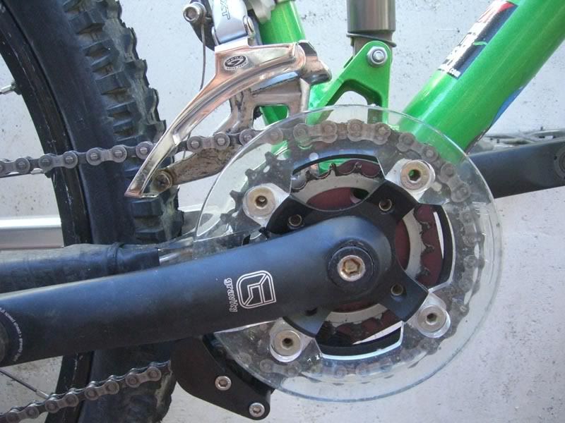

    Hi,
    do any one have experience with E-13 DRS on spot frame? will it fit on the Spot Frame?
    (this spot used HL)
    Thanks In advanced!

    5spot doesn't have iscg tabs on bb shell. i guess you could sandwich the backer plate between the shell and bb bearing cup (assuming you are running external bearings) but the plate will move around if it is hit on a rock or something. not sure y u would need a chain guide on a spot anyway.

    Yes, the BB mount version of the DRS fits up perfect!

    Yep, you'll need to mount it behind the BB shell. It works great, I was late to the party on getting a DRS and I wished I had done it much sooner. I haven't lost my chain since!

    Yup! Ran mine that way for 3 seasons on the 04 Spot and now its on my RFX. Never once had a chain drop or any movement of the guide plate.

    Thanks guys!
    what is the name / number, of the correct DRS model for the spot?
    can you say from this link?:
    http://www.chainreactioncycles.com/S...spx?Search=drs
    how is the right one?
    BTW I Use the SLX crank
    And.. if you can send sum photo of the way of how to mount it properly.. i read that its complex..

    Hi,
    whats BB mount version of the DRS, is come when you buy the DRS or should be purchase separately?

    The BB mount version can also be mounted to ISCG-Old tabs. You can see a picture of it here: http://www.e13components.com/product_drs.html
    There is also an ISCG-05 version (not shown in the picture) that does not mount to the BB.
