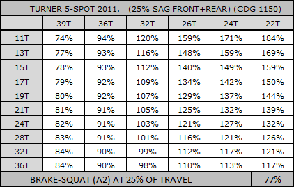

    More info, this from Linkage Design:
    Source: Linkage Design: Turner 5.Spot 2011
    _MK
    Before you diagnose yourself with depression or low self-esteem, first make sure that you are not just surrounded by a*holes
    Bicyclochondriac.
    13,491
    Awesome chart, thanks!

    An Update:
    I replaced the 22t/32t rings I was running with 24t/36t rings.
    I do notice a little difference in the granny, but it is not huge. The difference in the 36t ring is definitely noticeable, and IMO a real improvement. Feels great, actually. In another thread, I saw how the anti-squat of the 5-Spot compared to my old MKIII. I notice that the numbers for the MKIII with 22/32 rings are really close to the 5-Spot with 26/36. This totally jives with what I have been feeling as I ride.
    Only problem is, for me and my riding, the 22/32 rings are more useful. I've been getting away with the 24t granny OK, though I have yet to do any really long rides where a few hours into it I need all the help I can get. But I think it's going to be OK overall.
    Surprisingly, it's the range of the bigger ring that I have some issue with. Since it is about a gear higher than the 32t ring, I need to drop down to the granny sooner. I realized that in my riding, I do climb a lot on the easiest gear in the 32t ring. So now I am dropping down to the 24t ring on many climbs that used to be middle ring climbs, and instead of getting a more active suspension, it is LESS active.
    I'm thinking of trying 24/32. I never really needed more on the high end of the 32t I was running before, anyway. Or I will just HTFU and learn to push the 36t ring. Kind of ticked that 9 speed options with a 36t cog are so limited (I have an Aluminum carrier, and all of the 9-sp cassettes with a 36t separate cogs, not on a spider).
