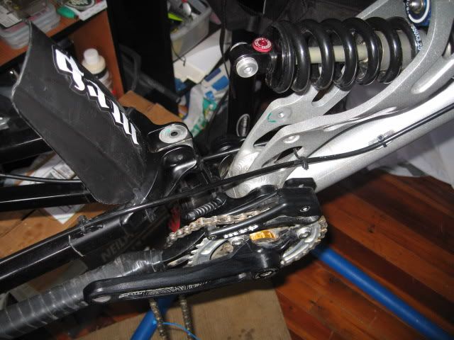

    Hey guy's question for you DHR owners!

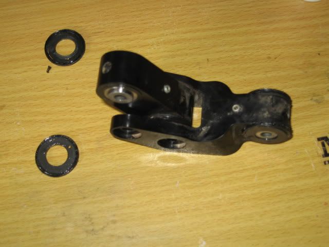

    I'm aware of some of the issues of the link and wear which produces slopw or movement, on my shake and bake ride I felt a bit of movement when lifting the bike in stationary mode, e.g from the seatpost mainly over the fence and onto the bike rack, I had checked all bolts pre ride though not with a torque wrench just went over everything with my allen keys to check for nipped upness
    So as I finished my ride I noticed it more as I had been checking and recheck throughout the ride and setting up dialing I got out the spanner and 5mm allen and went over the pivots bolts until tight as, and as picture the 5mm bolt was tight but not enough to prevent the movement, so I tighened her up as much as I could without over doing it and no movement, just worries me that it takes this to make or remove this movement, is this normal or something to watch.
    cheers in advance

    Normally that's a sign the bearing in the dogbone link has gone, though obviously as the bike is brand new that can't be the case. The bolt needs to be tight enough that the steel axle is held in place. My advice would be to keep it tight and keep an eye on it. Maybe the shaft is slightly shorter than spec or something, but so long as it doesn't move, you should be good.

    i always thought that I had play in exactly the area you highlighted, but in reality it was the bolt at the front of the shock that kept coming loose. Some blue locktite and i haven't had any issues since. I've been pounding the new bearings for a couple weeks and no slop at all, anywhere.

    I have no experience with the DHR but on the Intense M3, when I feel some slop pulling up on the seat it's one of the shock DU bushings that needs to be replaced. That's probably unlikely in your case as it looks like a brand new bike.

    TA, I'm not sure how old your DHR is, but obviously it's from the 2009 Go-ride.com batch of DHRs. If you have a few miles on it I'd guess the shock eye bushing has worn out. It's a high wear item, but very cheap an easy to replace. Once the bushing is worn it doesn't matter how tight you make the bolts. This is the item you need if you want a long term fix: RWC Eylet Needle Bearing.

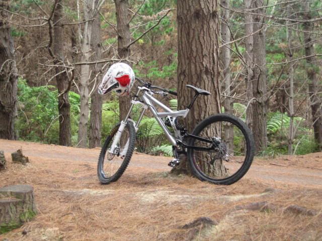

    a couple here
    Some picc's here, I have a few from my ride the other day but no action, didn't have time to play around with timers as was on my own, will post up a ride shake down report sometime with more picc's for ya, have some great nature shots of ferns and fantails and Maxxis and some portrait DHR shotz

    Now that I know you have a new bike I did some more checking here at the shop. I checked our complete floor demo and it has no play. I also checked 1 year old team time (ridden very hard, even at a couple WC races) and it also has not play. There is a slight bit of movement in the rear, but I can see the shock compressing as the bike moves under a slight load. That shock has a custom Go-ride.com tune, so it is more sensitive than stock DHX5.
    So, I'm hoping the other poster was right and the play is a loose front shock bolt. I've made that mistake myself as I did a lot of custom shock testing with the DHR last season. I'd be in a hurry to swap shocks and forget to "really" tighten the front shock bolt.

    Tracking down play on those links is a science in itself. I've actually broken one of the stainless bolts from over tightening trying to snug up a link. About two years ago, I went to the hardware store and bought a bunch of black hardened steel bolts and a bunch of lock washers. I'd definitely recommend doing that to anyone who owns an 03 or later dhr.

    i would figure out which bushing it is. may take a few rides and moving of suspension on//off bike. get some new bushing(s)

    Cheers for suggestions guys but I have isolated the play I mentioned above it was very obvious in the link pivot where the red arrows are pointing.
    The bolt in this location was tight, not loose, with an Allen key only I could not get it any tighter, but with a socket on the nut side and Allen on the drive side I could get another half a turn tighter this took the play out of it and now there is no movement in the link or shock or anywhere.
    My concern was that this seemed to me to be strange to have to tighten to this degree to take that amount of movement out of that pivot point, maybe its normal I dunno.
    Will see how it goes over next few rides and see if it loosens or plays up [pun]

    Just a little quick word of advice: Next time you've got wrenches in hand around your bike, loosen all those links. Put the bike ON THE GROUND so that there's weight on the links and they're sitting in the "bottom out" position. Then tighten them. This leaves no space for them to wander into when you start beating on them on the trail. Tightening them in a bike stand with the links in an extended postion from the wieght of the rear end does just the opposite, so I try to avoid it. Also a good idea to do with your shock mount bolts on both ends.

    Fantastic Woo, that's exactly what I was looking for, I will do that today, this morning actually lol

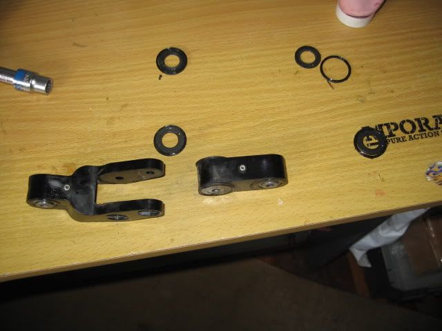

    I rode an 08 DHR from early 08 to near the end of summer 09. When I first got the frame I was blowing through DU bushings nearly every other ride using the stock aluminum reducers. I switched to Stainless pin and sleeve system and my DU bushings started lasting months instead of hours. Huge difference, and it's a lot easier on your shock to not have to push in and push out all those DU bushings. I think I used the Marzocchi ones.... 6.00 x 22.00?
    Also, I routinely had issues with the bearings in the dog-link getting haggard. This only stopped after I sacked up and bought a tub of the Dumonde-Tech grease and fully flushed my bearings after every single muddy ride (as opposed to the 'every few' I was recommended). This time bearing life went from weeks to the last year I owned the frame. Huge improvement.
    I'm on a 951 now with the fancy RC4 and a brand new build, but I still find myself missing my 08 DHR. That was definitely my favorite DH bike I've ever ridden, let alone owned.

    I've definately spent lots of time chasing that same bit of play around, but not when the bike was new...
    KW's advice sounds good, let us know if that does it.
    Pat H sounds like me, the stock bushings and reducers just don't cut it, try the marz's, the rock shock ones, the new bearing type, did you shoot Turner an email and ask them? I also find that grease is key, good thick stuff, fill them often.

    More great advice there Pat cheers, I hear ya on the grease DUs and Stainless pin and sleeve, will do that, what do you guy's think of the enduro needle bearing kit the boys are starting to run on there 5spots?
    I just need to find where to get them bolts and the grease, should be able to get marz here from LBS or RS in stainless.
    After todays test I got 3 trails in was knackered testing runs on the first, but could not stop, no matter what had to keep going to dropped, nothing is loose and no movement, so hopefully for now its sorted, it was pretty dusty so I will pull it down, flush everything an d pack the grease in there!
    Great info guys thanx heaps, I here ya Pat on the bike sometimes the grass is not greener, I am very impressed to date how this thing rips, will give some thoughts later in thread.

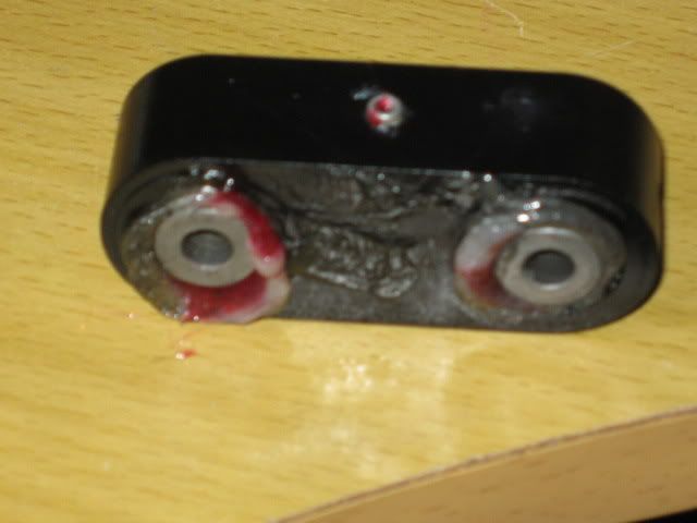

    I took Woo's advice and followed his steps of loosening everything off and while static on the ground I re tightened everything and went riding

    Thanx AW, yeah I hear ya I will follow the advice of you guys and clean it down after yesterdays big ride and pack it up with grease, loctite and tighten the Woo way
    I have not emailed DT or Greg I didn't know if it was an issue and these ideas have nailed it for me, I was aware there was minor issues with the DUs etc but that didn't stop me I knew I could overcome that with some help and creative thinking the bike is just to goo to let that hold me back,. and having 2 previous Turners I know how to look after em well and what to maintain, regular or pre ride maintenance is no issue for me on a DH bike, I sort of see it as part of the scene, my moto days I always spent time prepping for races rides, and then cleaning prepping, the cycle never stops, so sort of in my element really.
    Need to get some thick grease now.

    Some picc's of yesterdays rippa
    Tried to get some action shots could not run back up tot bike and get back in 30secs even with a 5 shot phase, I think I have one piss porr sequence lol..
    First zone Handjob track and Trig picc's only show some of hand job!
    Start of the ride about 3/4 way up hand job got the PnS out maxxis already hot she was a steaming sweaty day
    More of the DHR
    trying to get my move on, hard when ya running back to get the bike and make it for the timer not much time for style and the camera missed my wee drop attempt
    Onto pattersons and Stoka another area of Riverhead tyime to get out of the sun and into the shade.
    Sick of POWDER
    Try some Kiwi POWDER currently soft and dry
    Maxxis action shot
    Some views of Pattersons trail bike in picc for scale and hopefully show some decline
    Bike is no longer clean, cherry popped well and truly now!
    And lastly of stoka missed the action pic but nailed this last gapper, actually nailed the whole track so was stoked on stoka!
    Woot woot Braaaaaaaaaaaaaaaaaaaap.
    cheers for reading lol

    So guy's I took all you're advice today I removed the stout link off the DHR and disconnected the rear end of the shock had to to remove stout link.
    And cleaned then flush the old grease out, even after a couple of rides it was good to do this as the grease old stuff was quite mosituress and dirty in parts, so its now flush I do love the Turner bushing and needle bearing system, watching the purge is quite good fun and ya know straight away the good stuff is in there because ya see it replace the old as it pushs the crap out, I flushed the main pivot as well, did not need to remove that part, nice!
    I going ot order one of those Le tour /Dulco guns does the grease come with it or is it seperate ? is the Le tour white grease what is picutred with the grease gun on your link? thanx AW.
    So again following Woos way, I reconnected her back up but only slightly nipped then with wheels back on and bike sitting on ground nipped everything back up tight, first maintenance day done.
    I like to remove the link, this way it gives me good way to see whats what and its easier to purge the old grease imo and cleaner too!
    Am loving this, tis good to be back and playing again with my Turner

    Reputation: airwreck's Avatar
    5,880
    quite the write up there TA, I've wanted to try to type out my riding impressions of the dhr before but only get as far as, fun! For sure it's a unique experience compared to regular mtb's and really doesn't compare, whole different experience than pinning the rfx, HL etc.
    Check out Dualco's website and you'll see many varieties of grease guns and I sometimes use the bent tip of the turner gun with it. I don't think that shop sells that waterproof grease anymore but it was just some repackaged stuff anyways, the red stuff you used looks like it, maybe belray makes it?
    I've got a few broken marz fenders and been wanting to do that too.

    trail fairy
    9,554
    <br>
    Quote Originally Posted by airwreck
    You got me stoked to get back out on the dhr, been awhile.
    cheers AW, yeah always looks longer [my write ups] than they do in the word doc, I just find I can't get everything across in 2 lines, I'm a details person[ 7yrs AF] must have drummed that into me, though Ive worked on bikes since I was in single digits when I got my first bike a wee starflyer, at 2, I bought my first moto x around 8 by myself with paper round money a Indian 70cc MX, man I loved that bike much to my mums horror
    I hear ya though and that's only my shake down review haha try keeping up with my mind after a few beers, I make Sheldon off the Big Bang Theory look timid lol.
    Ya haven owned a few DH bkes in past and the Kona pre injury and ridden a few others, not all of em and none of recent stature I am still surprised at how big a difference there is, I know turners are unique and have there own feel, but man this bike is something, maybe it really fits my style, I got a long way to go though, but its so much fun, maybe its our trails here to but I enjoy walking up the track checking out lines and then taking advantage of that on the way back down, ya just don't need shuttles and chair lifts to enjoy this, I used to do it the Kona as well, love it.
    Not sure the red stuff I was using is s thick enough for long term abuse, regular changes it w/il be ok, it is very sticky though, [Rock n Roll] and but Bel Ray I can get here, I will check out the Dulcao site though, I do love grease
    Ya the fender is working out well, so far just some sticks and rocks but I dig it,
    Am stoked to get ya stoked to get back on the DHR. woot
    cheers <br>
