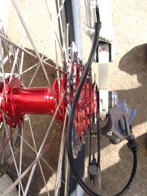

    You're 2x5 setup has definitely caught my eye in the past based on the gears I use most frequently on my RFX (I'm east coast as well). I'm all for simplicity but I need gears because I don't have the legs of a SSer so this looks like a nice compromise. I may look into this further down the road once I get this build sorted.
    born out of conveince really - all the parts were a direct transfer from my hardtail, which was setup SS, then 1x5.
    I've got 1700+ miles on the dishless rear setup and it's been totally bomb-proof for me. I'm able to add a big ring to my cranks if I need more top end than the 34/18 provides - but as of yet, I have not ridden a trail on the east coast where I couldn't easily motor along at 18mph comfortably in that combo.
    My standard modus operandi (sp?) while tooling around is to run 34/24 giving me the option for two lower gears (28 and 32) and to higher gears (21 and 18). Running Shimano XT shifter and XTR M953 derailleur, I can dump two gears very quickly with one stroke of the lever so I don't waste time on the flats and w/ the rapid rise, upshifts are quick so it's turned out to be a fairly matched setup to the short up/down twisty east coast/southern terrain features. As far as I know - the SRAM mech's don't fully work when limited like this, Rainman did some tests with an X9 and couldn't set the limits sufficiently b/c of the design. I had just enough length in the limit screw to do this on the M953 without getting a longer one. See L-limit screw is all the way bottomed.
    <a href="http://picasaweb.google.com/Kevin.Rants/TurnerSultan/photo#5161064462303232690"><img src="http://lh6.ggpht.com/Kevin.Rants/R5_IyLJ6ArI/AAAAAAAABOg/BG9Atd98F2Q/s400/IMG_2492.JPG" /></a>
    So far, I've only used the granny on sustained climbs like the one at Oak Mtn in Birmingham. 2.3 miles of misery - but with a short 5 cog spread in the back, I can drop to the granny early (24t chainring) and stay in my middle 24T cog on the cassette and still have two more lower gears when the suckage reaches that level - this setup mitigates cross-chain issues a fair bit.
