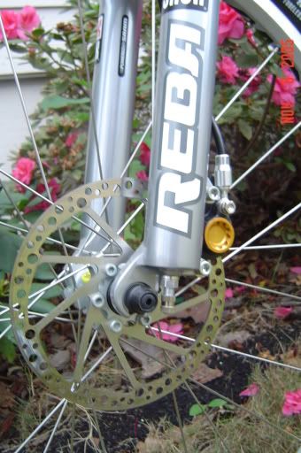

    Get a 05 Reba. Still has the 32mm stanchions and if you can find a u-turn model they go up to 115mm. It is a very nice riding fork and can be had in normal colors like silver, black and red.

    Reba
    Yes....this is definitely in the running as well.....Just not sure that I might want a bit more travel than the REBA offers. Price is again, comparable with the AM forks, but would be saving weight....tougher decision....
