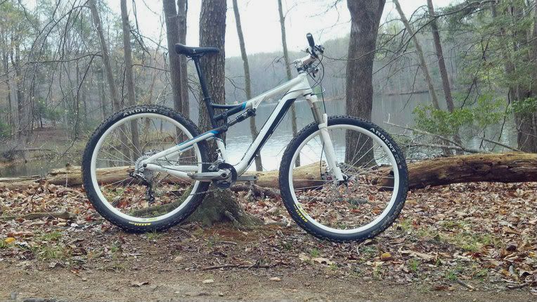

    Yes, P-35's with Ardent 2.4's on a Hi Fi Pro (same frame) rear is all good, while the Reba is real tight.

    That looks awesome. P35 is the same as blunt 35, right? Did you change the rims, buy a complete set or build them yourself? If so, what are the components?

    Yes P-35 = Blunt 35. Built them using XT-785 hubs, Wheelsmith db spokes, DT alloy nips and ice-tech rotors. (avoid the XT rear hub, mine exploded on it's 8th ride) ... now running a DMR 6 pawl.
