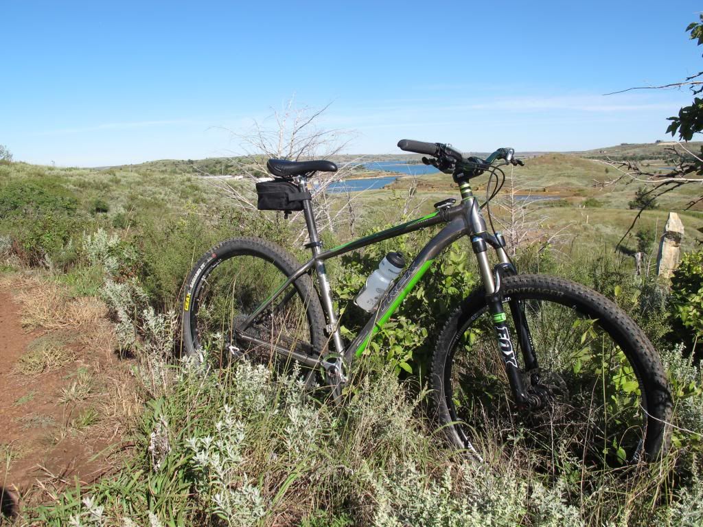

    Stache story...
    About 2 months ago I started my bike search. I knew I wanted a hard tail 29er and so I began riding everything that I could! My original budget was $1,500 and I rode as many bikes locally as I could in that price range. I was always sure to ride them in the grass and anyplace I could off the road to try and get a better feel. Wheelie, bunny hop, jump off curb cuts etc... Having come from a 20" racing background as a kid I longed for a bike that took me back to those roots. Ride after ride I felt "meh" after getting back to the shop. Every Trek Hardtail 29er felt unresponsive for what I was looking for and I got the same impression from the GT, Giant, and Raleigh offerings in this price range. It wasn't until I threw a leg over a Cannondale 5 that something actually spoke to me. It rode small, nimble, tossable and I KNEW I had found the type of ride that I was after. It was only an $750 bike and I was suspect of some of the components but I loved how it felt. The same LBS also had a 17.5" Stache 8 in stock. I saw the price tag and figured I might as well take it for a ride and dream if I liked it...
    After the ride it was exactly what I was after and I got a VERY good deal at $2,100 plus tax. Needless to say I bought it on the spot and have had it for about a month. The first item was to add some quality platform pedals (old BMX'er) in the form of Azonic 420's. In that time I have logged over 100 miles of single track and I have learned not only how to ride again, but a LOT about bikes and what geometry suits the ride that I am after! In that 100 miles I managed to bend the front wheel pretty good, I had it tweaked and re-trued and it is straight enough to ride the rest of this year and I also bent the rear dropout and replaced that. I also trimmed 20mm off the bars as well as the seat post. I found that my preferred seat position was limited as the post bottomed out on the tube taper so I re-marked the minimum depth and hacked away. Aside from that the bike is completely stock and I while I am VERY happy, I have figured out enough as to what I want to change on the bike.
    Upcoming mods:
    • I am taking the stock Expert 2.3's tubeless
    • Replacing the bars with Race Face Carbon Next wide flats
    • Shortening the stem to the Race Face 70MM turbine
    • Seat post being replaced with Race Face SixC carbon I beam
    • Seat will be the Race Face Atlas I Beam
    • Deleting the small front ring and derrallier assembly and shifter. Will shorten the chain and hope that the tensioner on the rear keeps the chain planted.
    • I plan to switch the up and down shift lever orientation so I am pushing to up shift and pulling to down shift. Even after 100 miles I still feel like it should be set up this way.
    I would like to shed some weight and simplify the bike a bit with the above modifications and make it more to my liking. I cannot fault how this bike does anything. I understand their are other bikes in the price point but after riding so many this felt like home to me and I do not regret my decision one bit.
    Here is a shot of my bike from a ride this last weekend at the Lake Geneva Canopy Tour trails here in Wisconsin.

    First round of upgrades.
    After putting another 50 or so miles on the Stache 8 I have completed my first round of upgrades and I followed my plan in the above post.
    First up is the Race Face 350MM SixC Carbon I beam post and the Atlas I Beam seat. I did this upgrade to reduce weight and to also change the seat. I wanted a slightly smaller and more minimalist seat and the atlas is perfect. The one bolt adjustment is also VERY handy thus far. I did not have to trim the post like I did the stock one to achieve the desired seating position and I am very happy so far! It is easier to get back off the seat when necessary and I feel like the carbon post and setup transmits slightly less harshness to my arse than the Bontrager setup did.
    I opted to shorten the stem to sharpen response and to make it easier to get the front of the bike off the ground. I used the 70MM race face turbine stem. While I was at it I figured I would try out the 720mm RaceFace next bars to see how I liked them. Weight reduction is one benefit but many say that carbon bars help dampen some of the vibration transmitted through your hands. Because I like to ride very small grips and light gloves I figured I would see if it was true. The bars are VERY close to the OEM Bontrager but of course lighter.
    I love the stem and the bars. The stem is what does it so you could easily re-use the stock bars or use a less expensive shorter stem to achieve a similar result. The difference is not small in my opinion. On tight switchback climbs my line is much tighter and easier to maintain, on fast sections I have to lessen the amount of lean on the bike as it turns in more quickly. High speed stability was not diminished in my opinion as it feels rock solid so far on the local trails. I also did slightly notice a slight damping in the bars without sacrificing bike feel or steering input.
    Overall a very worthy round of upgrades and I am pleased that I did them. I am helping a friend with setup and the stem and bars are going on his Cobia and I will probably keep the seat and post as a backup.
    As it stands right now the bike weighs in at just under 27 lbs. Goal is under 25 by the end of the build.
    Next upgrades are tubeless on the stock wheels, pedals, and over the winter I really want to do the Mavic CrossFlex SLR wheelset.

    Here is my new 2013 7, need to get a better pic. I had the LBS swap in a 22 chain ring up front but everything else is stock.
