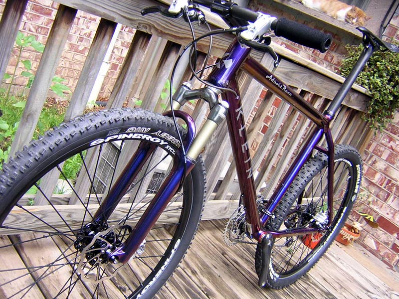

    I once asked Klein about that Plum Crazy, because I wanted to match my fork.
    Well, the email's been long deleted, but I remember its PPG paint!
    http://corporateportal.ppg.com/ppg/
    I also remember that they told me, its magenta, gold and blue.
    Those three colors are in the paint.
    The other thing I can tell you is (if all else fails), that the dupli color mirage red-blue is very close to the plum crazy, but only from the front and side, from behind it's lacking the gold.
    The dupli color gold-magenta matches it perfectly from behind, but not from the side or front.
    Further this paint is not good on impact and has to be coated with some clear coat other than the one it comes with to protect it.
    http://www.duplicolor.com/products/mirage.html
    Here are a couple shots: These two with the Red-Blue
    These 2 with the magenta gold:
    Again, go to a PPG Dealer or a paint shop that uses PPG, they should be able to match it.
    The colors again are: Blue, Magenta, Gold

    You are showing us two different bikes? One with disc brakes, one with rim brakes? (Is that like one for you, one for Significant other?) Those paint jobs are beautiful. Did you prep and paint that yourself? Is that really paint out of a rattle can? Wow!
    Aug 2005
    341
    No, it's the same bike/frame, I first had V-brakes and switched to Discs later.
    Yeah, both forks are painted with paint out of a rattle can!
    I just think the red/blue matches better than the magenta/gold.
    And yes, painted and prepped it myself.
