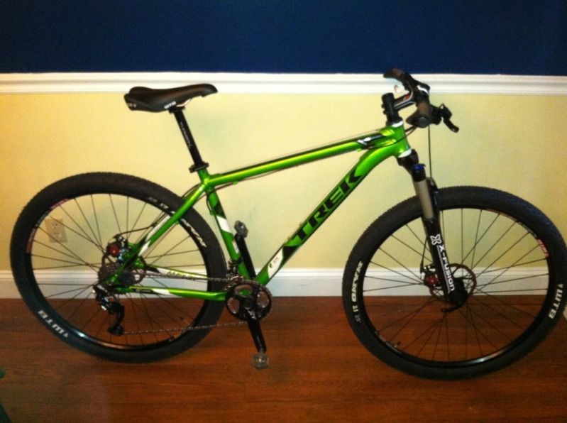

    In the pic (bike is sold now) the bike weighed in at 22lbs. Only thing left from stock bike was the Frame, Fork and RD.
    Shimano XT M775 brakes
    Gatorbrake Aries rotors
    Bonty RL seat
    Thomson elite post
    Easton Monkeylite SL
    ESI Chunky grips
    MRP x1 BB mount
    Shimano XT M760
    Shimano XT 11/34 Cassette
    Sram X.7 shifters
    2 Racing Ralphs.. 2.4 (FR) 2.25 (R).
    Wheelset is Velocity VXC on Halo 6 hubs
    Salsa Skewers
    Think thats it =)

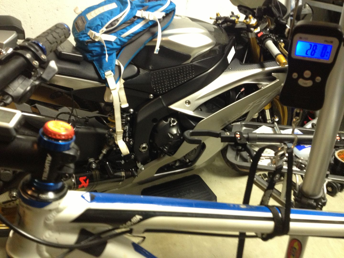

    I am using a Balanzza mini luggage scale to weigh the bikes.
    As you can see, I didn't save much weight from doing the component swap. If I did lose any weight, the difference between me and my wifes Mamba is probably offset by the fork.
    So if you're looking for huge weight savings, start with your wheel/tire combo first (which is what everyone recommends upgrading first anyways).

  • 09-10-2012
    jjmmagoo4
    Originally Posted by clinklion View Post
    My custom Superfly AL Elite 2012
    Frame Superfly AL Elite 2012, L Size
    Front suspension RockShox SID XX 29er QR
    Wheels NoTubes ZTR Crest+DTSwiss 240s QR+Sapim D-Light+YellowRim
    Tires Maxxis Aspen 29er Folding Tyre 29 x 2.1 - 62a/60a - 120tpi+w/o tubes
    Shifters Shimano XT Dyna-Sys 2012 2/3х10 speed
    Front derailleur Shimano XT Dyna-Sys 2012
    Rear derailleur Shimano XT Dyna-Sys 2012, L
    Crank Shimano XT Dyna-Sys 2012, 38/26, 175mm+Shimano SM-BB71-41A
    Cassette Shimano XT Dyna-Sys 2012,CS-M771, 11-36, 10 speed
    Saddle Selle Italia SLR Genuine XC Saddle 2012
    Seatpost 3T Doric Team, 27.2х350, White
    Handlebar 3T Xida Pro Alloy, 31.8mm 640mm, Black (Will change
    3T Xida Team Carbon, 31.8mm 640mm, White)
    Stem 3T ARX Team, 100mm 6 degree, White
    Headset FSA NO.57, E2, sealed bearings
    Brakeset Shimano XT Dyna-Sys 2012, 180mm Rotors IceTech (6-bolts)
    Grips Ritchey WCS Truegrip Foam Grips 2012
    Weight 22lbs 11oz (w/o pedals)
    That really looks nice!!!
    If you don't mind me asking how much did it cost you to do all of the Mods??? And did you do the work yourself????
    I would love make some modifications on my 2012 Mamba, just the cost thing makes it difficult. Like everything else money makes the world go around. Lol
  • 09-10-2012
    clinklion
    My old bike was stolen. I decided to put together a dream bike.
    Frame i bought from ebay 683.45 USD
    Groupset:
    - 1 x Crankset Shimano XT (FC-M785) 26-38
    - 1 x BB Shimano Hollowtech II (SM-BB70)
    - 1 x Rear derailleur Shimano XT Shadow (RD-M780)
    - 1 x Front derailleur Shimano XT (FD-M786)
    - 2 x Shimano XT Trigger 2/3x10 (SL-M780)
    - 1 x Cassette Shimano XT (CS-M771-10) 11-36 10-Speed
    - 1 x Chain Shimano XT (CN-HG94)
    - 2 x BL-M785 + BR-M785 Hydraulic Disc Brake System
    - 2 x 180mm IceTech Rotors
    I bought from bike-components - 486.55 EUR = 622 USD
    Wheelset:
    - Hub: DT 240s disc VR+HR 6-Bolts Black
    - 2 х Rim:NoTubes ZTR Crest white 29er
    - 64 х Spokes:Sapim D-Light 2.0/1.65 Black
    - 64 х Nipples:Alu Red
    I bought from actionsport - 432,35 EUR = 552.7 USD
    Fork
    Rock Shox Sid XX DA 2012 white 29" - XLoc diff. models
    I bought from actionsport - 520,92 EUR = 665.9 USD
    Other from chainreactioncycles
    FSA FSA Orbit 1.5 ZS Tapered Steerer - 1.5" / 1-1/8" - Black $101.04
    Ritchey WCS Truegrip Foam Grips 2012 - Pair - Black $12.98
    3T ARX Team Stem - White - 100mm / 6 Deg $96.23
    3T Xida Team Carbon Flat Bars 31.8mm 640mm White $113.31
    Selle Italia SLR Genuine XC Saddle 2012 - White - Vanox Rails $98.98
    NoTubes Stan's Rim Tape - 10Yds x 21mm $16.48
    NoTubes Stan's Universal Valve Stem MTB 2012 - Universal - 35mm - Pair For MTB $17.85
    2 х Maxxis Aspen 29er Folding Tyre - 29 x 2.1 - 62a/60a - 120tpi $39.86
    Shimano BB71 MTB Press Fit Bottom Bracket $33.31
    DT Swiss RWS MTB Steel - 100mm Front Synthetic Lever $27.49
    DT Swiss RWS MTB Steel - 135mm Rear Synthetic Lever $27.49
    Summ = 624,88 USD
    And 3T Doric Team Carbon Seatpost-27.2mm/350mm/white i bought from twohubs - 139.00 USD, because can not find it in any other shops.
    Amount 3300 USD for a dream bike :D

    2012 Marlin. Picked up the frame at a great price and decided to build it up.
    X-Fusion Slide29 fork
    2x10 XT Crank/cassette
    XT Front/Rear Drls.
    Avid BB7 brakes
    WTB Speeddisk rims / Deore hubs
    WTB Nano tires
    Thompson Elite post
    WTB Rocket V saddle
    Bontrager stem/bars.
    Old as hell beat up crankbros pedals
    As it sits now it's right around 28lbs. Goal is to bring it to 24 eventually. Did this as budget as I could and plan on riding the hell out of it so didn't need anything race only... yet ;) Plan on changing out the stem/bars/grips to something lighter and picking up a lighter saddle as well. Down the line I might get a lighter wheelset but for now this works alright.

  • 05-12-2013
    _Alberto_
    Got my 19" Mamba to 27.8lbs. Pictured hung with a strap that weighs 2oz.
    120mm Tower Pro fork, 180mm front rotor w/XT brakes, Truvativ cockpit- T30 stem, 700mm bars, and seatpost. XO casette, Sun Ringle wheels, 2.25 Nobby Nic, 2.2 Ardent, SLX cranks, SLX mid cage RD, setup 2x9 with a BBG bash guard. This thing flies downhill with a HTA around 68.6 degrees. May try an angled headset later.

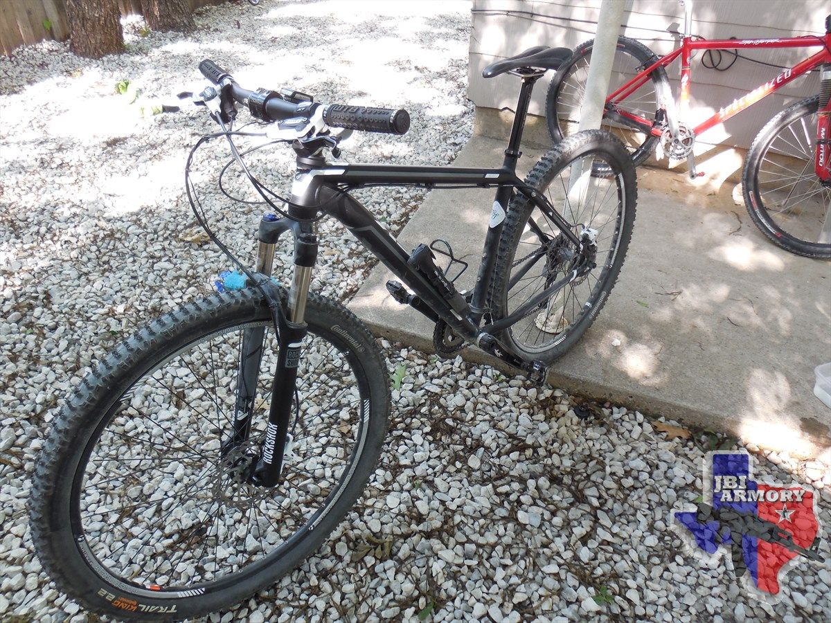

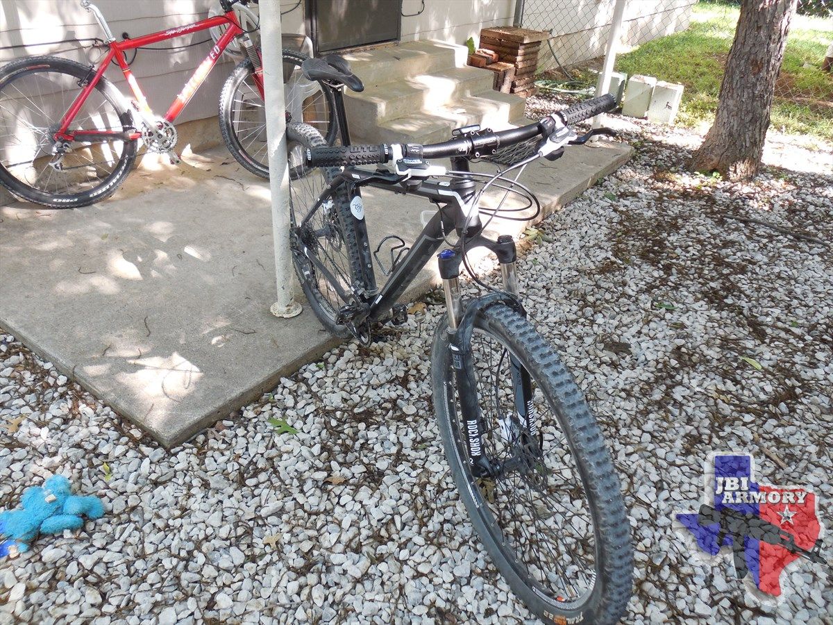

    jroberts1968
    Anyone know what the factory 2013 19" Mamba is? I started the build up
    XT cranks 2-10 40/28
    XT chain
    XT front mech
    XT rear mech
    XT cassett 1-10 11/36
    XT pedals (inbound)
    XT 2-10 shifters
    Thomson post
    Thomson clamp
    Thomson carbon flat xc bar (inbound)
    Thomson x4 stem 100mm 10deg rise
    Selli Gl Flow Carbon Seat
    WTB Clamp Grips
    Manitou Tower Pro (Inbound)
    Hope pro evo 2 hubs (inbound)
    Hope skewers (inbound)
    spokes DT Swiss w/brass niples (inbound)
    WTS I23 Frequency wheels (inbound) W/stans valves and tape
    Conti X Kings 2.2 Protect Black Chili
    I'm hoping I can get this below 28.5.
    I been using a spread sheet to keep track of the weights as part came off and on. I forgot to weigh the bike prior to starting. I wasn't going to worry but once I started weighing things it was cool and now is a addition. I have been riding for 20 years and have never weighed parts but ts fun to do.....
    My old Stumpy, Shock is wasted that's how I ended up with the Mamba.
  • 05-22-2013
    _Alberto_
    Don't recall exactly. It was approx 30.5lbs no pedals for a 19"
  • 05-24-2013
    jroberts1968
    Well Just installed the
    Tower Pro
    2238g RockShox XC32 w/coil spring
    1718g Tower Pro after I cut the steer tube & installed lower race
    That's 1.14 lbs
    Thomson Carbon Bars are just plain awesome.
    Wheels should be in today. When replacing the fork found the headset seal was torn from incorrect install or adjustment. When I test rode it the HS was popping as if out of adjustment, They rolled it in and re-adjusted it but I think the seal was broke at that point. I'm thinking, a hope or king HS in in the future.
    Wheelset installed.
    Published weight 31.0
    Actual after upgrades w/pump & cyclometer 26.2
    I have a Hope HS, Skewers, and XT pedals still inbound

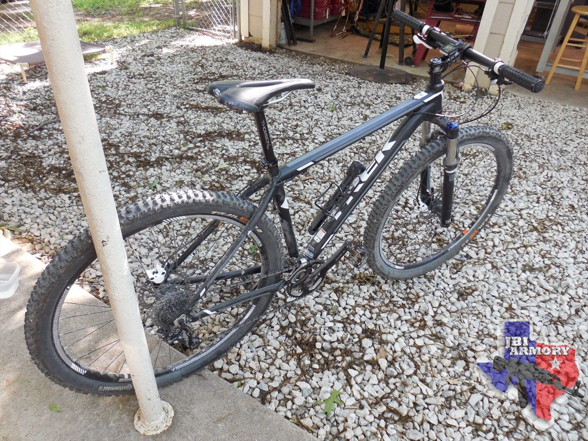

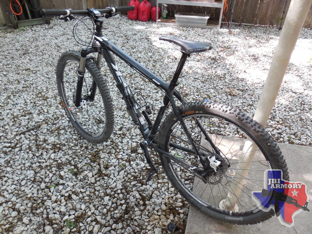

    Never owned a set of hopes always ran XT hubs, wow I like the noise as well. In TX we have a lot of Hike/Bike trails and it will let em know I'm coming!
  • 06-01-2013
    jroberts1968
    Tower Pro
    That's 1.14 lbs
    Wheelset installed.
    I ended up installing 785 XT disc brakes Set w/Ice Tech Rotors, King Inset 1 headset.
    25.7 lb the bike is really great climbs and descends awesome.
