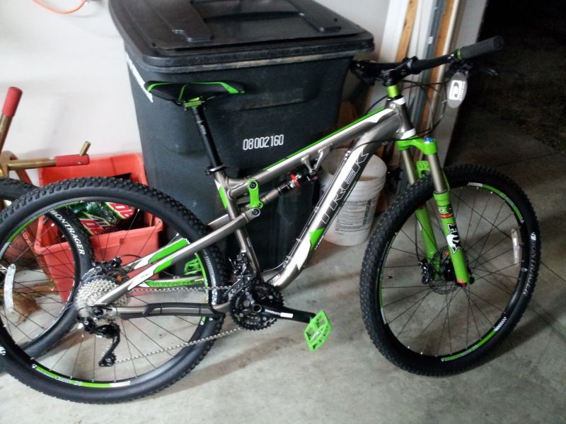

    My 2013 Elite
    Here's my Rumblefish Elite. I've been riding it sense December and I just love it. The only mods for now are Oury green locking grips and setting it up 1 x 10 with MRP chain guide. One if the best mods was setting up the tires tubeless.

    My 2012 Elite, still enjoying her. Sorry for the bad image quality...
    2013 rumblefish-2013-05-17_19-19-27_890.jpg2013 rumblefish-2013-05-17_19-19-56_874.jpg2013 rumblefish-2013-05-17_19-20-12_538.jpg
