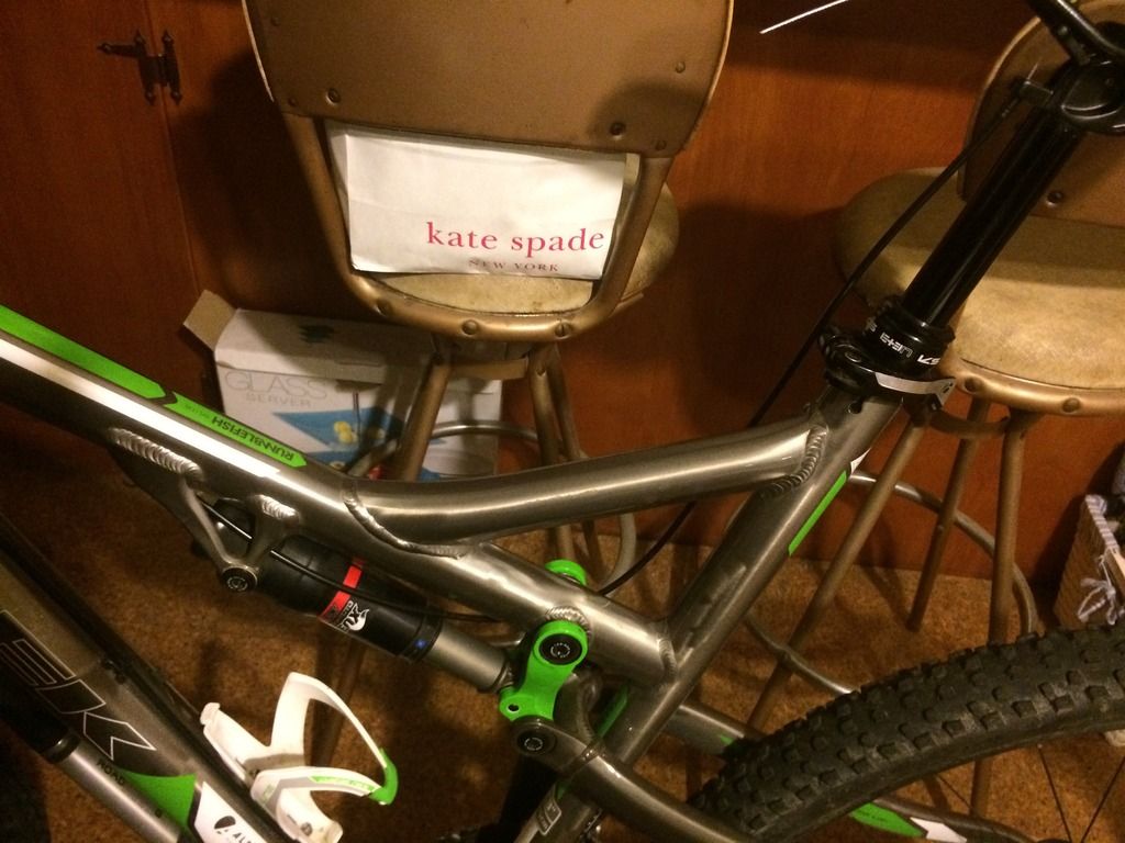

    I love my 2013 Rumblefish Elite, added the Fox dropper post. Next mod will be tubeless tires, not real happy with stock tires that came with it. But this baby can climb plenty more than my legs can I wasnt sure about the color combo either but it has grown on me.

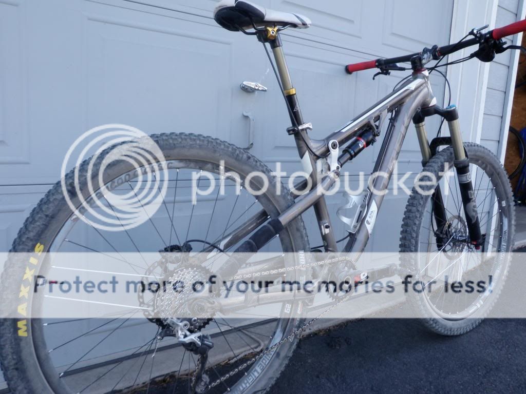

    Here's an update in regards to my update addiction but the results are fantastic. After adding the FOX 34, dropper post and beefy tires my beloved Rumblefish had turned into a pig while climbing. I just installed lighter tires, American Classic Wide lightning wheels, XO carbon cranks with direct mount Wolfstooth 30t, GC 42t, removed front derailleur & shifter!
    These upgrades have TOTALLY transformed my bike! It is much more lively and not just for downhills anymore!! The wheels hold a line better with the added stiffness and spin up much quicker. LOVE IT!!!

    made a couple of upgrades to my fishy recently, and wondering if anyone has found any extremely wide green handlebars with a high rise?
    I swapped to a set of silver alloy 780mm wide bars that have a small rise, and they feel great but I think I'd like even more rise, and would prefer the bars be green to match the bike a bit better
    Swapped in a KS Lev eten dropper post, and I like it for the most part but it does return to full height quite slow, nbd though.
    Also got rid of my 2 sided flat/spd pedals and fully committed to spd. I think the weight reduction from the pedal swap made up for the dropper post gain, hah!
