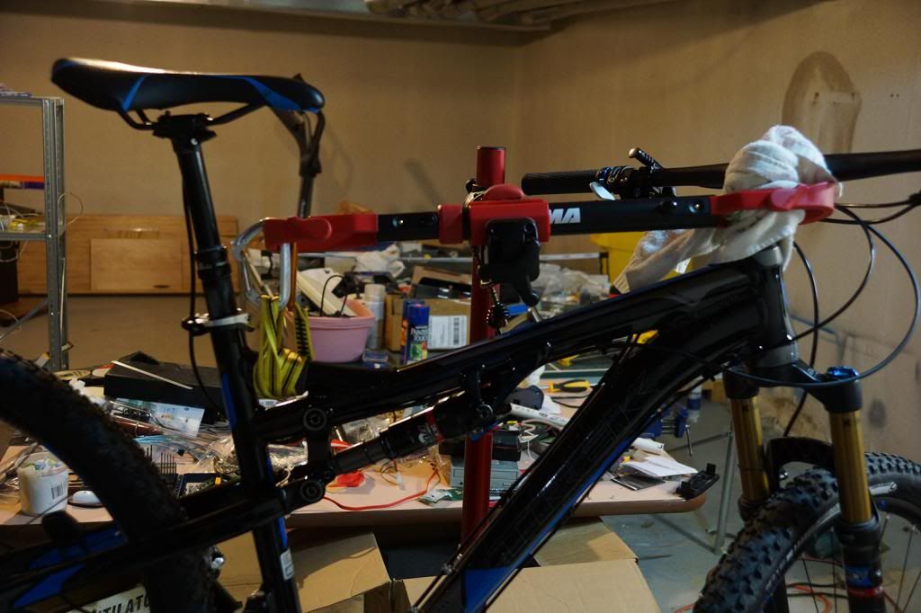

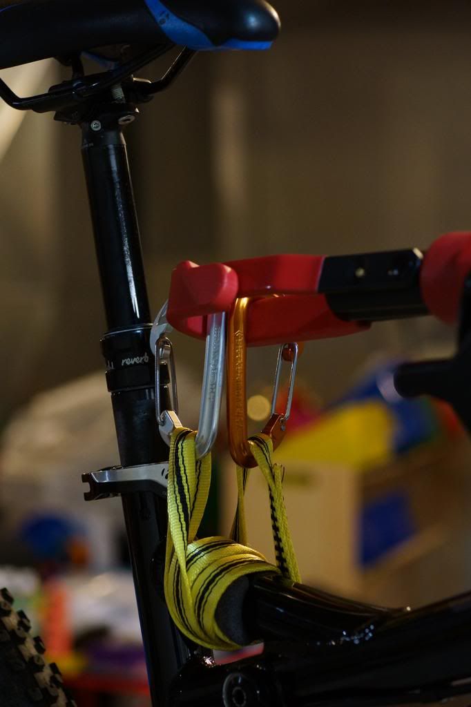

    I love my 2013 Rumblefish Elite, added the Fox dropper post. Next mod will be tubeless tires, not real happy with stock tires that came with it. But this baby can climb plenty more than my legs can :thumbsup: I wasnt sure about the color combo either but it has grown on me.
    Attachment 844792
    Attachment 844793Attachment 844794
