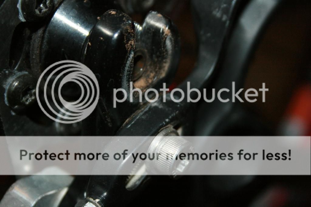

I spoke to the Trek rep yesterday and he is not offering to refund the cost of the frame, however he is offering to send replacement parts that he says will fix the problem.
I have a few issues with this.
1. The replacement parts were supposed to be here last week.
2. I have spoken to others including bike techs that say the replacement parts do not fix the problems completely.
3. Trek has denied any knowledge of issues with the 2012 Rig and said that my case was the 1st they had heard about it. But yet so many others have had the same issues and I was informed that Trek is working on developing replacement parts to fix the problem, but apparently, according the their emails to me they have NO knowledge of anyone else having issues with the 2012 Rig. So I was blatantly LIED to by Trek about a defect in the frame design that could have put me in danger.
To top everything off I informed the rep that I have heard of others with the same issue with the 2012 Rig getting a refund for the cost of the frame. He did acknowledge that they did that for 1 person and he said that it was only because it was extenuating circumstances, however he did not go into detail of what these extenuating circumstances were. He preceded to say “we did refund the cost of the frame to one individual in Tucson and now that person in BLABBING all over MTBR about it”
I would like to say to Trek… MTBR is a review site for consumers to share information. So “BLABBING” on this site is kind of what it is intended for. I am sorry the “BLABBING” has conflicted with your agenda to produce low quality defective products and cover it up and deny it.
Thanks Trek! I will never own or indorse your product.
I think it would be in the best interest of Trek to modify there warrantee program to state, "Any posting on MTBR forums of any failure or warrantee issue will automatically invalidate all future claims for said issue regardless of the claims validity"
Surely you jest. This situation is a little like a problem I had with my Madone 5.2 road bike. I got the bike then had weird shift problems a few days later. Trek contacted me after i filled out the survey they sent about the purchase. I explained in great detail the problems and they pretended like it was only me having the problem. I started looking around and found out I was not alone. Luckily after about 8 different trips to the bike shop they got the problem fixed. It was not easy and Trek was not helpful. I like the bike now but for a while I nearly took a sledge hammer to it.
For that reason, it's great we consumers report problems. Also, this issue looks a lot like a latent defect. I predict a recall will eventually be the result. Wheels flying out of dropouts is a big eff up.
Trek knows about this problem. Slam the dropout forward and get at White Industries Eno hub. It's a lot of money to fix such a stupid problem, but it should work. Guilt your dealer into helping you out.
The 2011 and the 2012 Rig frames are the same, just different paint. My boss tried everything Trek told him to do but the dropouts still moved. He's only about 175lbs. Trek replaced the frame with the new 2012 Superfly SS. Look for a frame with horizontal drops. I ride a Surly Karate Monkey and have never had an issue with the wheel slipping.
Just to post an update. I spoke with Trek again today and he said their engineers have developed a part the "might" fix the problem. I reminded him that it is actually 4 problems with the design defects on the 2012 Trek Rig (de de dee). The part he said would help keep the slides from slipping, but I reminded him that it won't do anything about the axle moving inside the dropouts and the skewer coming loose. He offered to send the part out for me to try it to see if it works but I declined because I have already broken the Rig down to use the parts to build up a new frame.
He said they are not willing to replace the frame, but he offered to send a Trek jersey and some bontrager tires. I chuckled as I said "I would not wear a Trek jersey after all this". They can keep their cheap tires too.
It has also been brought to my attention that the 2012 Trek Marlin is the same exact frame as the Rig and there have been the same issues with Marlin as well. This review the persons wheel actually falls off. This has happened to myself and others with the Rig.
Bottom line is this is a clear defect in the design and hardware on the 2012 Trek Rig and 2012 Trek Marlin. Trek is refusing to notify their customers of any defects which causes the rear wheel to loosen and fall off during a ride. They are still trying to deny it in till you call them out. I have spoken with an attorney who has handled and won cases against Trek in the past. Apparently this is not the 1st time Trek has been forced to recall and product.

How does a wheel fall out of the dropouts? Only way I can see is one of two reasons. 1. The skewer broke (Rare) 2. The skewer was not tightened correctly (Owner Fault).
Or the design of the dropouts do not allow enough contact between the two surfaces and the axle actually moves around inside of the dropouts. Over the course of a ride, even if the skewer has been tightened down properly the movement causes it to loosen. If not caught or constantly tightened every few miles it will become so loose the wheel will actually fall off. (Manufacturers FAULT!)
