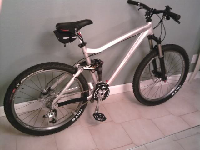

    So a friend of mine had the BBG inner bash and I decided to test fit it. The problems that were mentioned on another thread was indeed verified. Took a dremel and grinded down the inner circumference so it wouldn't interfere with the frame on the bb. Was thinking about grinding the outer circumference of the bash but decided to just bend the bash slight inward towards the chainring. I think if I dremeled it, I would've had to take off a good chunk of it. It would defeat the purpose of the inner guard as I think there won't be as much of the guard left to hold the chain on. The bend method isn't the prettiest when your looking at it dead on while the crank is spinning but it did the job nonetheless and chainstay clearance isn't an issue anymore. The chain does rub slightly in the 2 lowest gears and I can hear it but it's no real biggie for me. If it does get super annoying down the road I suppose I should consider other options. Ordered the BBG outer bash so I will see how it all works out once that arrives but so far so good.

    I bent the inner bash in towards the chainring a little. Just slightly so it won't rub against the chainstay. Some parts of it I bent with a plier so it sorta looks retarded when your spinning it but only if you looks close. There's about 2-3mm clearance between the inner bash and the chainstay now, just enough so it won't rub. My chain is sandwiched in between with no room to fall in anywhere but the chainring. The inner bash does look a bit like ")"
    I took it out today for a test ride and had absolutely no problems. Only thing I worry about is if I do smash into something on the inner bash while I'm riding over something, It might cause it to bend back outward but there's nothing technical or much obstacles on my local singletrack so real worries there. I will try to snap some pics later on today if I have time and remember.

    134
    Couldn't get a good angle of the inner bash/chainstay clearance but here are the pics. It looks like it will touch in the pic but believe me there's plenty of clearance there. Btw, I'm loving this setup.
