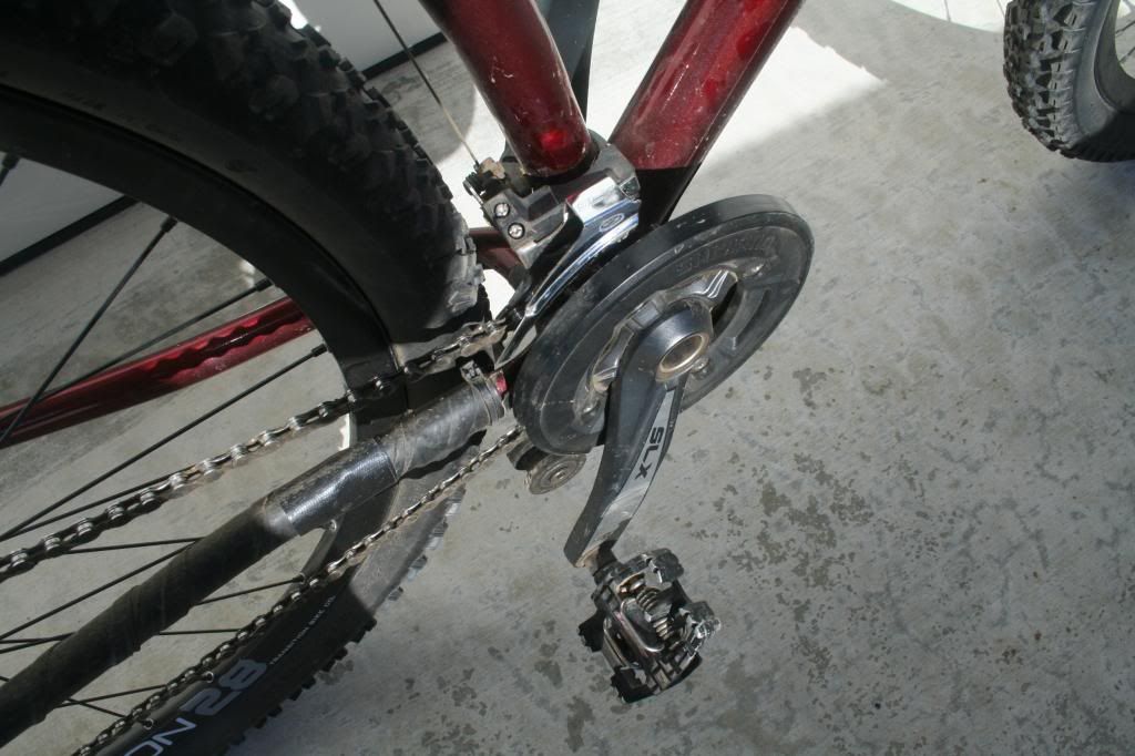

    Sorry to dig it up and keep beating this dead horse. Can you guys elaborate on the derailleur clearance issue? I've seen some FS frames that cannot clear the dual pull cable routing part of shimano front derailleurs but it doesn't sound like this is the issue.
    Are you saying that when the front derailleur drops into the granny, the cage comes too far inboard and will hit the tire? How does the low clamp help?
    Would the slx 665, the compact 2x9 front der, be the better option? If anyone can take a pic to help me it would be greatly appreciated. My frame will be here early next week and I'd love to build it up while I have time off work.
    I have a 2012 Transition TransAM 29er and I'm running it with a SRAM X9 nine speed mid cage rear der and a 22, 36, Bash Shimano SLX 9 speed crankset. I have a low clamp mount Shimano SLX 9 speed front der and an ISCG'05 Blackspire Stinger Chain Guide. I had no issues at all with the drivetrain and I road this bike hard almost everywhere in California, Nevada, Oregon and Arizona. I replaced the chain once and tires as well. I love it!

    Thanks el cap. Btw, are the rear triangles offset to the non drive side for extra clearance? If not, I have either an out of dish wheel, likely, or a misaligned frame. I did swap the wheel on backwards and it still looked to be offset on the non drive side. Going to bring the wheel in tomorrow and have it checked with a dishing tool.

    No, mine are not offset (looks the same on both rear triangles). I'm running a CTS Caballero EPS 29x2.25 tire in the rear and it looks like there is clearance for a 2.3. I would not go above 2.3 in the rear on this frame if you are running a front der. By the way, up front I'm running an On One Chunky Monkey Enduro 29x2.4 tire on a 140mm fork. Hope this info helps.

    Thanks el cap. My wheel was fairly out of dish. Got it sorted out now and all is well. Wish I would have gone with a 130mm revelation I was looking at instead of this 120 fox float. Oh well. Bike is ready for the trail. Can't wait to get it dialed in.
