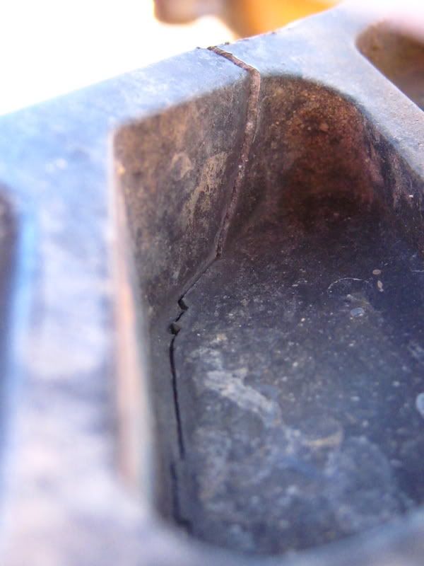

    Anyone else experiencing this on the top tube near where it meets the headtube?? I was seriously considering this bike till my friends cracked after just 4 months and he is a very skilled/finesse rider. Opinions??

    Frames crack, that is the nature of agressive ridding. transition stands behind their stuff and will take care of you. If you are really worried about it get a bottle rocket, from what i have heard only one has ever been warrentied and that was becuse some idiot over torqued and striped the chainstay seatstay bolt.

    well, mine did crack after about 6 months
    The frame is not exactly light, so this did surprise me! However, if you look at the whole thing, that part is kind of a weak point in the frame design. The forces from the shock enter the downtube right in the middle and at a rather steep angle.
    It was warrantied with no questions asked.
    I do a lot of jumping on it and will continue to do so, we'll see how it holds up.

    I've been quiet on the interwebs about my frame breaking... in the same spot. Unfortunately my turnaround hasn't been exactly speedy (no fault of my dealer on his end). I really didn't have a whole lot of trail time on my frame and I was just getting used to it when I noticed the crack. A real drag, especially when faced with getting another frame of the same design as a replacement. I love the frame, but the replacement won't be lasting long with the same issue.

    i have a feeling that if you don't bottom it out too much, you'll be fine.
    Maybe a shock with adjustable bottom out resistance would help, too. My Van R doesn't have that, so even though i run a rather stiff spring for my weight (500# for 160# rider), occasionally you hear a "clunk".
    My replacement frame now has a piece of tire glued to the seattube as an additional ghetto bottom out bumper :P (the rocker did touch the seattube a few times on bottom out). Haven't been able to ride it yet, though.

    lol, this kinda reveals the reason why you cracked yours...and I'd guess that this is also why transition don't offer the frame with less than the DHX5 (hence the bottom-resistance acting as frame protector).

    yeah, but it's not like i'm hitting rock bottom on every jump, more like maybe one bottom out per day, so nothing unusual there - can't avoid that when jumping..
    You are probably right about the DHX 5, i was thinking the same thing.

    IMO, the singular shock tab pair as seen above is sub-par on heavy duty frames. On lightweight XC, they might be ok, but depending on the angle of the forces they see, they tend not to be incredibly reliable for heavy duty usage. There are notable exceptions, however, but I'm more in favor of the kind on Titus bikes, where the tabs are part of a plate that is formed to the tube it is welded to, then the weld goes all the way around this plate.
    Fortunately, Transition is a good company, so I think many will be treated well. They seem to know how to treat customers.

    then your suspension is set up too stiff, or you have a shock that ramps up like crazy. The preston only has 5" of travel, and i prefer to use at least most of that when riding, which also means that it will bottom out once in a while.
    I'm 160# and I'm running a 500# spring, which gives me only about 20-25% sag. If the spring was any stiffer, I could just as well go back to a hardtail.

    the preston seems to have a fairly linear linkage, and mine came with a Van R that doesn't have bottom out resistance.
    I think your demo is progressive to start with, and then you have a DHX 5 with adjustable ramp up on it, (plus it has 2 additional inches of travel!) so it must be almost impossible to bottom that thing out.
    as mentioned above, this might be why they stopped selling the preston with the van R.

    I bottom my 06 Preston with a Roco Air once a ride or so, depending if I am mashing on it or not. I have seen several 07 Prestons crack personally, and not just at the shock mounts. I think its a problem with their heat treating on a batch of the frames and not really what shock you are running.
    Keep an eye on shock mounts, the BB junction and the top tube just behind the gussets.
    Check, check and check: all cracked on mine, sent back for replacement.

    Does anybody else feel kind of disillusioned about Transition because of this? I mean, I could have saved several pounds and gotten a different frame, but I got the Preston because I thought it would be able to take some abuse. This cracking issue, along with various other little things, makes me question their engineering. They're a small company, maybe they don't have the sophisticated stress analysis software that bigger companies do, and they certainly have other merits as people and as a company, but I'm not sure my next bike will be a Transition. Please don't flame me too hard. Just wondering if anyone else is starting to feel this way...

    Then again, the Transition Bottlerocket is probably the most-abused-yet-least-broken frame i know. They definitely know how to built an almost unbreakable frame, I'd just say they underestimated what people would do on the preston.
    My guess is that it'll get an updated main triangle soon with a different lower shock mount gusset (spread the forces between toptube and downtube, see blindside?) or something, then it'll be fine. I hope they'll do that, because i really like the bike.
    I know a guy with a 06 or 05 preston, he rides and jumps quite a bit more than i do and the frame is doing fine...
    Also [insert the usual "all frames can break, no matter who makes them" blabla]. And, (another guess) we'd be surprised how little stress analysis some of the "big" companies do when designing frames...

    Somehow having a frame crack from all of the front triangles joints does not seem like a problem with the design it self, rather a manufacturing process gone bad.
    It would be nice to hear from Transition what their take on the issue is, but I guess that won't happen. They probably still hope wimps like me don't break our frames and save them a bit of money comparing to changing all Prestons sold from a rather big batch.
    I seem to have gotten my Preston in the beginning of June, so it could be from the same batch, seemed ok upon quick inspection yesterday though.

    clould be, but not necessarily. One crack can quickly lead to more cracks in quick succession, as stress on the remaining joints increases when one of them (partially) fails.

    I don't know if its a design issue. I know two people who cracked 2007 Prestons, both within a month of purchase, both at the shock mounts and both were riding (admittedly) beyond the intended use of the bike. I think the problem is that this is NOT a true freeride bike, and people are treating it like it is.

    just found cracks on mine at the front shock mount. looks like I caught them early.

    Snapped Chainstays
    I just snapped my 2006 Preston on Monday. And I mean snapped!! Both chainstays broke in half. Now I have a folding bike!! I have emailed and called Transition and I am hoping they will take care of me. Its been rock solid until Monday.
    Funny thing is, it snapped when I was descending a rocky, rooty downhill on an XC trail. Nothing serious. I am guessing its just repetitive stress as a result of two years of riding. I am an aggressive rider but I only do light freeride, 3 and 4 footers, all onto transitions. Certainly no 20 foot hip jumps on my end...

    Just had to check your picture with my frame. Those are the older shock mounts, I have the new redesigned ones, they appear like they'll be able to take a lot more loading in this area. "sigh of relief".

    yep. they replaced the front triangle with an 08 with the update shock mount.

    A dude was selling me his preston fr.
    I was about to pull the trigger when:
    I noticed the cracks at the last minute. He said he was unaware of them.
    Will these lead to imminent catastrophic failure?
    Cheers
    Attached Thumbnails Attached Thumbnails Preston FR Frame Cracks-img_5711%5B1%5D.jpg
  70. #70
    Reputation: Kyle509's Avatar
    881
    Well I certainly wouldn't buy it. It's failure may not be imminent but I wouldn't think it would be safe to ride the way it was intended to be ridden compromised like that. As you can see, that's where this generation of Preston frames had an issue.
