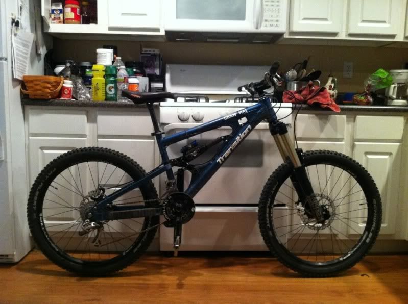

    Lets see those blindside v5's!
    Starting with mine, got a great deal on a new 2011 raw medium and just finished building it up:
    Rockshox domain RC 180
    halo combat rims/Transition,Hope hubs (built by me), spec. Butcher 2.5" tires
    saint brakes
    slx cranks, 2 x 9 drivetrain
    35 mm raceface stem, answer dh handlebar
    38 lbs, i think.
    Built it up as more of a long-travel, heavy duty do-anything bike i can climb to the top, than a dh-only rig. Which I think is Transition's intention with the current iteration of this frame. Took it out for a spin today, kept it mellow as im still getting over a bad cold and still feeling out of it. Considering how plush the suspension is on the dh, Im surprised by how well it pedals, at least as good as the '08 Bullit (cracked rear triangle) it replaced. But this bike is lower and slacker:thumbsup: Glad to join the transition family, I think I made a good choice.

  • 02-17-2013
    dwyooaj
    Originally Posted by scottybinwv View Post
    Hey guys, I am looking into setting up a Blindside with 650b hoops/tires. Can anyone post up pics of the seat to tire clearance at full travel? Or has anyone done the conversion.
    This bike looks to be the AM killer I have been searching for. Got an email into Transition but have not heard back yet.
    Any word on 650b compatibility? Heres an idea ive been toying with, assuming 650b capability in short travel setting:
    put in a shorter shock (8.5" x 2.5")
    run an xfusion slant 160 in 650b mode (545 a-c height)
    650b wheels with big tires like hd's.
    Geometry for a med will be:
    65 head angle
    73.5 seat angle
    45.56 wheelbase
    13.8 bb height (depending on tire size)
    6.45" rear travel (short travel setting)
    so with the shorter shock and shorter fork, and bigger wheels, it brings it back to stock geo (except for bb being just slightly lower) with the bigger wheels.
    Expensive experiment though.
