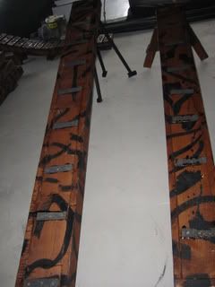

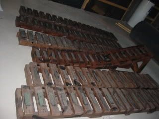

    i've done this for a while now and it has help up on some dimensional wood features for over 10 years. i cut the shingles into pieces about 3" wide. coat the bottom of the shingle with a quality roofing cement. then nail the shingle down with galvanized roofing nails. i use around 4 nails.
    some ramps that i built for a local trail
    oh, i always stain/paint the features that i build, as well as using an outdoor construction adhesive. it costs a little bit more but the features last.
