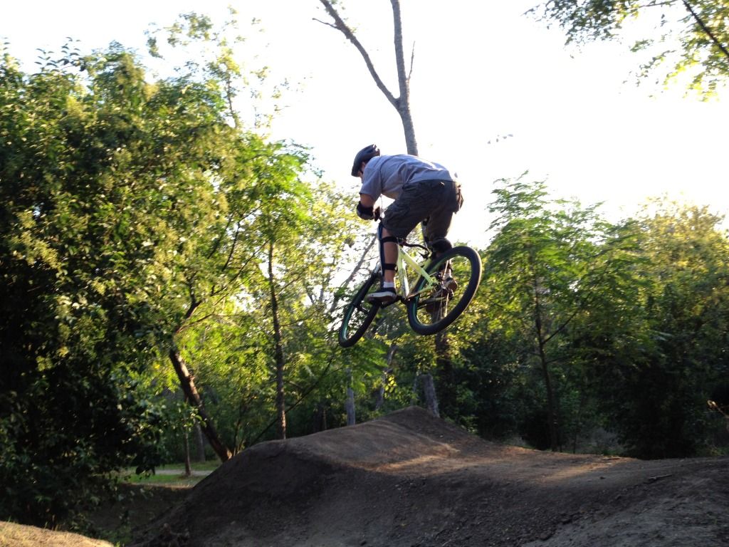

    Jumps can be rolled over OR boosted. Typical bmx/dj spots have gaps that do not allow for people to just roll them.
    But most of the time on pump track jumps, people stay relatively low and just flow. Ken here. He's over 40 and just getting back to jumping after 20 years away:

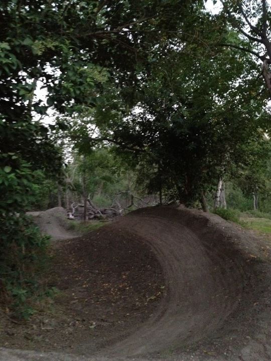

    Berms should be adapted for the speed in a particular section. A wave style berm like this soaks up some speed, while allowing for a flowy turn. A tight radius bowl-corner style berm is better, though, when you're needing to "whip" out of it--especially when turning to go back up-gradient.
    Wave-style berm:
    These riders are pumping these rollers through the trees, slightly upgradient. (Walnut).

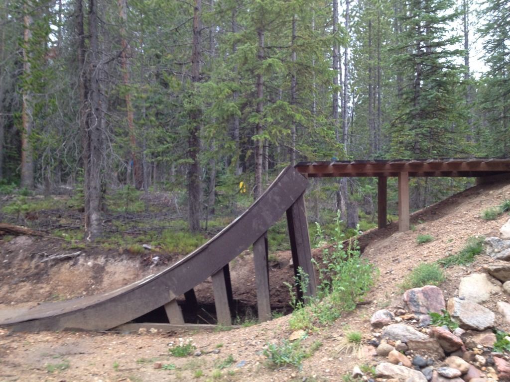

    These type of slant banks are very easy to make and might be something you could do within a low budget. I took this pic at Whistler:
    Since your land is on a slant, you may want to have trails that criss- cross that slant in a switchback style manner. This will give you the opportunity to have cool berms, some of which can be dirt, while others can be lumber:
    I took these pics at Winter Park:
