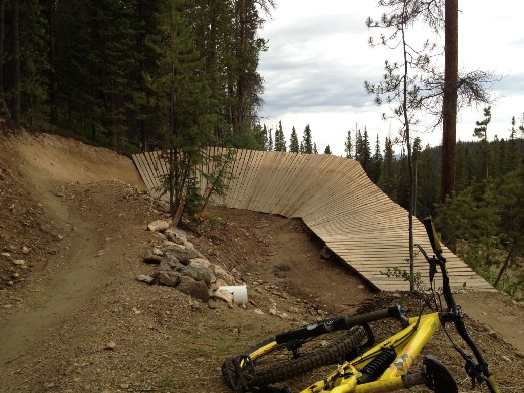

    Hi robe
    I hope these pics are helpful. I thought this skills park was really cool. I was on a road trip. The little hill is probably 8m above the pump track. The dimensions are otherwise pretty obvious in the pics. Lake Crackenback Resort also has really nice singletrack and trout fishing and pizza and a bike shop.
    First the signs
    Next the beginner area with some idea of the flow
    and the tougher features including the lovely and tricky rock pile that looks natural and feels like it was all built to be really testing. From the rocky knoll features lead off (or up) in various directions all linked to other features. Very cool.
    http://forums.mtbr.com/attachment.ph...1&d=1352369686
    http://forums.mtbr.com/attachment.ph...1&d=1352369916
    http://forums.mtbr.com/attachment.ph...1&d=1352370247
    Continued next post

    cmc4130
    Originally Posted by pinkrobe View Post
    A little bit of progress. We were able to talk with the City, and the park/community liaison has agreed in principle. Still no funding, and no public announcement.
    I don't imagine this design will stay as is. The advanced lines on the left may not allow for enough speed to hit that first jump line unless there's a significantly elevated start point. The directions of some of the intersections will need fixing for sure, and I have to come up with some tech features to fill in the gap between the beginner section and the intermediate section. We are limited by the height of the wooden features. I suppose we could build the wood rollers and A-frames with piles of dirt under them to reduce the fall height. Hmmm.
    As for tech features, like A-frames, YES. And, yes, I say absolutely add dirt to reduce the fall height. Do not let arbitary height restrictions reduce the basic functionality and radness..... Sometimes compromise is okay. But sometimes, compromise leads to a watered-down result that is no longer cool. And if it's not cool, it will end up not working as a destination spot.
    My buddy was originally talking about this being 3 feet high... I convinced him to go for 5' high, and it turned out way better. It was intimidating for some riders at first, but now everyone loves it. And it's just one basic thing.
    Another thing on perceived risk and height--sometimes people think the taller something is, the more advanced it is, and therefore, beginner stuff should be short/low. This can be a fallacy. Small obstacles--jumps in particular... can be more abrupt when they are short. By basic geometry, as well, there is less horizontal space to land on landing that is a short triangle than a taller one... Angles and speed are more related to beginner/intermediate/advanced than is height. A tall but mellow jump is actually easier for a beginner than a short steep one.
    I originally proposed the feature, by showing a pic of this build at Keystone... We changed the shape of the center section somewhat to make it easier / less intimidating to xc riders who weren't going to gap it....
    Pace Bend . . . . opportunities - Page 7
