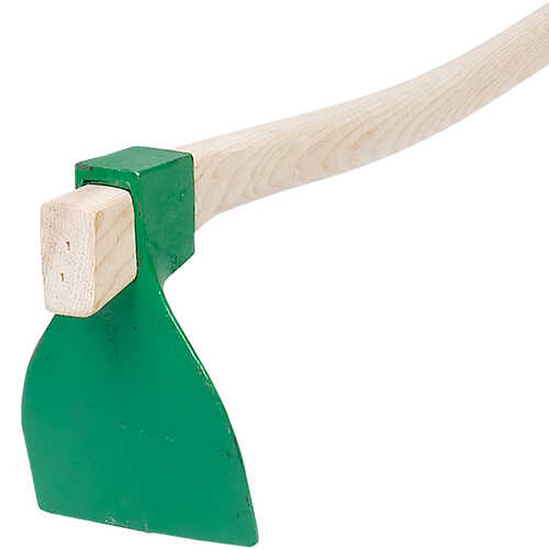

    I've been thinking of getting a Rogue Hoe, and I like the wider 80R. For what I'll be doing I won't need a rake, and I can leave an old shovel at the site.
    But a fancy hoe is a bit expensive to be leaving out at the trails.
    I've thought about the EasyDigging Italian Hoe which is 8" wide and would ship to my door for $38.
    However, it's got a traditional wedged handle. That means once its attached, its not easily going to be removed.
    The Roque Hoe 80R, is a bit wider, $10 more expensive, but utilizes a square handle mount that doesn't pass through the blade. That means the handle must attach with a fastener. If this is the case, can fastner be easily removed? Or is there glue involved?
    If the Rogue requires a fair amount of work to attach and remove the handle, I'll likely go with the cheaper Italian Hoe (lol).

    I have an 80R and it would be difficult to take the handle off.
    I also have a Hazel Adze Hoe that might be more inline with what you want.
    The handle can be easily taken out of the Adze eye.
    The Hazel Hoe blade isn't as large as the 80R and the handle isn't as long but it is still a great tool.

    The handle is a very tight fit (might have glue) and one rivet through. If you got it loose enough to remove, there would probably be play in the head that would be at best, very annoying and a worst, dangerous.
    It's not too bad to carry the short curved handled ones in a pack while riding. watch your head room though.
    I have an Italian hoe and I find the curved edge on the rogue to be far superior to the straight edge on the Italian Hoe. If you're thinking of getting the Italian hoe, try one out first if you can.
    P.S. You'll want the curved hickory handle and you WON'T want to leave it out in the rain.

    I've rehandled a rogue hoe and its tough, they really lay the glue to the handle. We were welding a piece of plate steel on one side to drive falling wedges, and we ended up demolishing the handle getting it off.

    I'm interested in the longevity of the handle not installed by Rogue. If a handle installed without all the glue will break more quickly.
