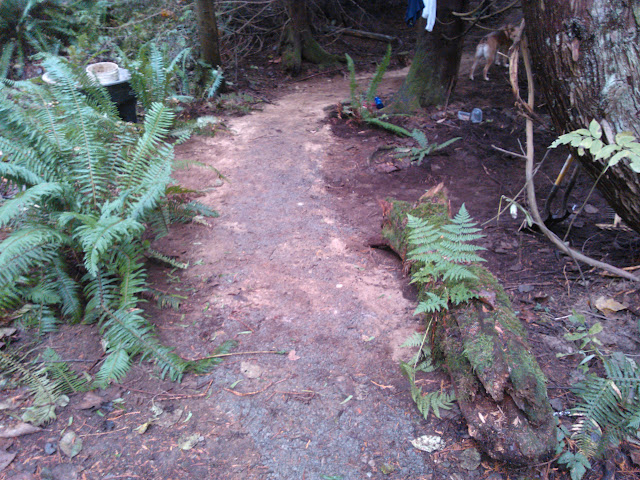

    I think that turfstones are a fine option when all else fails. This winter we have been working on a trail that has a seasonal stream...really just a hillside that weeps water in the winter and there is no place for the water to go except onto and across the trail. In mid-winter that section of trail would get 6-12" deep in water and mud.
    With no re-route options, and no easy source of rock for natural armoring we brought in turfstones and used those to armor up the stream crossing.
    After we put the turfstones down, we covered them with a layer of native soil and gravel and replanted ferns and moved logs alongside the trail to keep traffic centered onto the turfstones and to hold everything together.
    Now the water flows over the top of the trail and the turfstone provide a solid base for bike/hike and horse traffic.

    Woodway- Nice work, it looks great.
    You can also stain the block for a better color match to the native soil.
