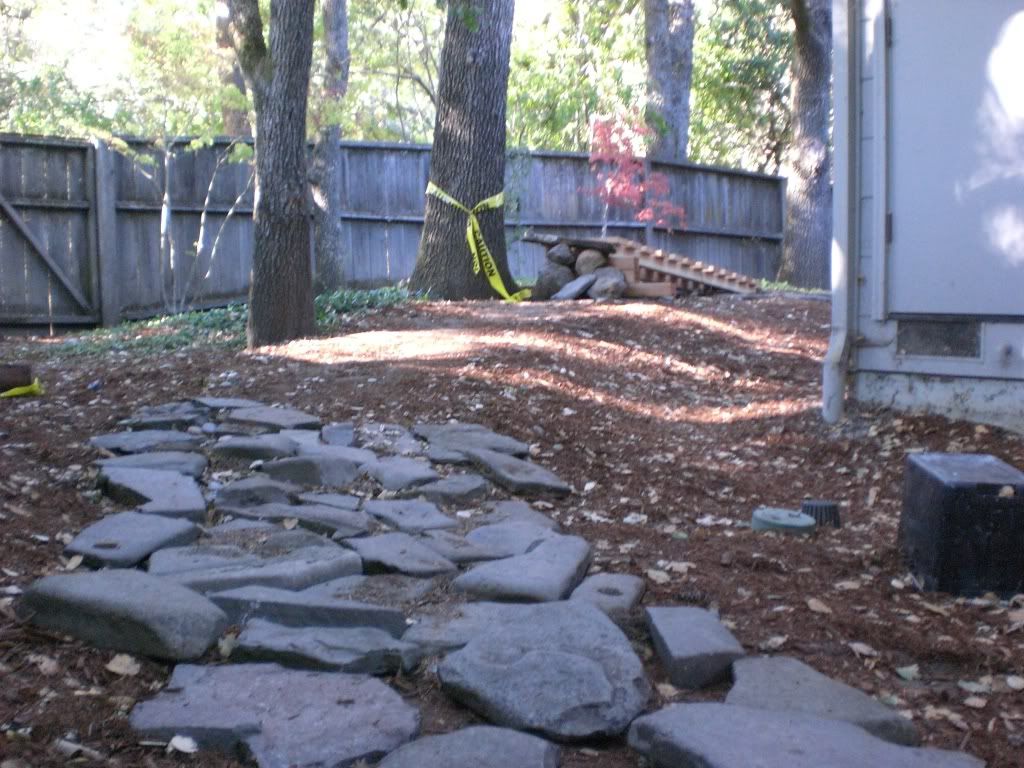

    I was tired of riding 2-3 miles after a long school day to get to my favorite FR spot or trail, so I built a small trail in my backyard. It consists of two ladder bridge drops, a tricky rock garden with a small jump in the middle, and a berm.

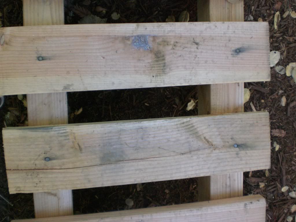

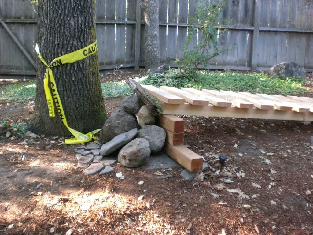

    2. A ladder bridge should have two bases normally made of long pieces of 4x4. After you Cut the base pieces, you should cut planks and nail them on top (see pics).
    3. Place your ladder bridge (without the supports or stilts, just the ladder).

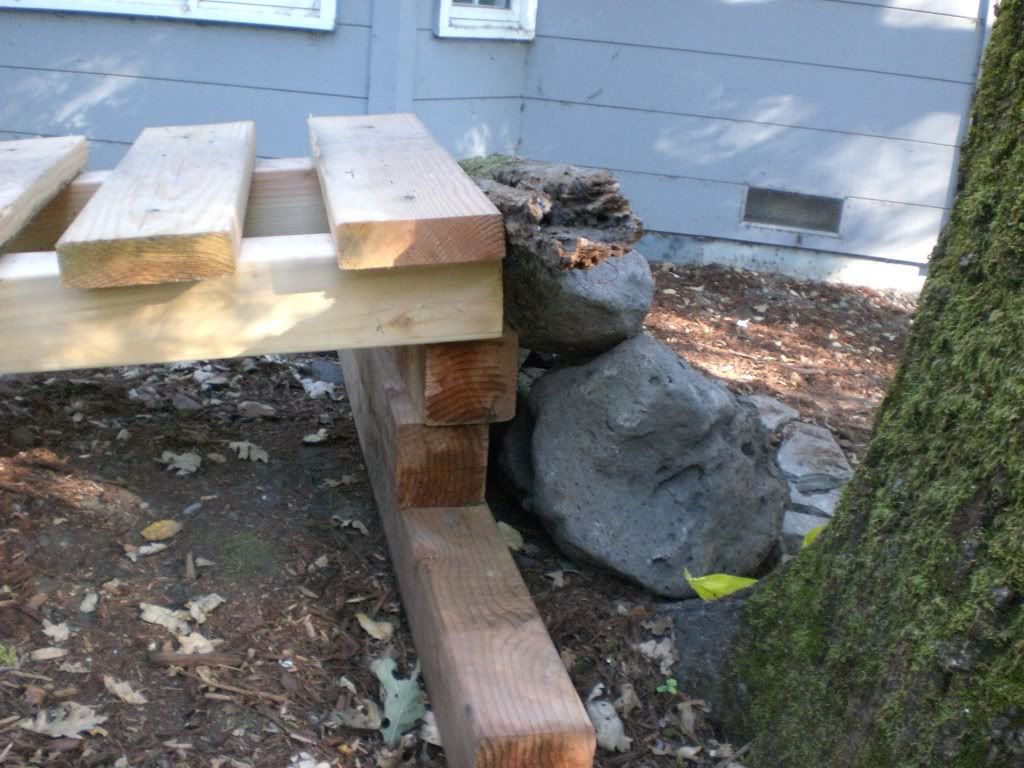

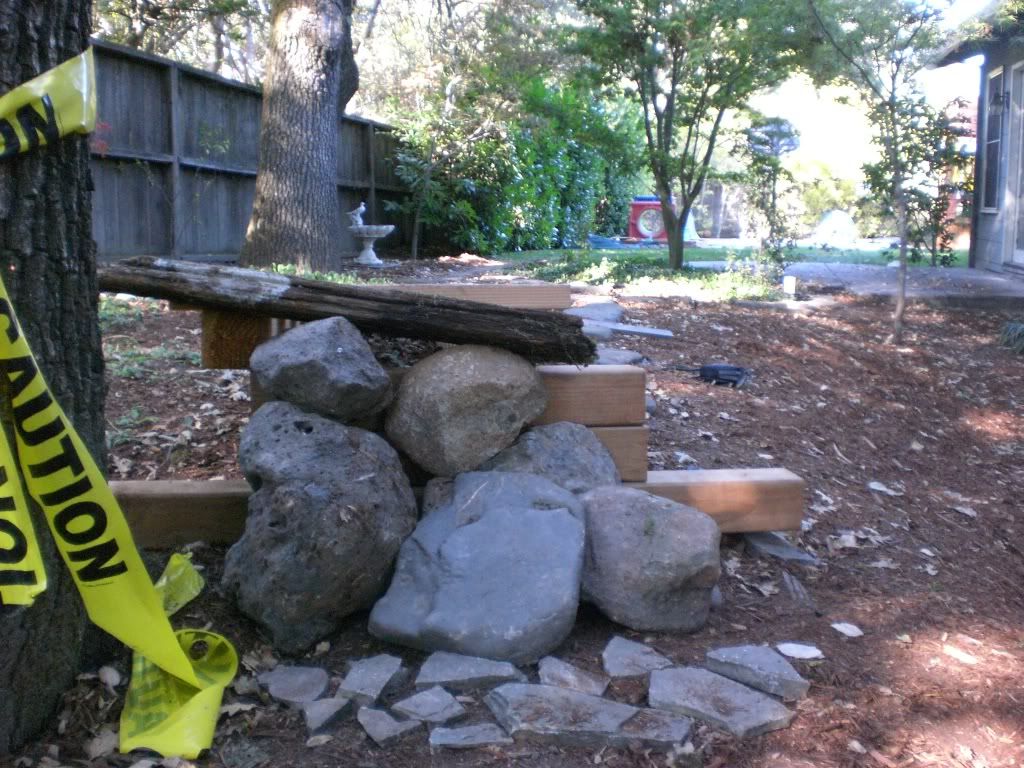

    4. Depending on the length, you might not need supports in 2 or 3 different places (like mine), so what i did was get 4x4s and stack them for the supports.

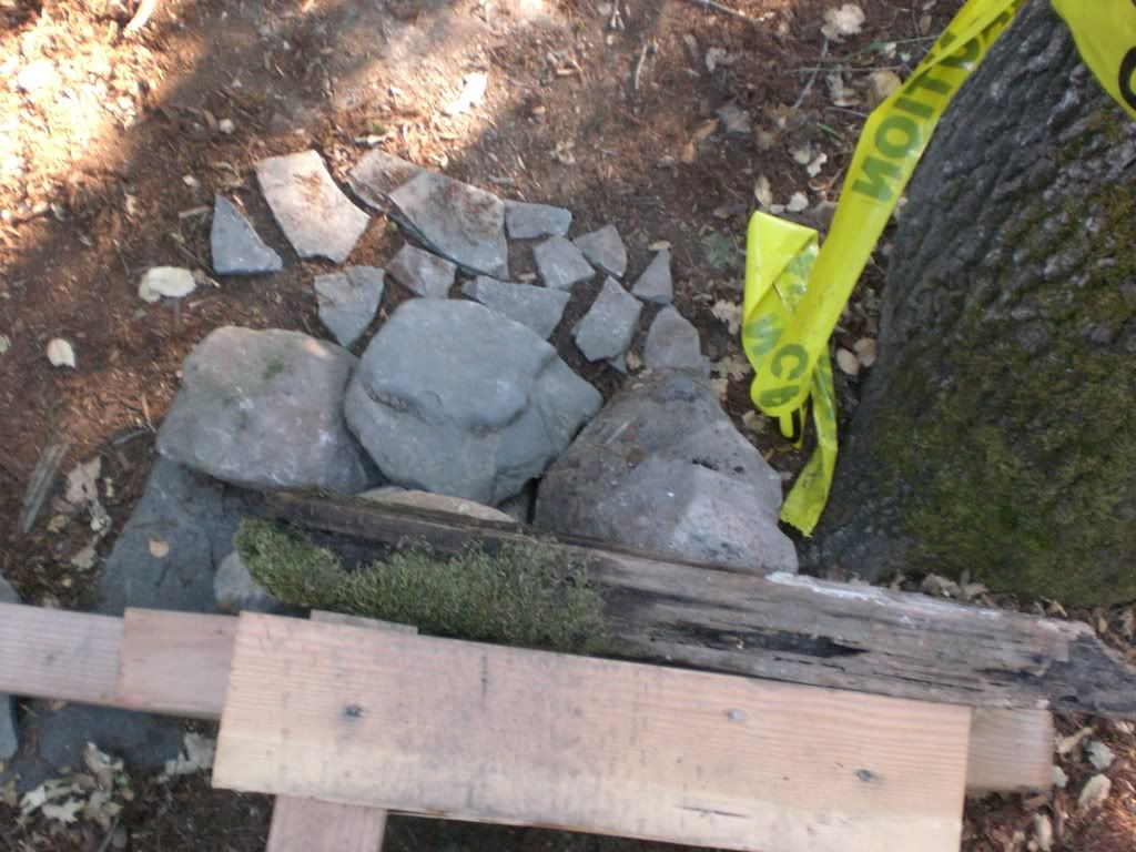

    5. As you can see, on my ladder bridge, I put some rocks and scrap wood by the base to make it look natural (it didn't really work, but now you have to clear those rocks).
    For the rock garden:
    1. Place your rocks.
    2. Try to make the sizes uneven so its harder to pass through without it getting bumpy and technical.
    3. To make it even more technical, bury some rocks halfway, and leave others loose to give it a sketchy feeling.
    4. Then, finally, scatter some gravel or small rocks around the rock garden to make it look more natural.

    should use screws instead of nails....they'll hold better

    thanks, yeah, i've noticed the planks have gotten a little loose....

    When in doubt, over-engineer. Imagine what would happen if as many fat people as could fit on it all got on it at once. I use 5/8 PT lumber for decking with 2x6 stringers space 18" on center. If you go to your local Home Depot they will have standards for deck building which are good to follow.
    I like to use screws not nails as it's easier to take apart and generally stronger. I also like to keep stuff moveable as far as possible cuz you can keep playing with it that way.
