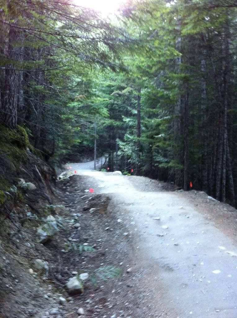

    Rollers (spaced around 22' feet peak to peak) on one of Whistler's flowier trails (I think it was Crank It Up)

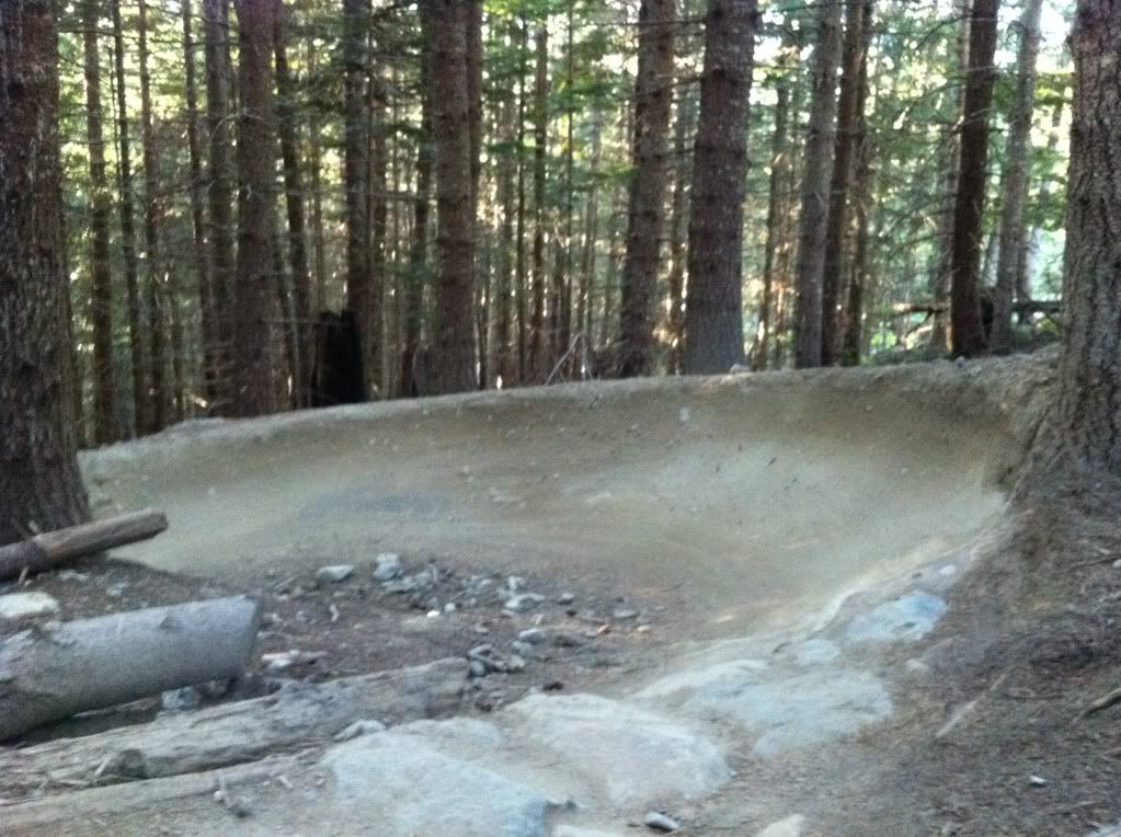

    Berm radius depends entirely on how much speed you have at a given point in the trail.

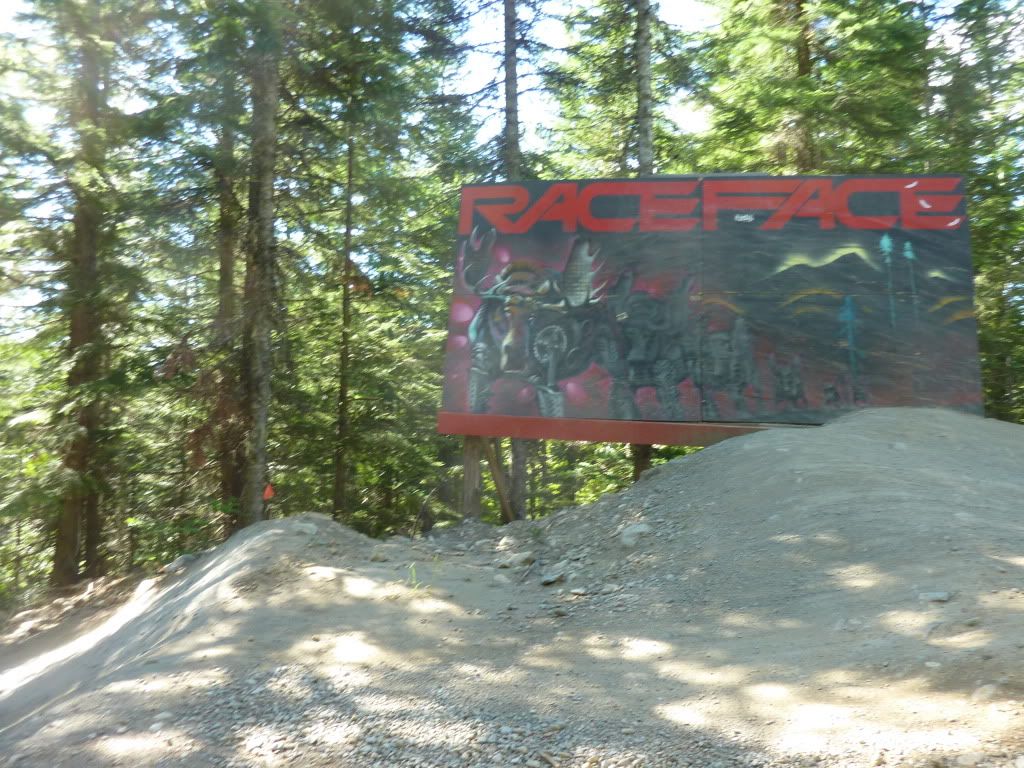

    Whistler:
    Wallride to landing. Whistler:

    Nice S berm at Keystone:
    High-speed 22-ish foot radius berm at Keystone.
    DH jumps tend to be around 20 - 30 degrees.
    20 degrees
    30 degrees
    Winter Park:

    The s-berm photo above is kind of what I had in mind for the middle third of the course, which is a traverse through a drainage, connecting two ridges. There are rocks and old-growth fir trees in there that we will attempt to incorporate. The top third will likely consist of a mainline of tabletops and such on an old skid road on top of a ridge, with rocky technical options off to the side. The bottom third will be tricky. Starts on a big, flat landing, so we've been thinking some kind of rythm section or something. Then it drops steeply through the trees to the end. The only way to get down with involve some switchback-type turns - getting down this section without killing too much momentum will be the trick. Must learn the answer too "how tight is too tight?"

    Edit: Love those keystone photos! Looking at them helped a lot with radius questions.
