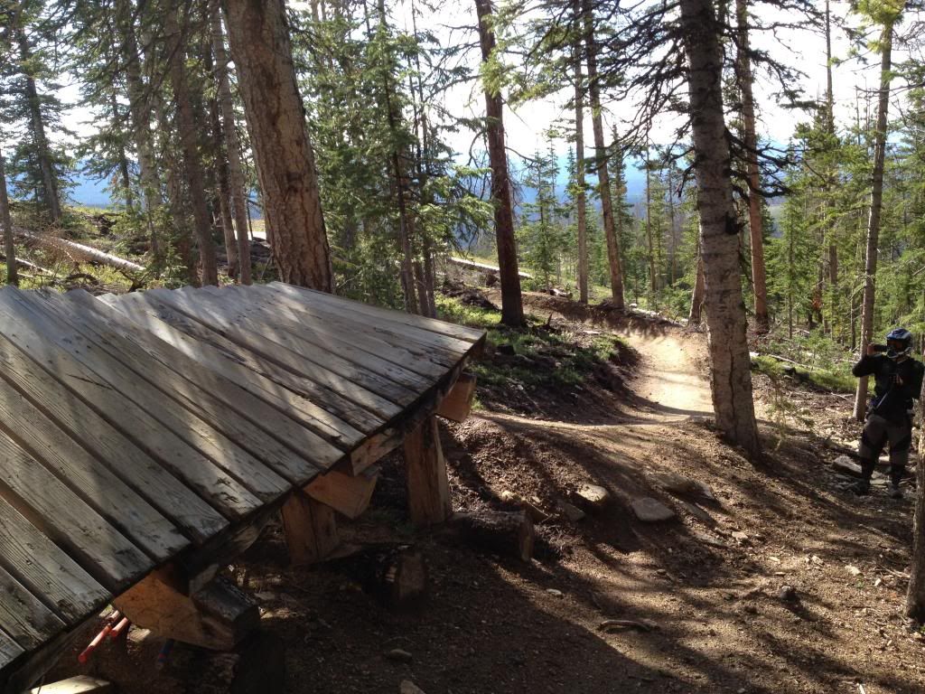

    Although, this is slightly off topic, I'd like to commend Winter Park Trestle Bike Park on the trail Cruel & Unusual, because they use what I think is a superior design, which is using upgradient turns to shave off speed, in order to prevent braking. Rather than all DH trails being down or flat (cross-gradient), use some up-gradient sections to shave off speed ! It truly creates a better pump and flow design.
    I know this isn't the greatest pic to illustrate . . . but after this drop on Cruel and Unusual, the trail turns left, upgradient, before turning right again (downgradient) and over another wood feature. definitely has the rollercoaster style of speed acceleration and conservation....
